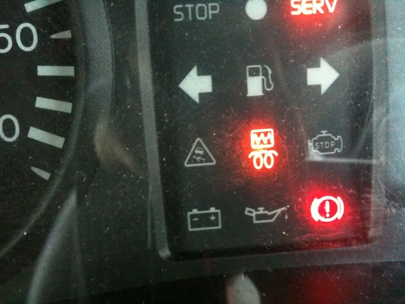

So basically I will be driving along, speedo working perfectly, then the needle just dies and goes to 0, the revs are working as well as petrol and temperature. Every time this happens a warning light comes on.
Haven't got a clue what's up with it :(
Help please :)
photo6w.webp This is the warning light under the petrol symbol :)
As said speedo sensor there about's £15 off eBay take's about 5 mins to change dead easy they just unplug and pull out look one up on eBay then you will know what it look's like
Same happened on my. Cleaned it with contact spray first. Worked fine for a week or 2. Got a new one for about a tenner. Not expensive and took 5 minutes to do.
