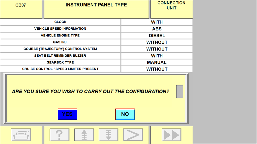

You do into connection unit, configurations and then change the speed setting to ABS. From memory the ignition needs to be off for this to work but I can't remember as haven't done it for a while. It gives you all the instructions as you're doing it.
Below example is from a diesel with slightly different clocks but it's the same principle :)
Below example is from a diesel with slightly different clocks but it's the same principle :smile:
I was in the right part but I didn't heave the ignition off. I've got it saying speed signal from the abs but the speedo still not working will I need to connect the wire from the speedo drive plug to the abs pump plug? If I go into the abs computer and check the wheel speed all 4 wheel are getting a reading just no speedo.
