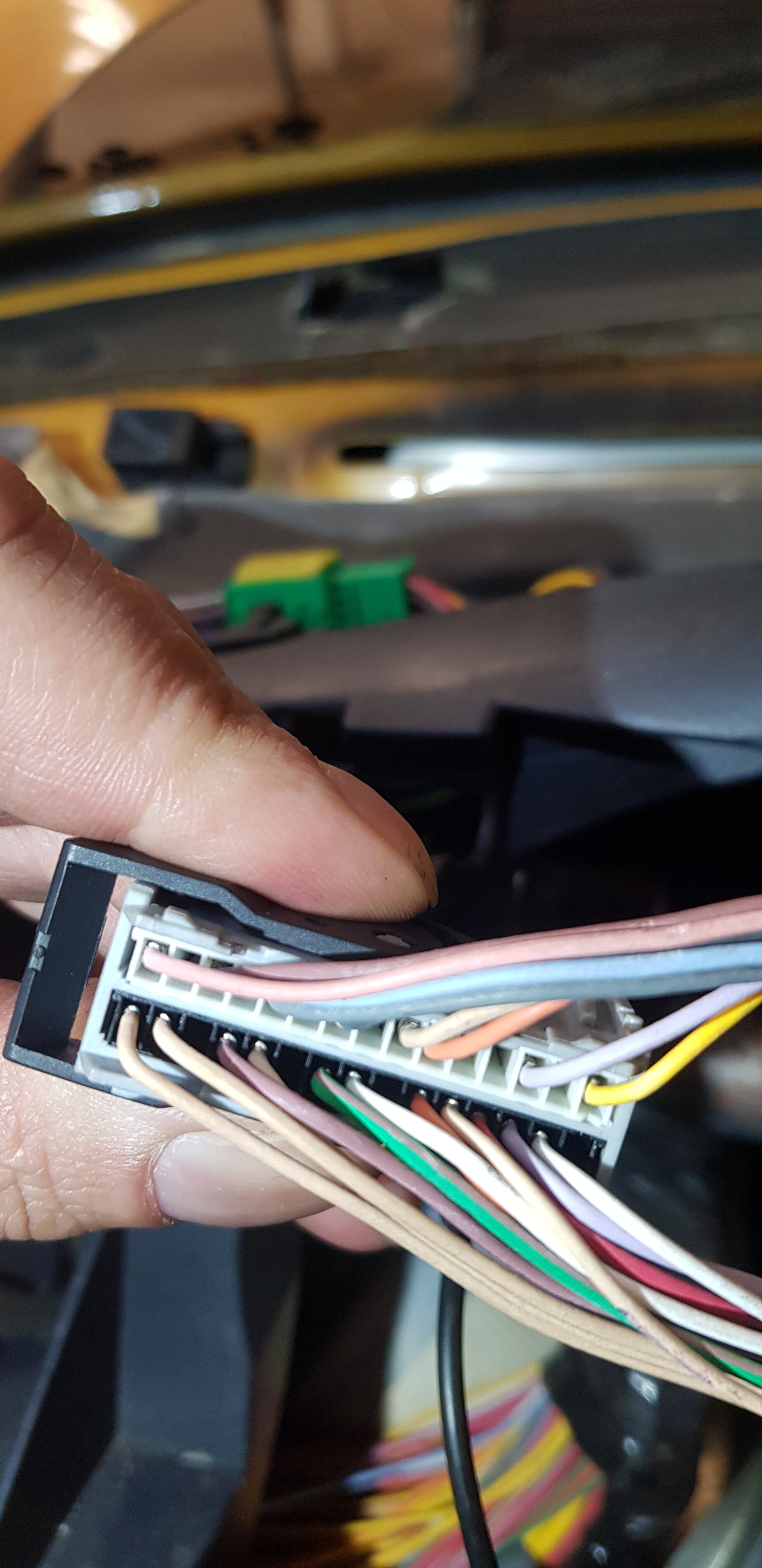

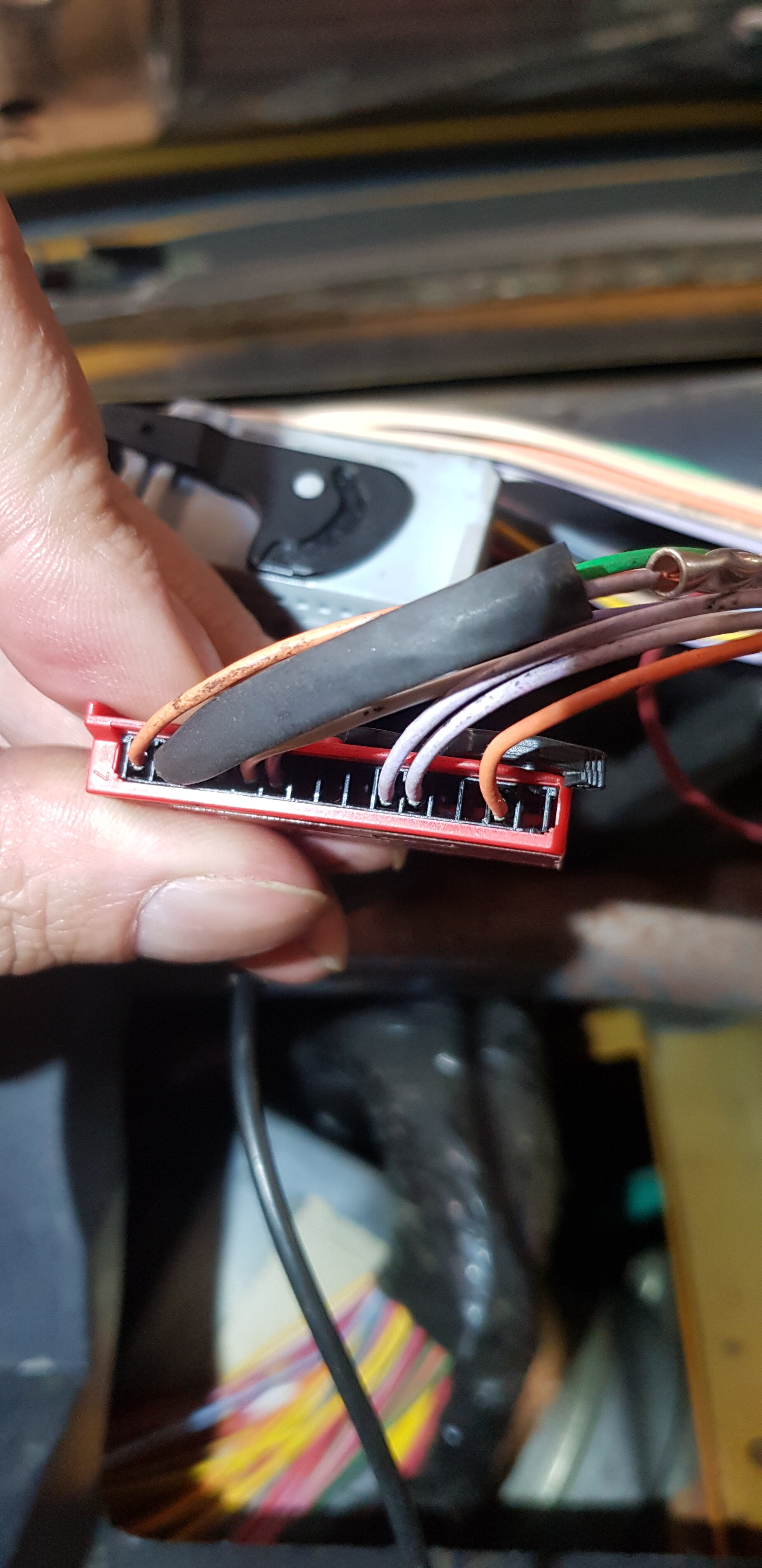

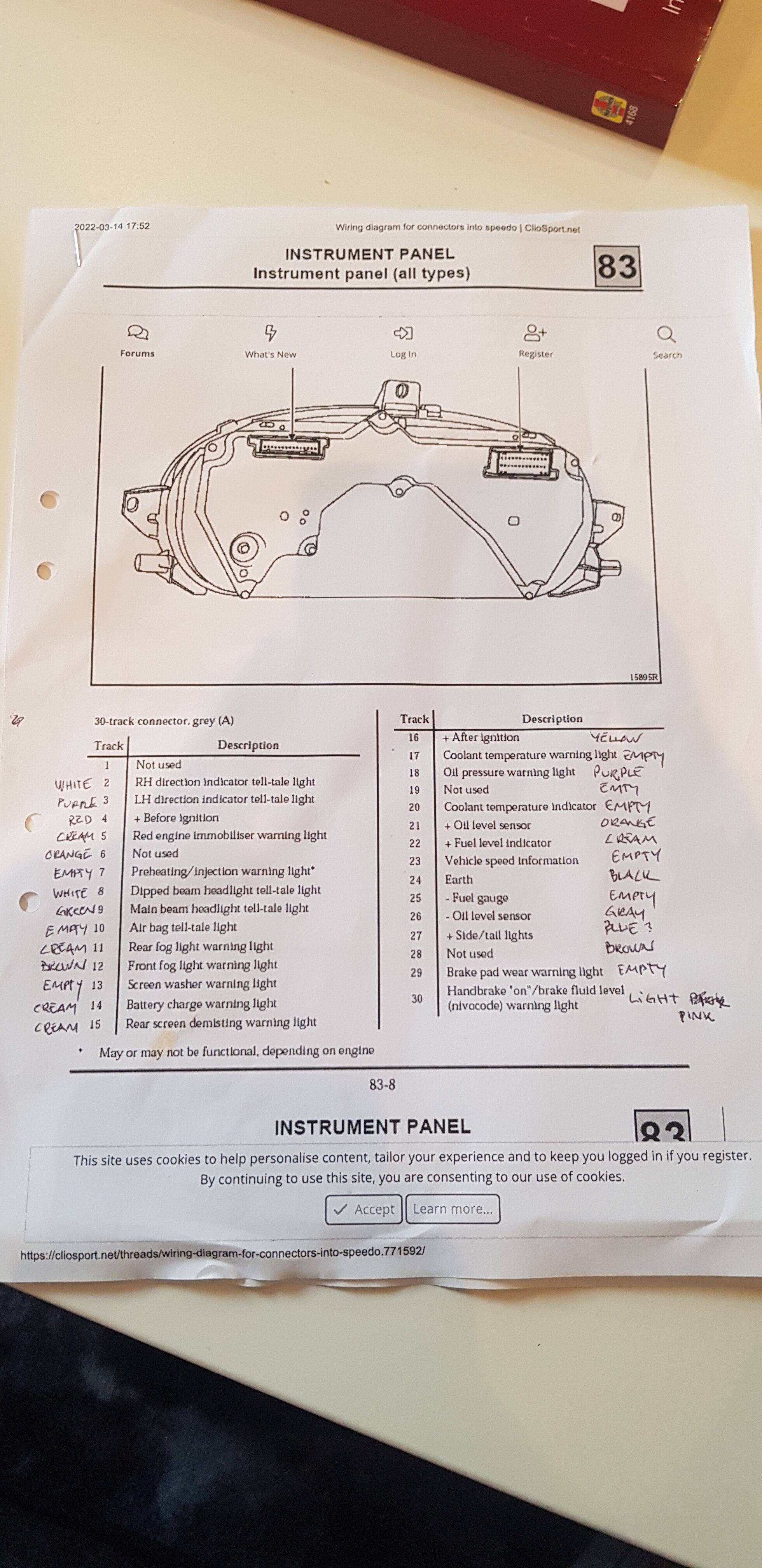

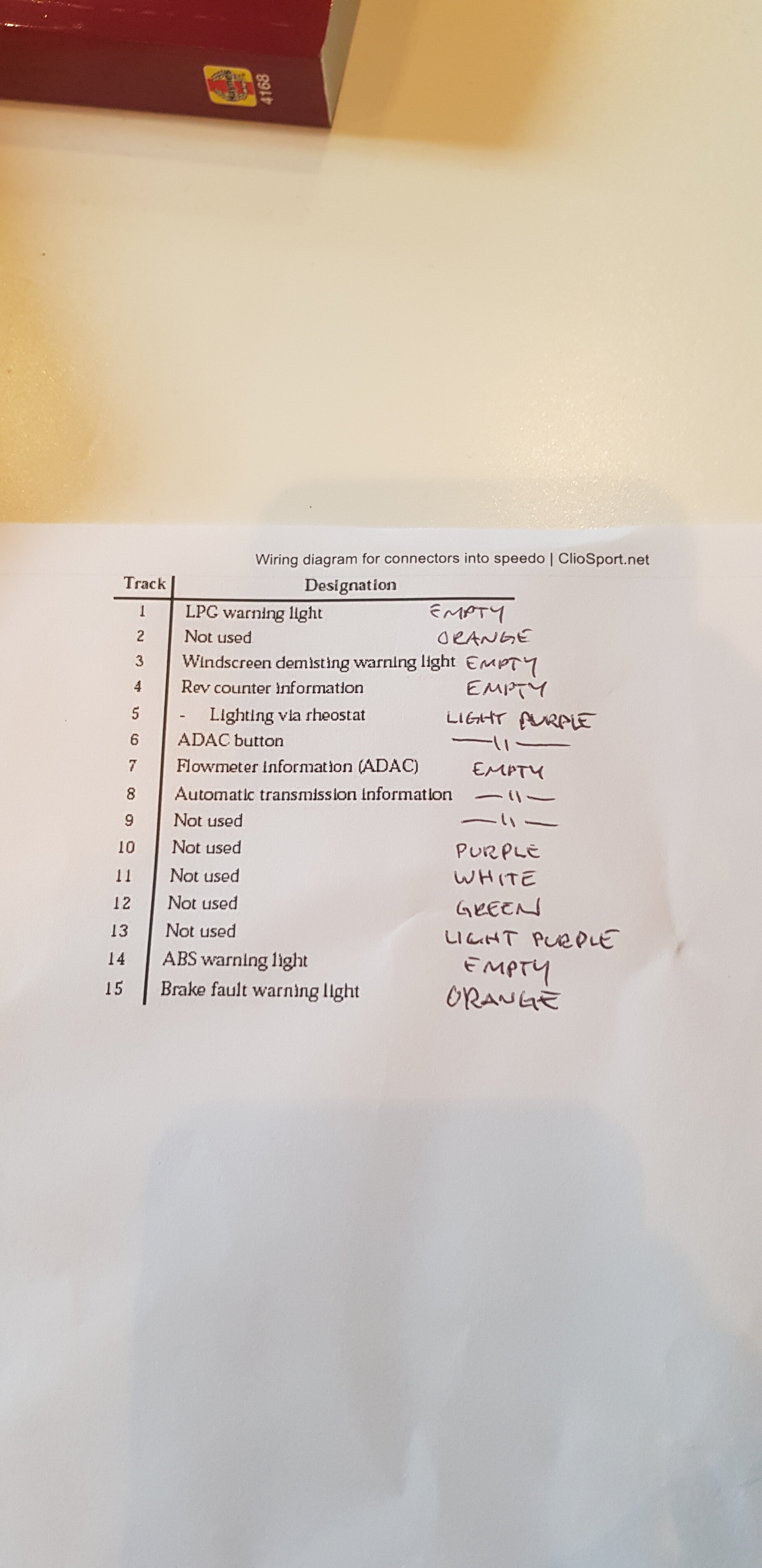

I have a problem, I'm trying to find out which cable there is who's giving the signal to the dashbord...when I'm looking at the wiring diagram, there's not much who is correct...I've been trying to locate the right wire with a multimeter, but no luck. Anyone who have any idea? The car is Clio -02; 1,6 lit
