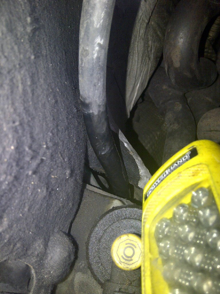

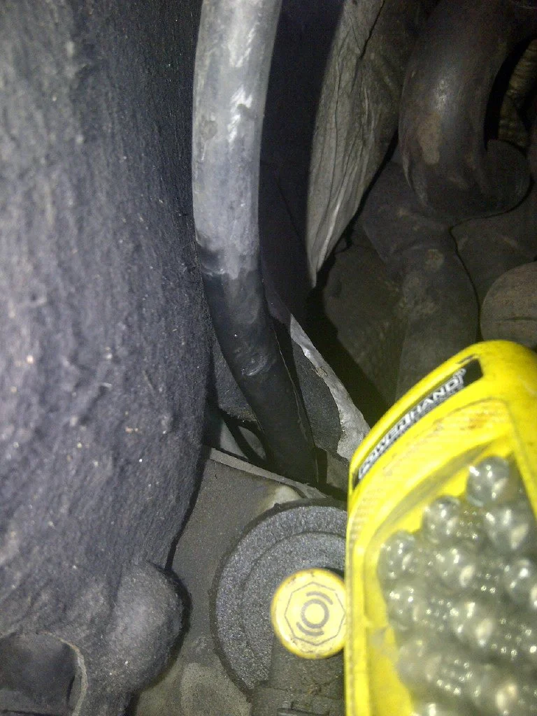

After a few minutes we had the engine cover off, and the AA chap noticed that the fuel line had been zip tied to the injector rail as the o-ring had snapped at some point. We then realised that the fuel line had been re-fitted at some point OVER the engine. This had cause it to stretch and rub on a heat shield behind the engine and had formed a little 'nick' in the line. The fuel line is clearly too short so something has happened during the life of the car which has caused someone to mess about with it.
