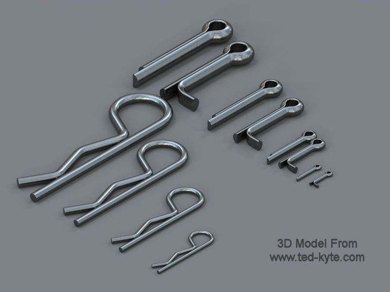

Oh and what's the cotter pin? Never heard of that before, everything else I understand.
^^ No need to do all that, undo pinch bolt and remove (bit of heat may help too), remove two bolts off wishbone holding balljoint on and remove it with the fork bish bash bosh 15mins tops if its not a stubbarn bugger like mine was lol
A cotter pin is the bolt that goes through the groved part of the ball-joint post and through the clamp in the hub.

So the pinch bolt is the cotter pin? Am I reading that correctly?
Yup. That's the part!
EDIT: It seems a cotter pin refers to a split pin! ("web definition: in mechanical engineering a pin or wedge passing through a hole to fix parts tightly together"). Maybe my terminology is off, but you kind of get what I mean...
It really is very easy to do. Just be aware of the pitfalls (in my previous post).
Once you've done one, the other side is a breeze! :)
Lol, well I'll be doing mine in the next week or so, so I will let you know how I get on ;)
A cotter pins, basically a pin which you split in two to hold a nut on! Not sure if theres one on the end of our driveshafts or on drum brakes havent taken a lot of notice TBH lol, Google it you'l see what one is :)
Know what they are now, used them loads just never knew their name! :o ha!

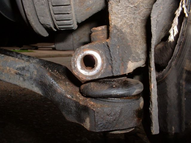

This pic helps too...
