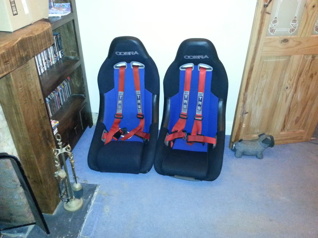

I was going to use a Cobra fixed back with harness but thought as its my main car it may be wiser to get some reclining recaro style seats.
What confuses the hell out of me is when you may have a cheap brand and how are you supposed to fit them?
Cobra seem a wise choice as they are all just bolt in. They come with sliders and all you need when you buy a Clio subframe.
Problem is I want something supportive and comfy but dont want to pay a big deal. Also seats where I can use the standard seatbelts would be ideal.

Don't bother with fixed seats if you just use the car for normal use.
I had cobra misanos in my old clio and they were really nice. They don't come cheap though. Could try cobra Daytona but they are over £300 each. Your best best would be to try and get a set second hand on ebay.
With all seats you need a specific subframe for the clio, and the seats mount on that.
