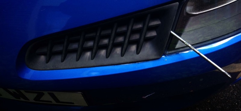

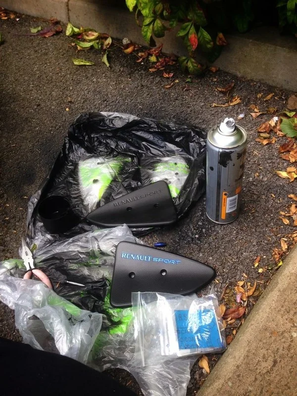

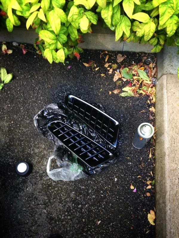

I did mine last year. Just took them out, cleaned them and have them a coat of halfords Matt black spray paint. Wanted the same texture to them that they have standard, just hated that they had faded. Did the job.
Before
During
After
This is what the matt paint dried to (only have a picture of it on my spoiler ends)
Don't lacquer them with normal lacquer as they will end up with a gloss finish.
Just give them a quick couple of coats of satin black, no need for the primer or lacquer.
