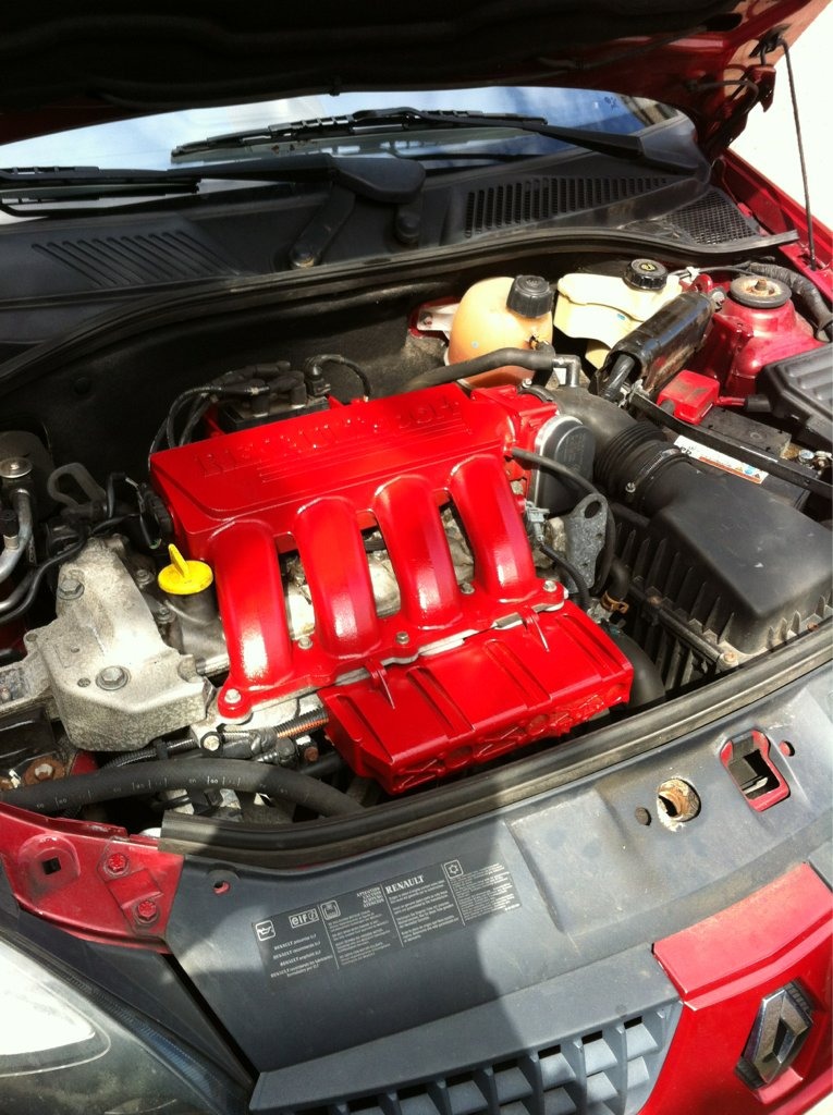

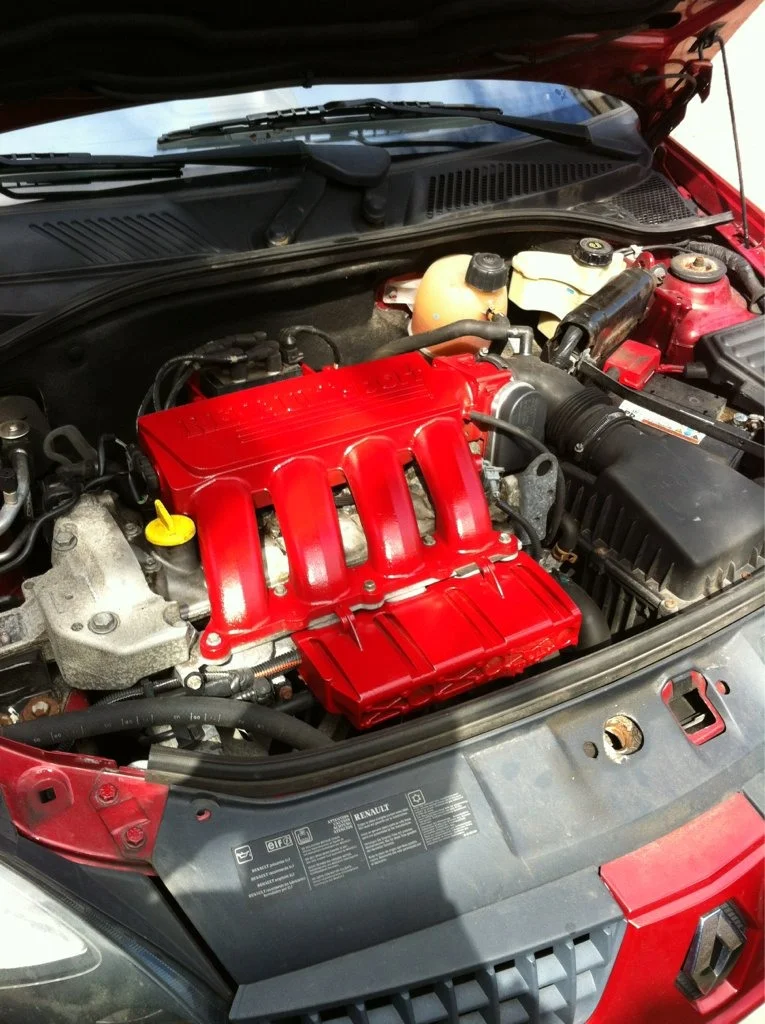

I use halfords rattle cans and it's been absolutely fine.. It's only the inlet and doesn't get all that hot... Mine has been done for two months now and bo bubbling or flaking. Plus you get a wider range of colours other than the high temp stuff.

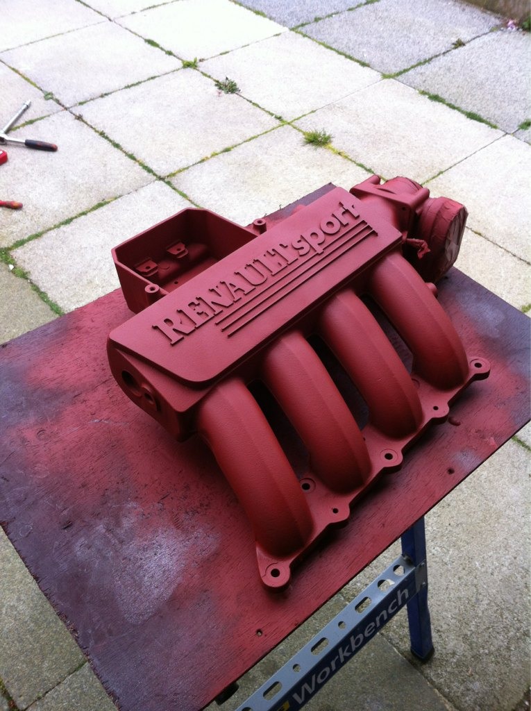

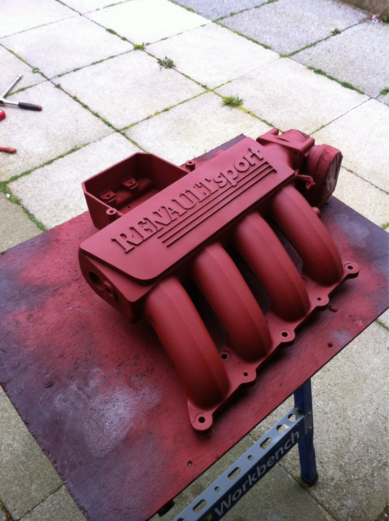

Gave it a good clean with engine degreaser then warm water. Left it to dry properly. 3 coats of primer, 3 coats of paint 2 coats of lacquer...

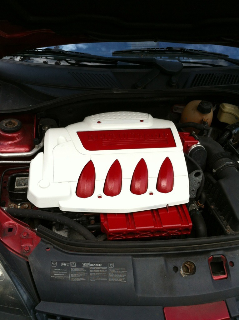

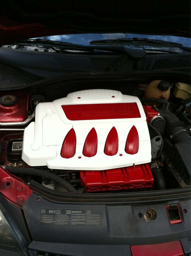

Then the plastic cover I wet sanded it all over to key the surface and then a few coats of plastic primer and candy white paint. Then I sanded it all again cos it had runs... 2 coats of paint but needs more cos I run out...
I used that stove paint in matte black. Quick once over with wet and dry to get some of the big chunks off and then just blasted it with that, then sanded down the lettering back to silver. If I can do it anyone can! Dries quick too this stove paint.
