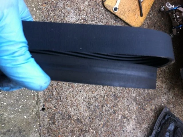

Had exact same problem with mine, I sorted it yesterday.
It is indeed the sound of a slipping aux belt, the reason being on mine was the tensioner pivoting bearing was siezed. Had to fit a new aux belt kit.
Rather annoying as I fitted a new aux belt kit back in late 2011, I'm wondering if I can send this back to Renault and get some money back as in my eyes it's a premature failure!
This is what it did to the belt (rubbing against tensioner spring) the new belt is against it for comparison
That sounds about right man, thanks for the advice. Will be taking it to a garage to sort out. Any idea of how much I should be paying a mechanic to fix this?
