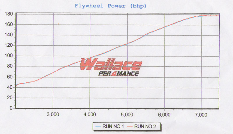

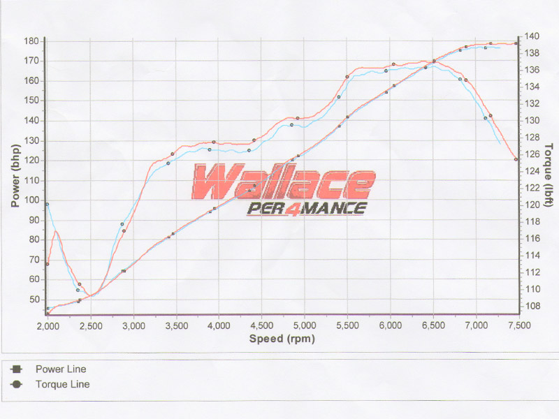

The Clio did it's name justice with a healthy result. That said the figures don't quite match Renault's claimed values in regards to RPM.
The car is standard but may have had a remap by the previous owner, as the rev limiter won't cut in till around 7800-8000rpm. It has covered 27k miles and was recently serviced with OE Renault parts. The car did suffer from a rather substantial hole in the CAT earlier this year, this was fixed but I'm not convinced the exhaust is 100% sealed where the CAT/middle silencer meet. This may explain the discrepancies in RPM vs. power/torque? It's never quite felt as beefy (thinner might be a better term) as it did before the exhaust troubles.

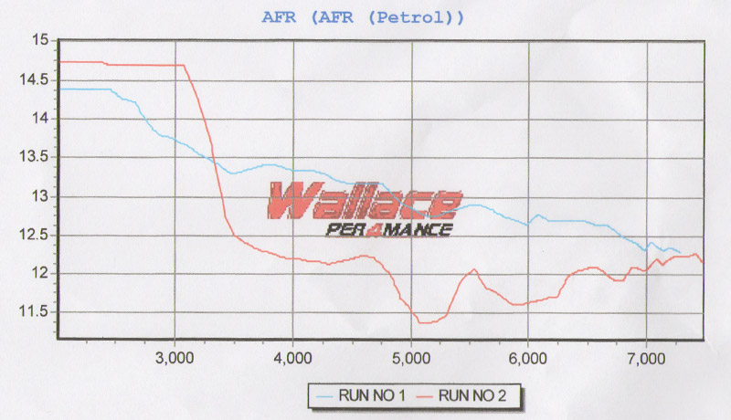

The AFR graph shows that the car is running a little too rich and there is scope for more power if the map was leaned off. The last two tanks of fuel I had run were ASDA 95RON due to being too far from a Shell station, the car was run on V Power today but without time for the ECU to recognise the change I doubt it made much difference.

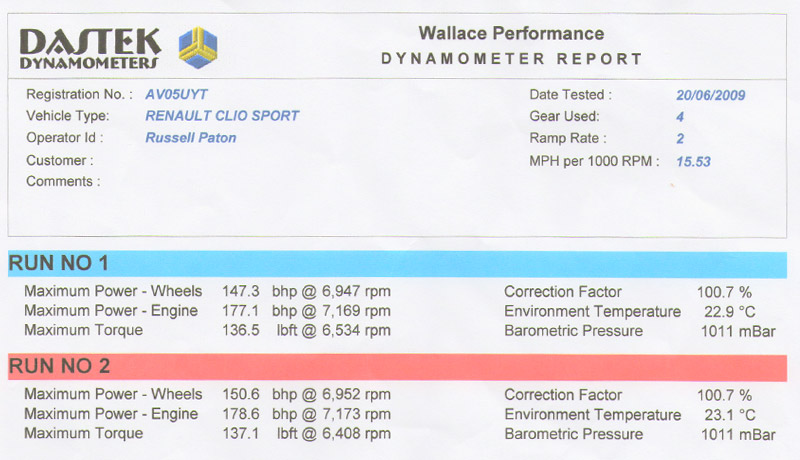

Manufactures Figures:
Power: 182PS (179 bhp) @ 6500rpm
Max torque: 148lb ft @ 5250rpm
Rolling Road Figures:
Power (wheels): 150.6 bhp @ 6952rpm
Power (engine): 178.6 bhp @ 7173rpm (+673rpm)

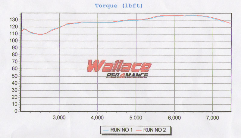

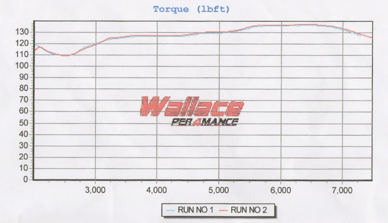

Torque: 137.1 lbft / 185.8 Nm @ 6408rpm (+1158rpm)

Yeah a lot of the guys commented on how nice the power graph was, always thought the car had a very nice linear delivery and the graph backs this up. Where did your car make peak power/torque?
