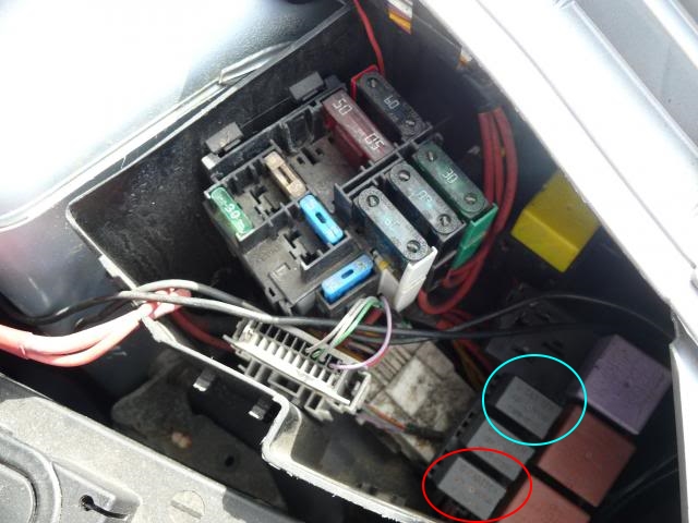

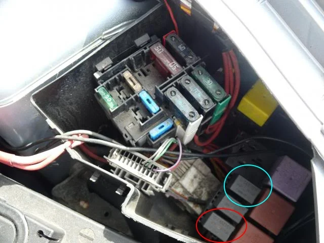

Mine turned out to be the relay next to the engine fuse.
The starter relay on mine was the one i've circled in red.
The relay circled in blue is the engine fan(it was on mine). Try swapping these two over and see if your problem goes away(you'll be ok without the fan for a day or two at this time of year).
If it does, you'll need a 20/10 12v relay.
Nb, also check the connections from the loom to the starter motor, as I also had starting issues with a dry joint here!

I've tried switching the three identical relays around, as suggested, but the start-up issues persist. Still hasn't actually failed to start but just takes ages and ages to spring into life and settle to idles....worse when warm.

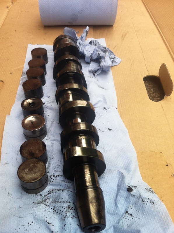

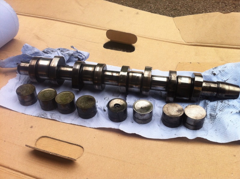

That was a 2006 VW Passat B6 1.9 TDi (PD). It had a very odd but common problem. Basically it idled ok, but as soon as you touched the accelerator it misfired constantly, getting worse and more agressive under load to the point that it shook the car. It also threw out a lot of black smoke upon touching the accelerator.
It only had one fault code; it said the MAF reading was too low. All of the forms told me to change the MAF sensor but that just did not sit right with me for it to misfire as badly as it did. Plus disconnecting the MAF made little difference to the running ; it still misfired horrifically. Diesels also not really need MAFs as much as petrols ; they are more of an emissions tool. Previous garages thought that the injectors or wiring loom was iffy going to the injectors. The PD injectors going in the 1.9 is not all that well known but the wiring loom has been known to die. When a specialist put VCDS onto the car he check the MAF reading and injector stabilisation values. He then concluded that I either had 3 shot injectors or more likely a knackered camshaft. It was the latter.
To this day I have not seen a camshaft in one piece worn quite as badly. Without resetting the ECU the car intitially smoked but it was already running spot on. Down the road the smoking went completely and the EML light also went off.
That is why I said to get some proper data via someone who knows what they are doing about the car. Many 'good' mechanics misdiagnosed the car.
