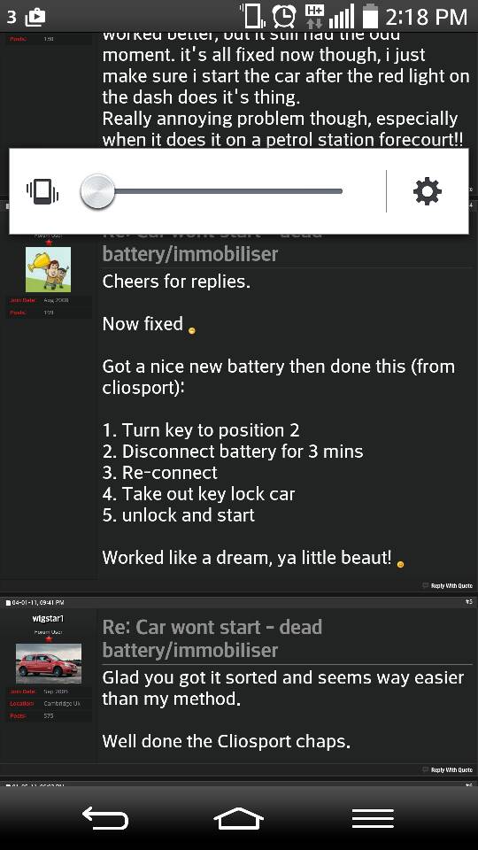

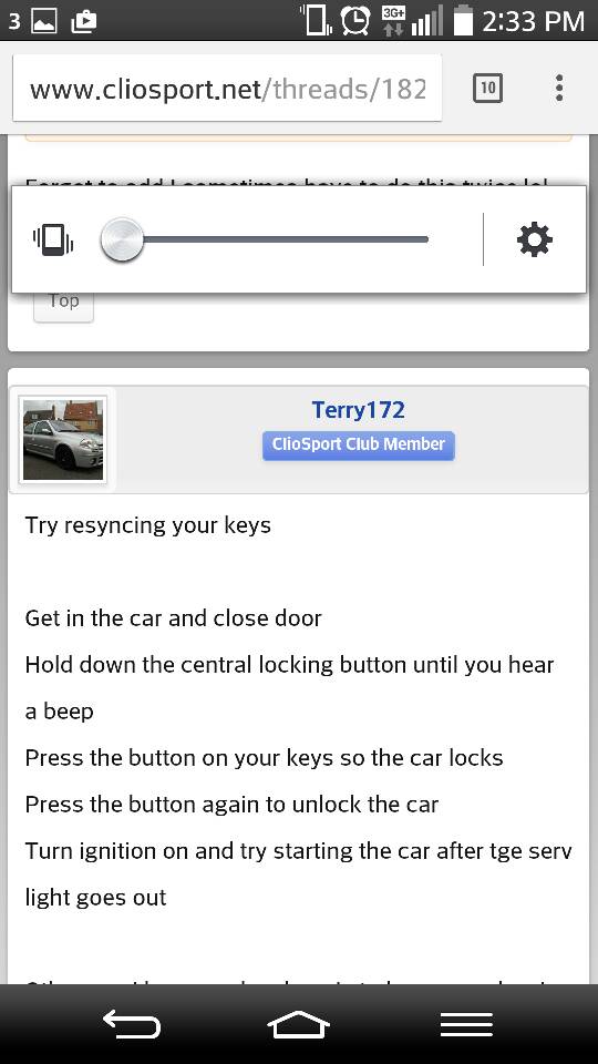

After work her and her boss tried to get it going, I sent these 2 things for her to try....
Neither worked, I also believe she tried the spare key.
