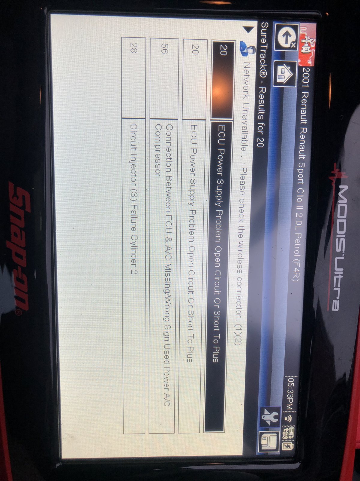

Got round to scanning it!
Here are the codes..

I’ve just had the sigma alarm taken off, it had started today after 2-3 months of not starting.
The red light goes to solid but just spins over has anyone had this issue!
Could it be down to the key?
Am going to try and have a new key programmed to the car again, tried before the alarm got taken off thought that this was the problem!
