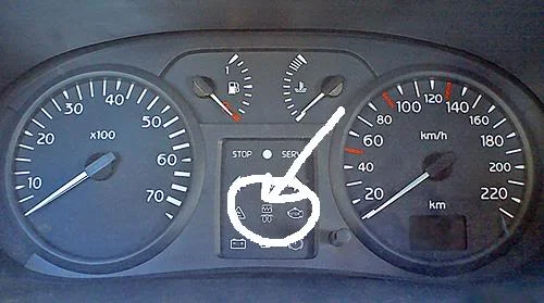

Ok doesnt sound good then, also forgot to mention this light has started coming on a bit too, could it be related?. See pic below, not my dash but pointing to the same light.

Does the engine management light come on when you first switch the ignition on? Its the one to the right of the light you have indicated. It should come on for few seconds then go out to indicate it has done a system check before starting the engine.
i think it comes on from memory and shortly goes out. still seems a total mystery but for the moment it starts.
