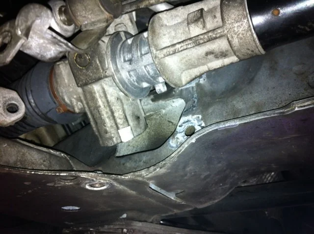

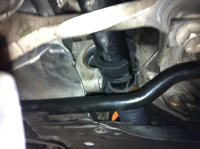

Quick update, I done my rack bushes yesterday....the car is back to handling like it should. On closer inspection, the rack had been moving about 5mm side to side judging by the marks on the rack.

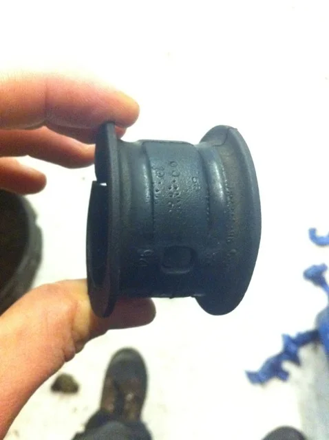

Martin, dont suppose you got any pics of the marks etc and old bushes condition?

Here's pics of mine if it helps anyone
ImageUploadedByTapatalk1360193932.537260.jpgImageUploadedByTapatalk1360193956.287174.jpgImageUploadedByTapatalk1360193979.851631.jpg
Above pic is one of the old bushes I removed before fitting new ones
