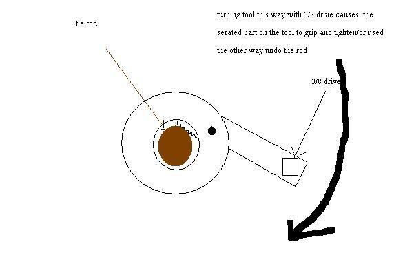

depends how seized they are, i've done loads but i bought a specialist tool the grips it you use with a long extension,, to be honest i wouldnt even bother attempting one without the tool
looks a bit like this, tools at work at the mo.
its made by facom though its a peugeot workshop tool.

ditz, does your tool grip the bar, or the ball joint housing on the end of the tie bar. (i don't mean track rod ends)
