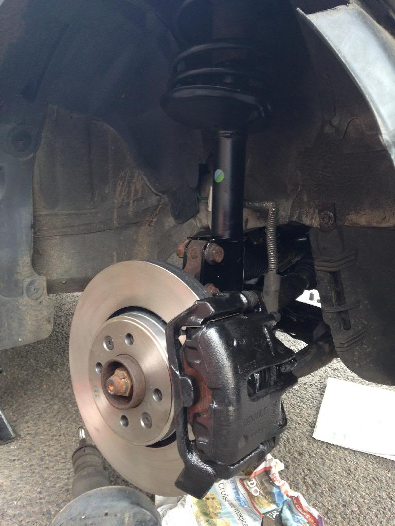

During the week I quickly too the front calipers off. Sliders are totally free. Exercised the piston in and out a few times and didn't have any difficulty doing that. This however has made no difference to the problem.

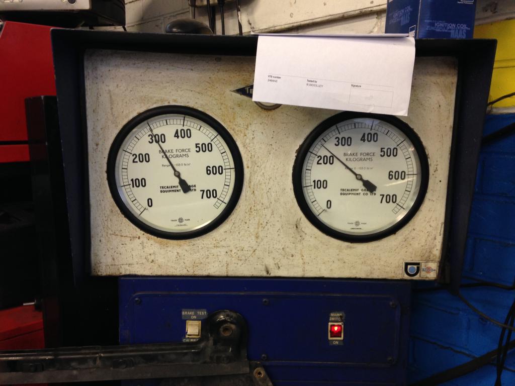

This is what the brake machine is showing after the clean up and this ties up with the problem. Rears are absolutely fine, showing around 100 both sides if I remember correctly.
Hi Graham,correct me if I`m wrong,but isn`t the right hand guage for the right hand wheel.If so the less efficient right hand brake will make the car pull to the left,and you are moving the steering wheel to the right to keep it in a straight line?

Yeah sorry Steve, let me explain a little better. The car pulls to the left if you forceably keep the steering wheel in the same place. If you lightly hold it the pull is severe and causes the wheel to turn clockwise which keeps the car in roughly a straight line, when I let off the brakes it immediately goes back to where it was before and the car then lurches right while the steering wheel corrects back. Besides that this is what I replaced when doing the front of the car.

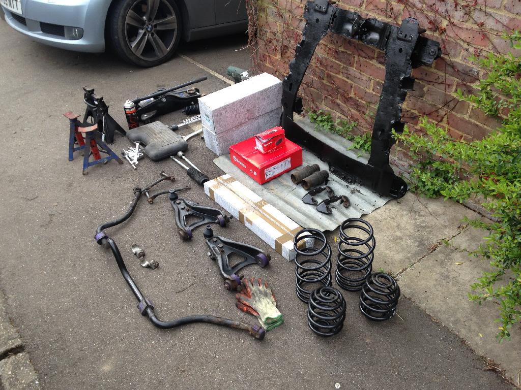

Shocks, inner and outer track rods, lower ball joints, brembo discs and pads.
Refurbished calipers using bigredd seal kit.
Front end has inner and outer arb powerflex bushes along with powerflex wishbone bushes
Rear lines are braided but the front lines are the original rubber hoses.
All bolts are still how they should be and there is no sign of parts moving which shouldn't.

Hi Graham,that`s a pretty comprehensive list.The only ommission is the springs,which look pretty good in the pic.A weak right will give a bit of neg camber under braking,increasing the toe in slightly,and add to the LH pull slightly,but your problem is way above this.

We know the RHF braking does not match the left,I`ve not encountered a collapsed flexi brake hose,bulging and burst ones yes,so I await the outcome of it`s replacement.

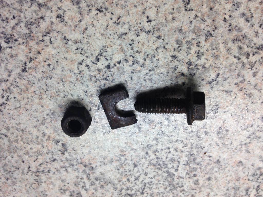

I got fed up with the problem in the end, popped it in the garage (which I have never done) and due to the joy of having a ramp and being able to look from underneath they found the O/S arb bracket was missing.
I've fitted the new one this morning and the car now brakes exactly as it should. The movement in the wishbone must have been causing the different readings on the brake machine and moving the hub enough to cause the steering problems.
A big thanks to @STEVE.M for all the advice he's given and @Kelv for sorting me for the part so quickly.
And here's the remanence of the old one, it had snapped clean off.
