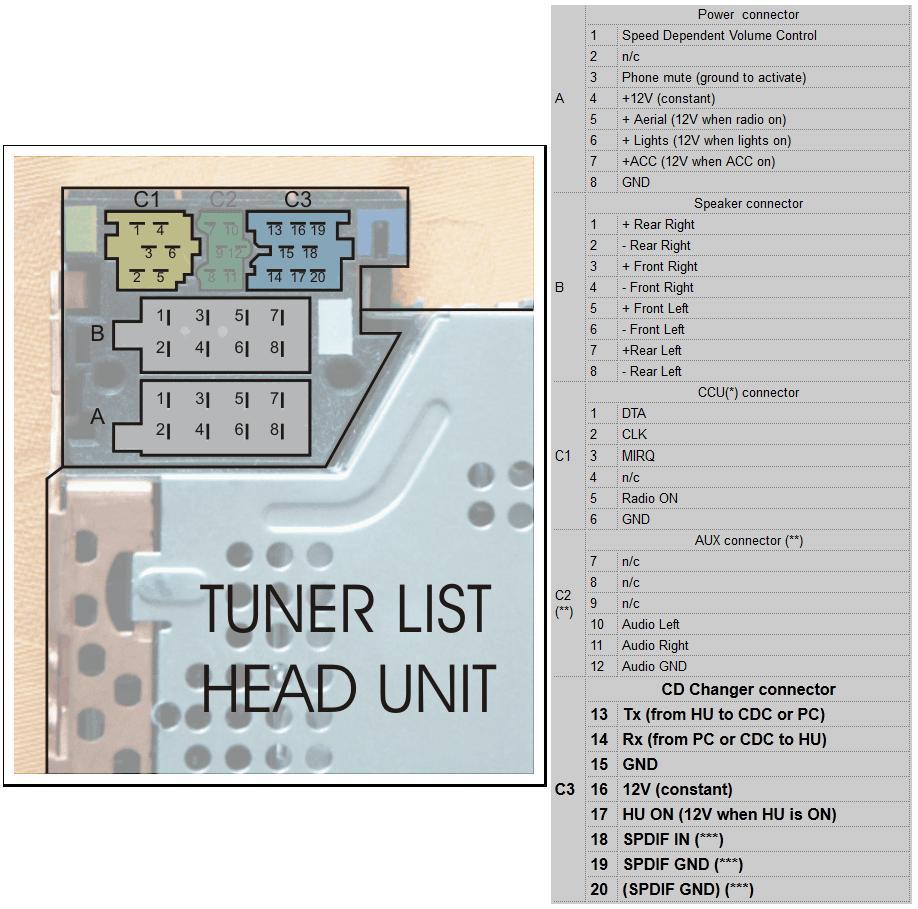

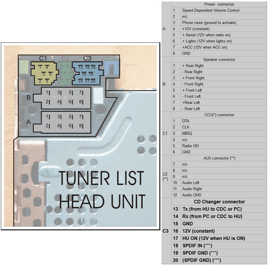

yer im seeing what your saying but cant see anything on that list about steering wheel control just cant undrstand where this plug has come from it seems to go to the steering wheel controls.
CCU(*) Connector (C1 on the diagram) = Central Communication Unit. This is the way the HU receives stalk control commands and sends information to the dash display.
no..i think your misunderstanding. That plug that you have left over is not factory standard. If your returning it back to factory then i suggest you trace the connector back and try to remove it.
