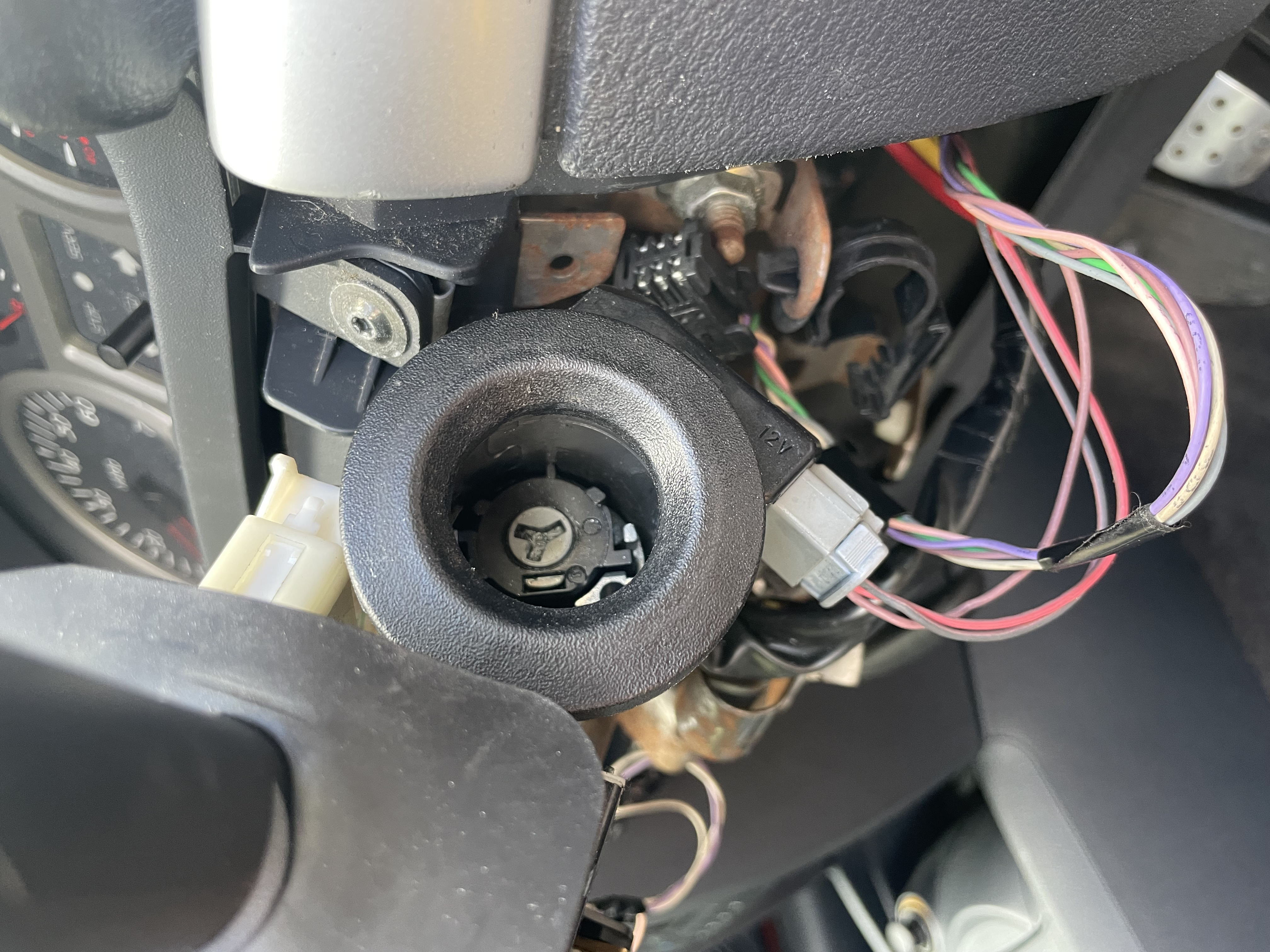

Hi mate, ye I think you're right. The bit I'm battling with at the moment is the barrel is knackered and I can't get the key to get to position 1. Everything I'm reading says you need to be in position 1 or two to get to the release switches.
  C63 PPP Estate
So I ground off those two pins with a Dremel and deburring bit, which was enough to get the barrel lock out. I've unscrewed the barrel from the rear piece of the ignition lock assembly and can now start the car by turning the little Y shaped plastic piece - which backs onto the lock - with the end of the key. Once it's started, it doesn't seem to need the key near the immobiliser ring, so for now, I'm up and mobile until the second hand lock set arrives. I'm assuming the key insert for the passenger airbag doesn't actually need a lock? Cheers all, you gave me just enough info to give it a go.
