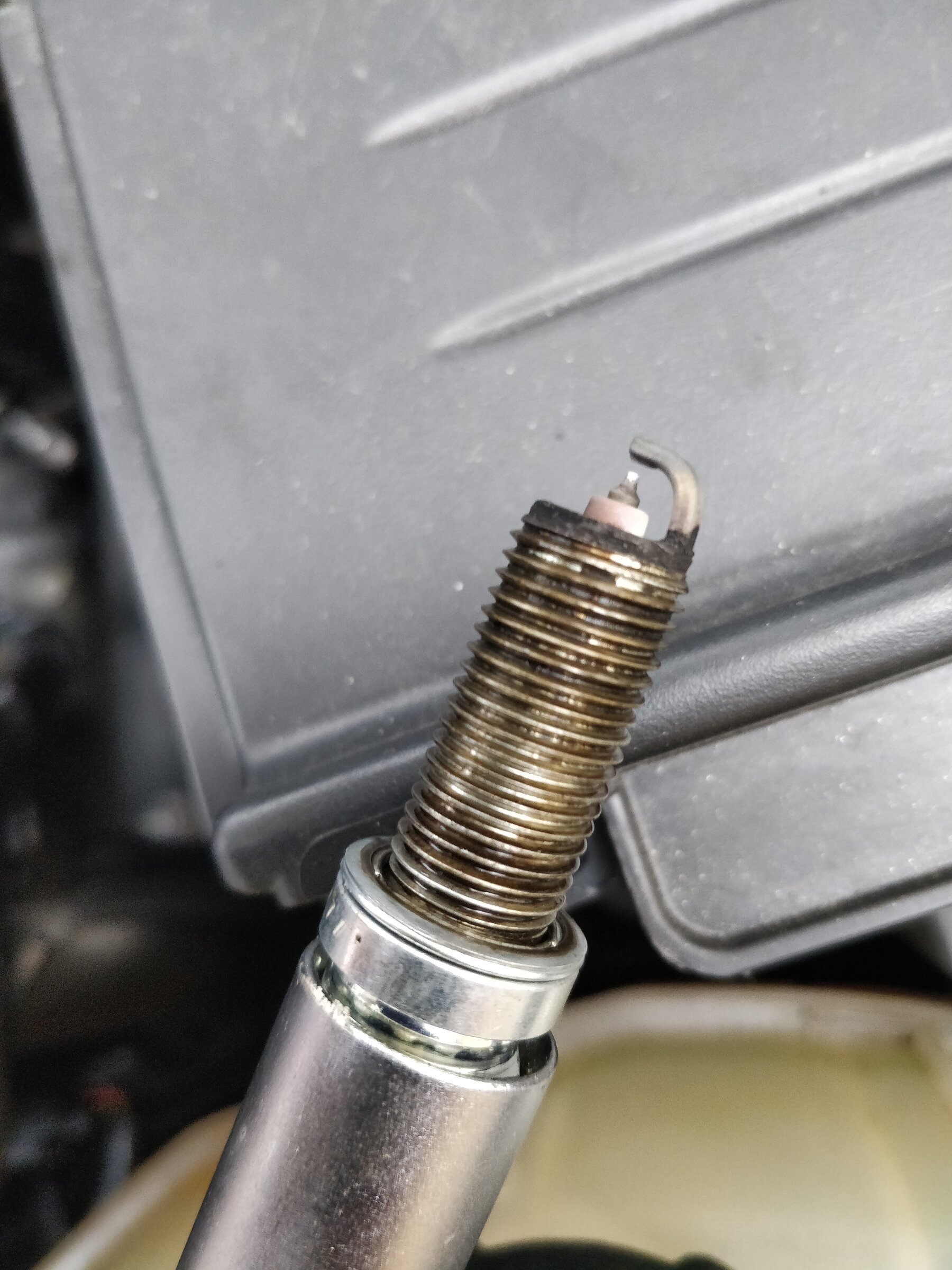

2007 Clio 1.2tce D4f 784
I bought it Stuttering and with hesitation, mostly when cold.
Cleaned trottle body twice, map sensors

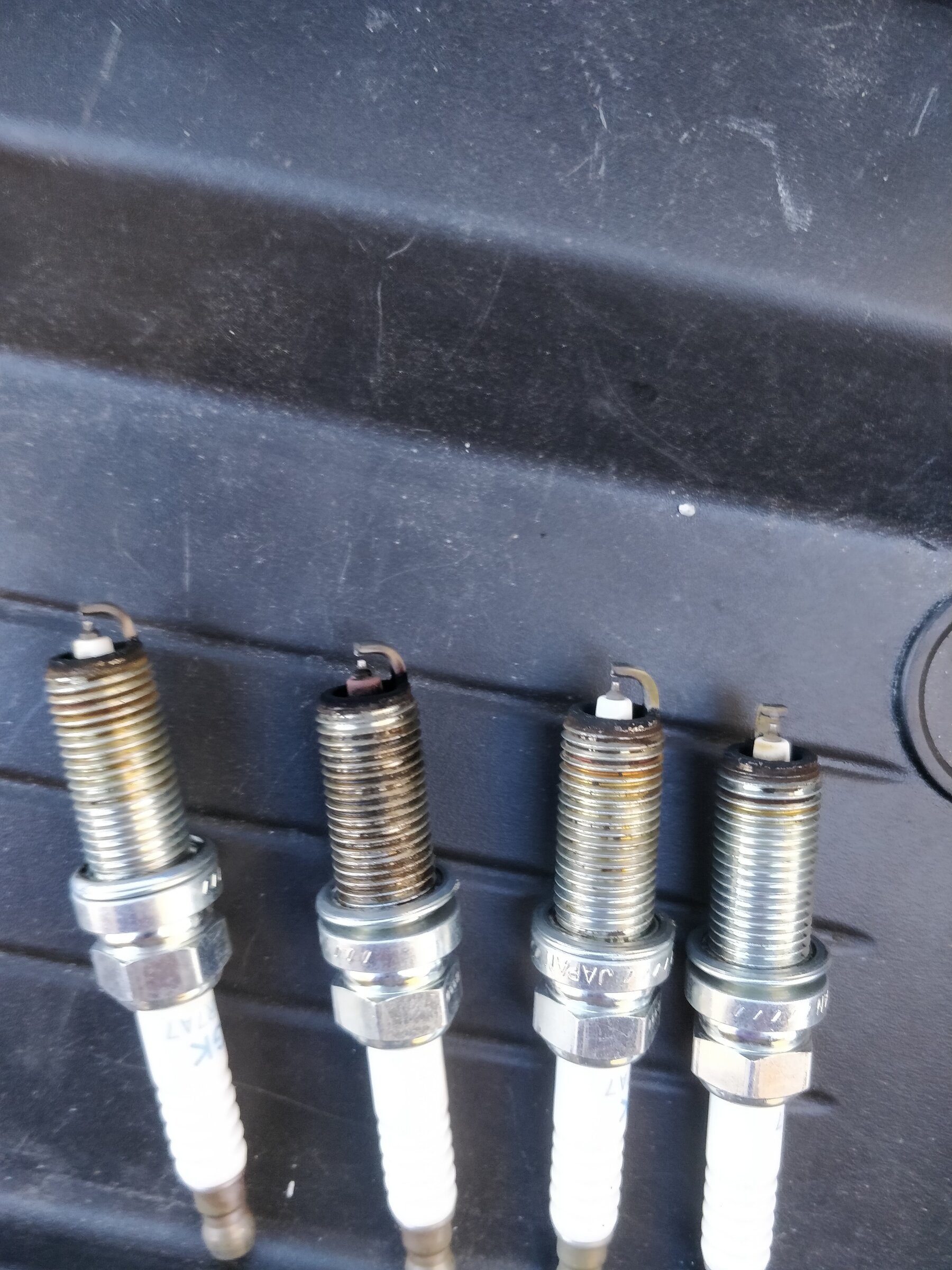

Replaced crank sensor, plugs, leads, coils
Got better.

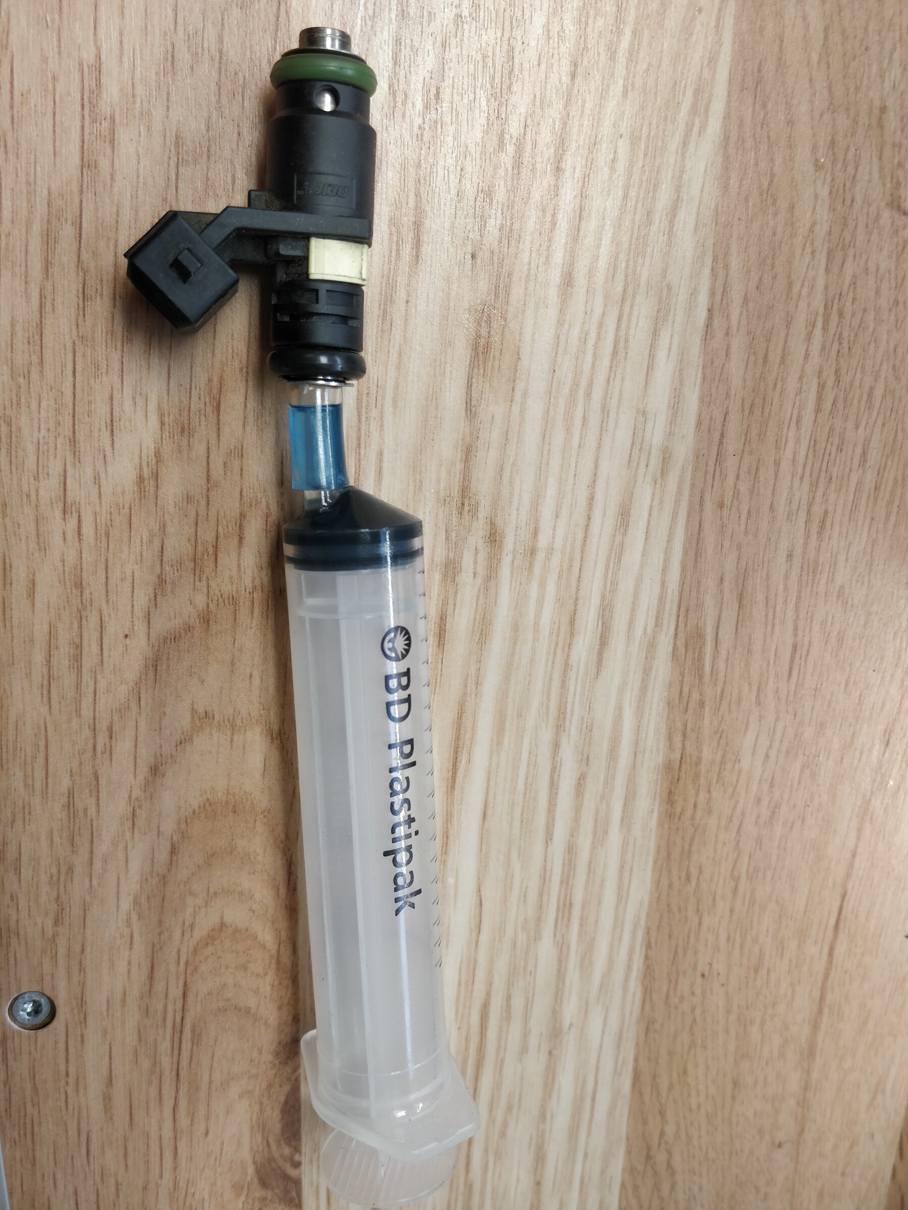

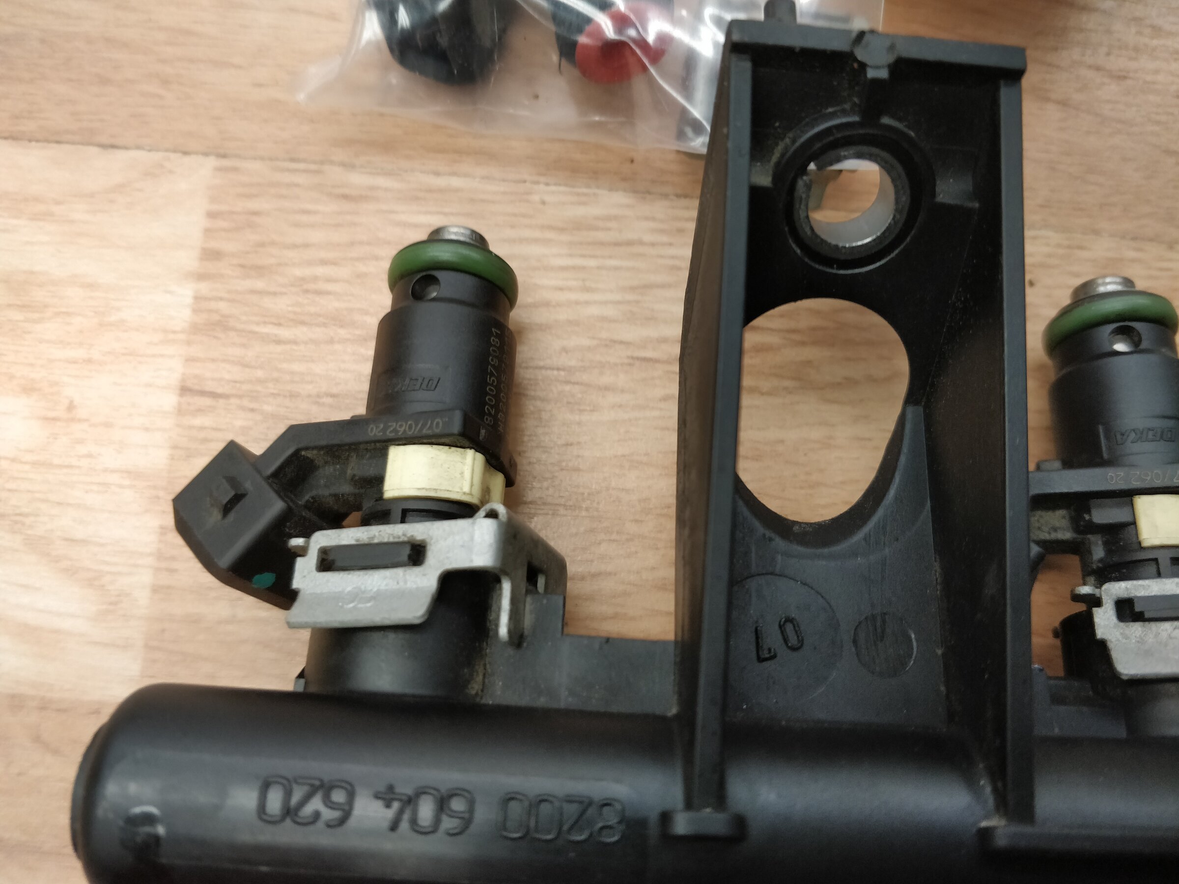

Replaced inlet air temp sensor and coolant temp sensor. The later dropped the engine temp from 4 to 2 bars. Checked the injector coils. Checked every connector and hose under the bonnet.
I have the Renault Can Clip. The only error it register is df060 airbag /seat belt tensioner.
The car runs much better now. But I still have a intermittent stutter/hesitation in the rev range of 2000-3000rpm. Idle is good.
Running out of ideas, please help.
