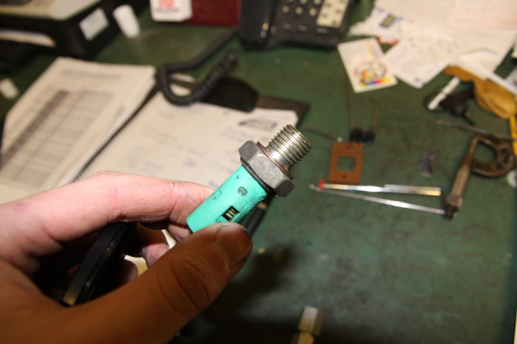

Oil pressure switch looks like...
Can be found where Da said :)
Ive got the part number/price somewhere, 2 mins.
Oil Pressure Sensor - 8200671286 - £15.28+VAT
Copper washer if you want a new one - 7703062043 - £0.43+VAT
