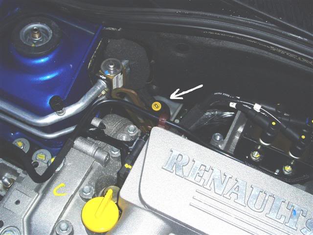

Like Gareth says . Worn brake pads causes your brake fluid to drop bringing on the brake and stop light . Check your pads if there is still plenty left on them top up your brake fluid reservoir . Here's a pic of where to find the brake fluid res . Take care not to spill any if you do top it up , i use a small funnel and a few old rags round the top of the reservoir .You should see a max level on top of the brake fluid res , just top it up to under the cap .
If you lean right over and look into the top of the res you should be able to see the fluid , if you can't just top it up til you can .
If you've got an engine cover on you'll need to remove it to gain access to the reservoir .
