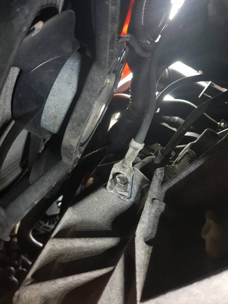

I've cleaned off the earth points and the voltage showing at the alternator and also at the battery has gone up from 13.2 to 14.3volts so we may be on the right track. The gearbox one was a bit snotty but the rest seemed ok
