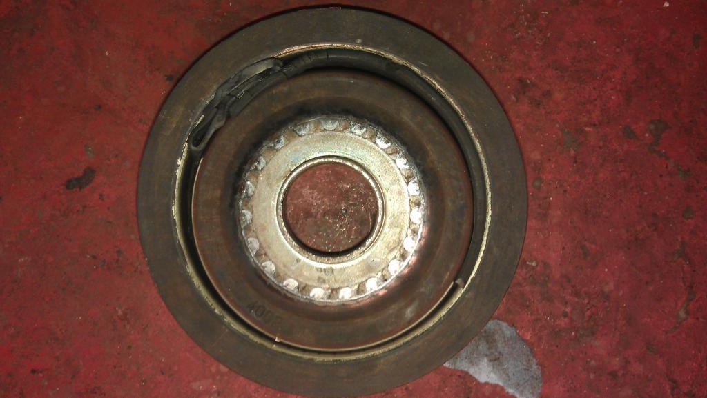

If its affected by moving the steering,and the car is not using coolant,then it could be you need an auxilary belt kit complete with tensioner and pulleys.
TBO,if you need a dephaser,you should replace the cambelt kit as well,and may as well go the whole hog and change the water pump at the same time.
What`s the mileage and belt history?.Auxilary every 36k,cambelt every 72k or 5 years.
I listened to vids,doesn`t sound too healthy,I`d stop using it till it`s sorted.Rattle seems to carry on after it`s stopped firing,so could be dephaser.
Where are you located ,so someone can recommend a specialist.?
Phones seem to record noises strangely,so give the engine a good shake,in case the mounts are gone.

At least get Eurocars to look at the aux belt tensioner now,they can be unsiezed.
If the aux belt fails,it will likely take out the cambelt and bend valves.You won`t be driving it to work if that happens.
At least they are Renault dealers,and will have the correct tools.
