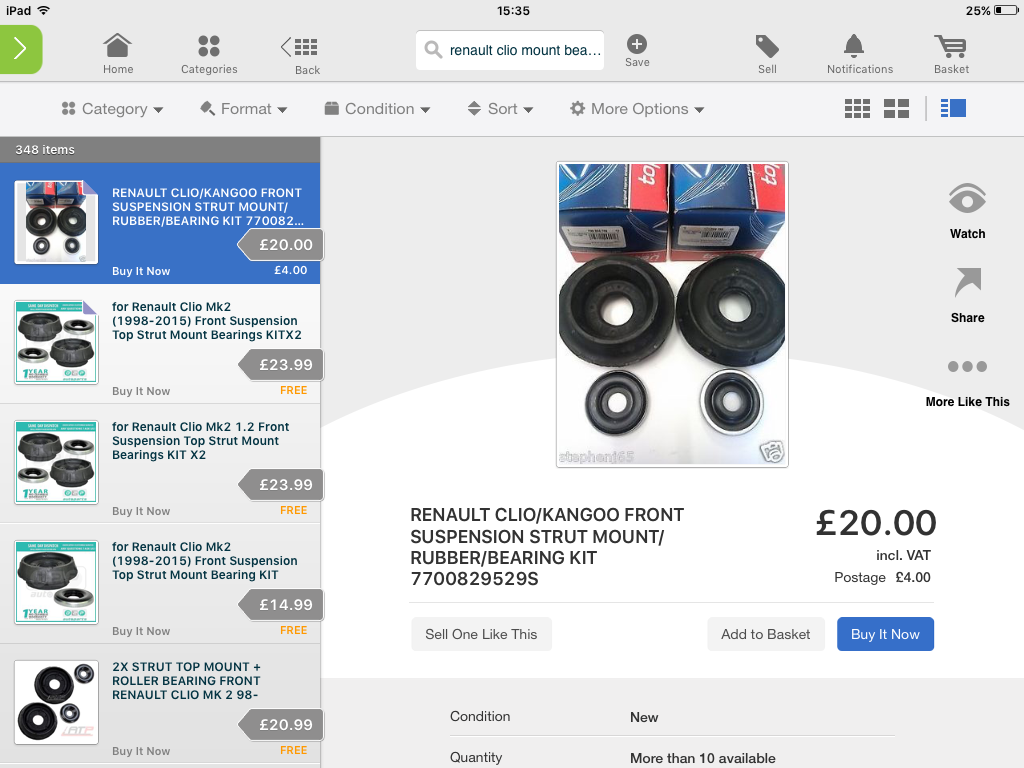

Cheers mossyv6 do I need to take the whole strut off or just the nut on top I'm picking some new top mounts from euro tomorrow £3 each I've just been out to it and the whole strut top is aping in my hand and the passenger one it solid so I think it's vibrated loose (hopefully) nothing else
To fit these spacers you need to take the top nut off and remove black top hat and place spacer underneath.
Top mounts for £3 doesn't sound right buddy. They are £20 to £30. The mount is rubber and comes with a bearing. You have to remove the strut and sits on top before the bodywork before top hat.
