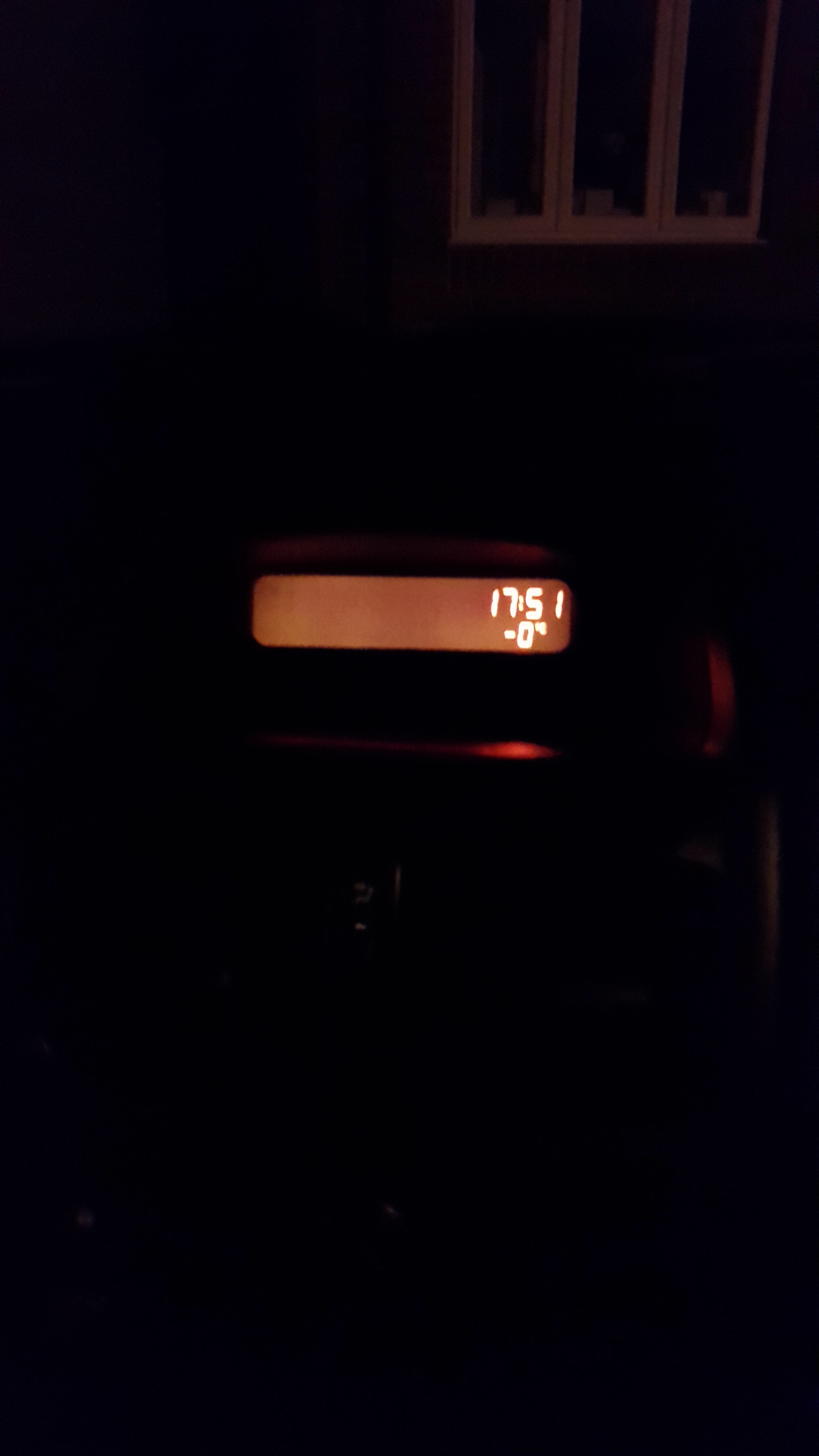

Raising this thread from the dead! I've since fitted the original stereo back in, with the fuse again interior lights work correctly, clock functions correctly but the stereo stays on. I can turn it off with a press of a button, is there any fuses I can check that maybe hidden away? Did a bit of googling and there's one under the ashtray? Is this true?
Also when I turn the car off the display stays lit up like so... is this normal or not?
