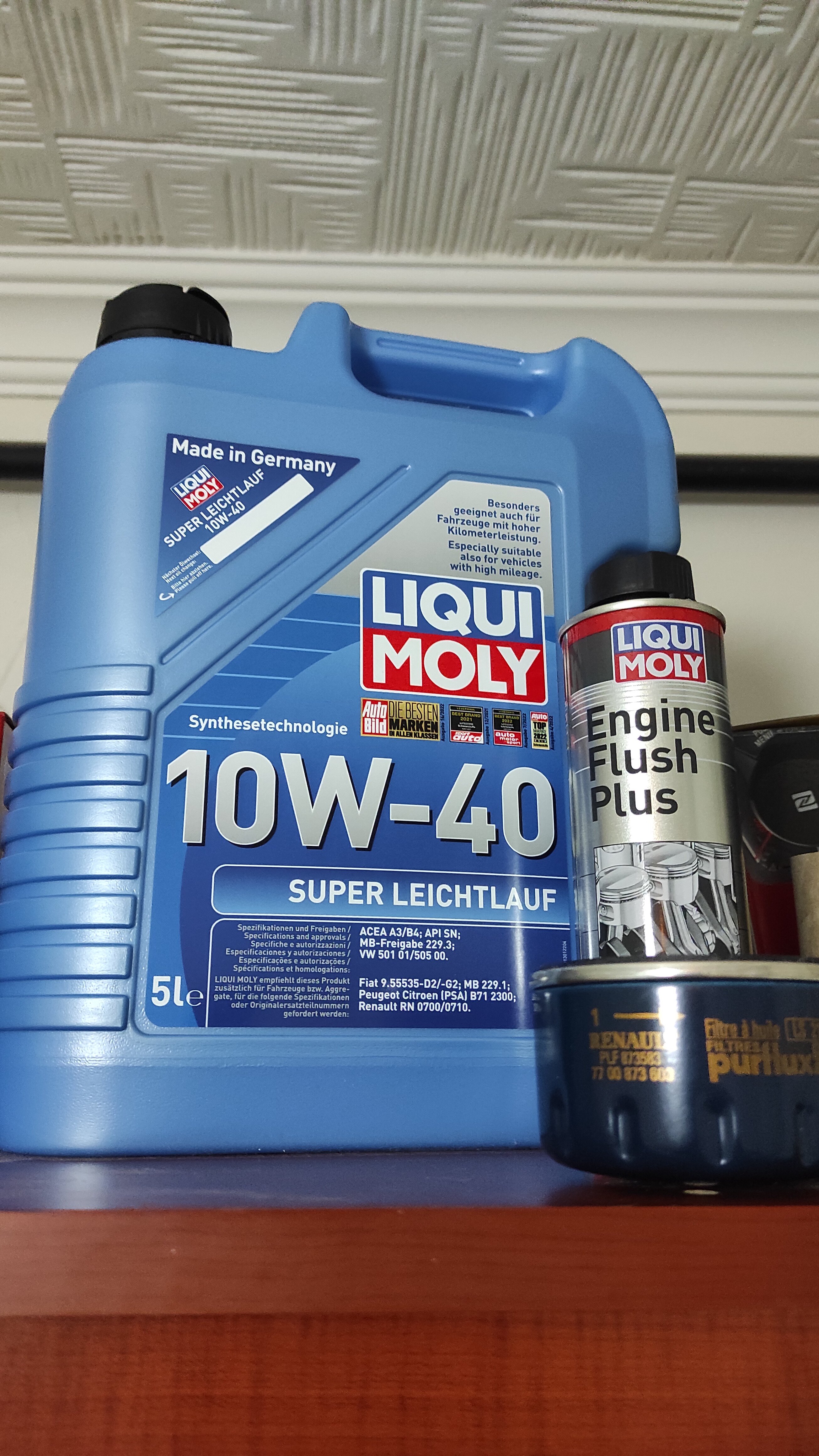

I changed the engine oil 7000km ago with Motul 6100 and Liqui Moly Mos2 additive. The previous oil change was with Shell Helix 10w40. I will change the oil again in 1 month and for this I bought Liqui Moly 10w40 Super Leichtlauf (Super synthetic). Everything is fine with my oil level and I check it often. Also, at my next oil change, I will disassemble the oil pan to replace the oil pan gasket. this way i will see if there is anything blocking the oil pump strainer.
