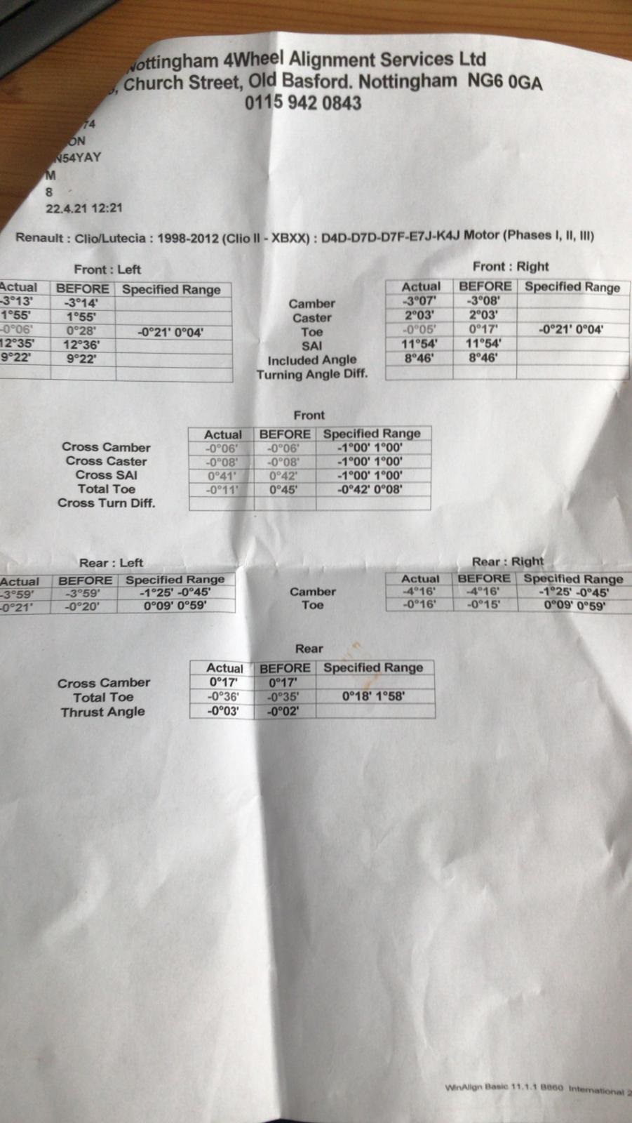

Was at cadwell park yesterday in my 182 with an Epas conversion and i found that the steering is really quite odd and nothing like i remember my old 172 being like.
I did my first trackday in the car at Donnington and found the steering was unnerving when turning left, it would just want to drift wide, then it wouldn't hold a straight line down the straights. Decided it was most likely the alignment so I got that sorted, had massive toe in, so changed it to a slight toe out which i think is about right.
I expected the car to be totally transformed for Cadwell and it was a load better, but turning left up through coppice the car wouldn't hold it's line at all and i had to all lock to just over a 1/4 of a turn to avoid going onto the grass! It also needed quite a bit of steering input to keep it running straight, occasionally i felt i had to apply loads of lock to just pull it to the left-hand side of the track.
The other thing to note was a knocking sound that developed throughout the day during hard left cornering, and eventually just ended up sounding quite bad from the left hand front of the car, i am guessing that it is probably the driveshaft and i'm not sure it's related to the iffy steering?
i have attached the print out of the alignment settings.

Was just watching some video's of clios at cadwell and it seemed like i had to use twice as much lock through coppice and make much bigger steering inputs on the straights to follow the slight curves.
Are there any area's in particular to check? I am thinking that i might fit the epas rack i have in the garage instead of the standard one that is just capped off i think?
Thats part of your problem, you will have to turn the wheel loads to get the wheels actually turning. Also the other part of your problem is the epas itself, it also requires excessive steering input to move the wheels. Combined with the 1.5 and 2 deg caster it must feel awful. I would fit the epas rack and get back to at least 3deg caster before you try it again.
