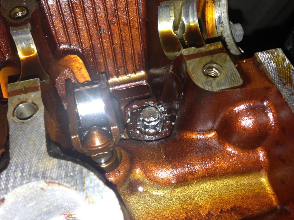

Like a numpty I have stripped a cylinder head bolt. Tried to tap on the socket and turn it, which just stripped it more. Anyone got any ideas on how I could get it out? Or any solutions at all? Pic below of the f****r
Grip Tite sockets Google them.
Failing that drill or grind off bolt head carefully so you don't damage head, just means you have to lift head off further once everything else is removed.
Then remove remainder of head bolt.
