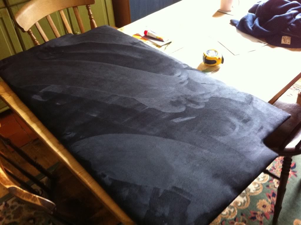

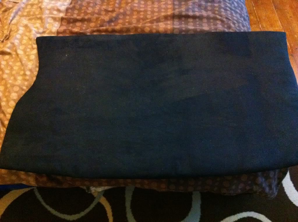

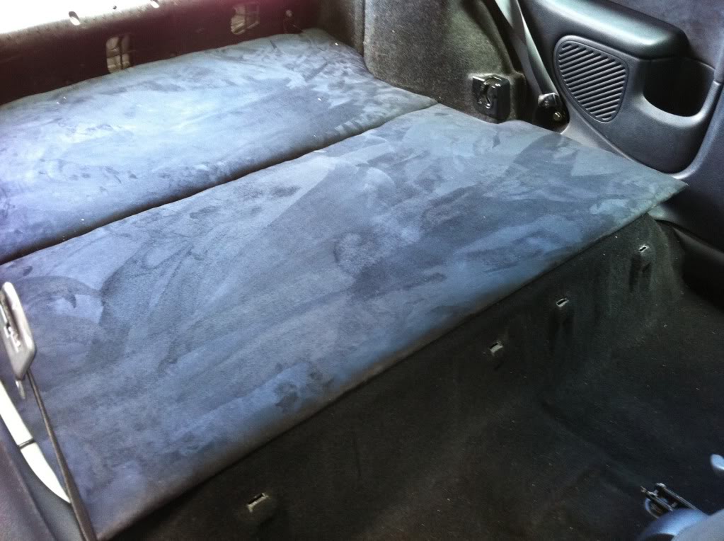

Decided yesterday to take the back seats out and make a really thin piece off a false floor
It's 6mm NSF with wadding and then nu suede wrapped over it

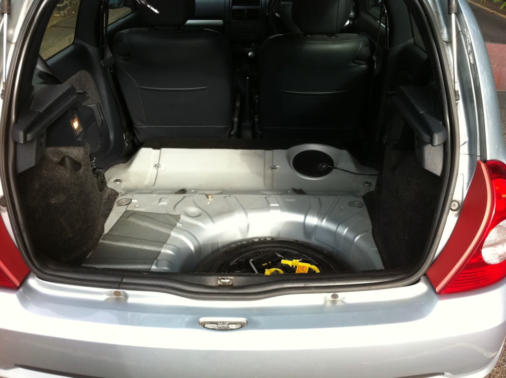

Seats out..

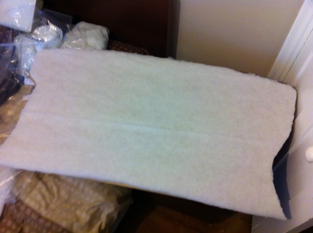

Wadding glued and placed

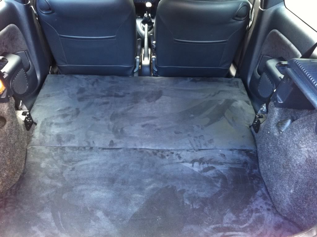

Finished the boot piece

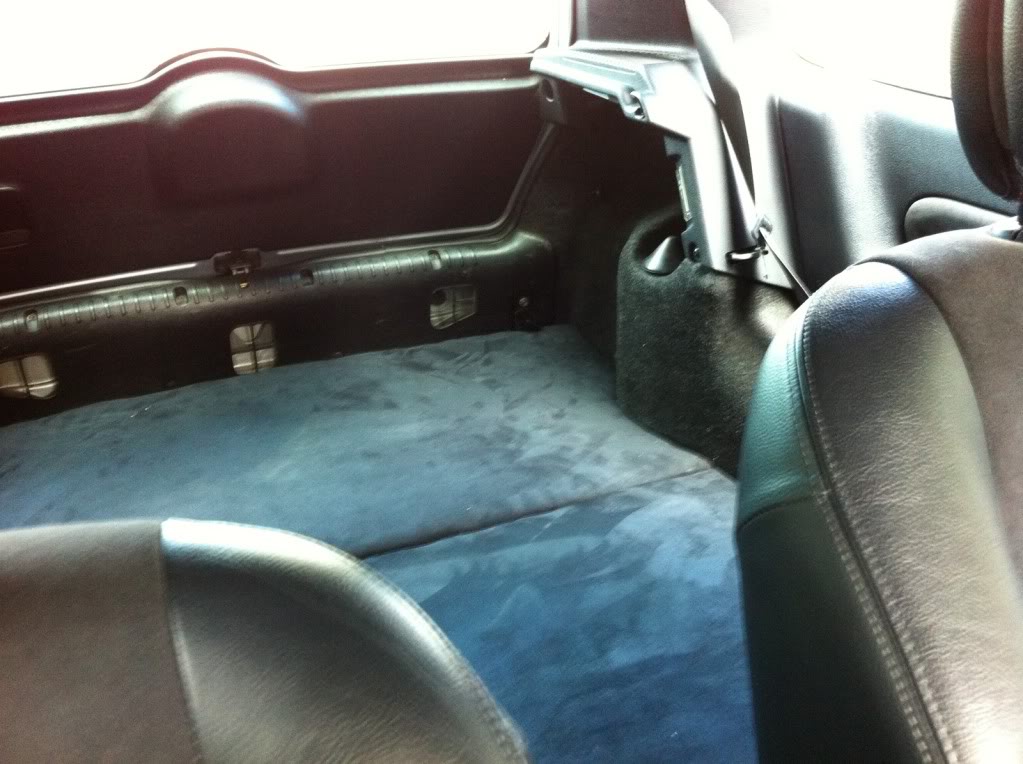

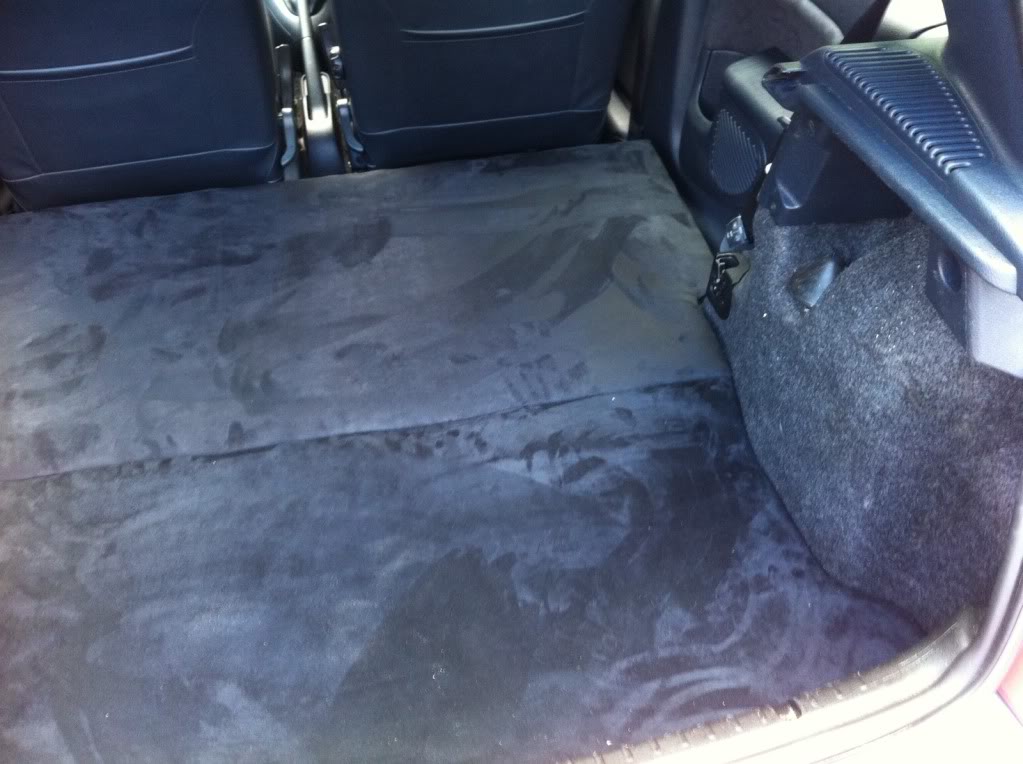

All fitted
Now just need to to the next piece, won't be able to do till Thursday now :(
Personally I love it, wish I could of got exact same colour as the suede in the Clio but couldn't but the black is good enough
put sum pics up of it all done thursday mate! looks good so far! im toying with the idea myself!!
Nice, looks like the same colour suede I used. I found 6mm too thin though, I was worried about setting things on it and it starting to bow. Make sure you make up some brackets for the next piece so it doesn't end up in your front seat next emergency stop :)

looks good, but looks strange with the standard seats imho...

I bet your rear seats are not even that much heavier than your false floor.
Just weighed it all roughly, my false floor both parts together weigh 3.8kg
The seats, rear beam part all weigh together around 24kg
So that's 20kg just like that and also removed spare wheel which is like 12kg
So IMO that makes it worth it lol
ok you win. see how much more waight you save when you get new seats the renault ones weigh an absolute ton!
Get rid of the spare wheel it weighs a bloody ton, I haven't had seats of a spare for years now,
but I mainly did it so my German Shepard's head didn't hit the roof, also he filled the rear veiw whenever he was in the back,
he sits alot lower in the car now, I also ditched the spare wheel as i'm just paying to carry the weight around.
A slightly better power to weight ratio was just a bonus.
