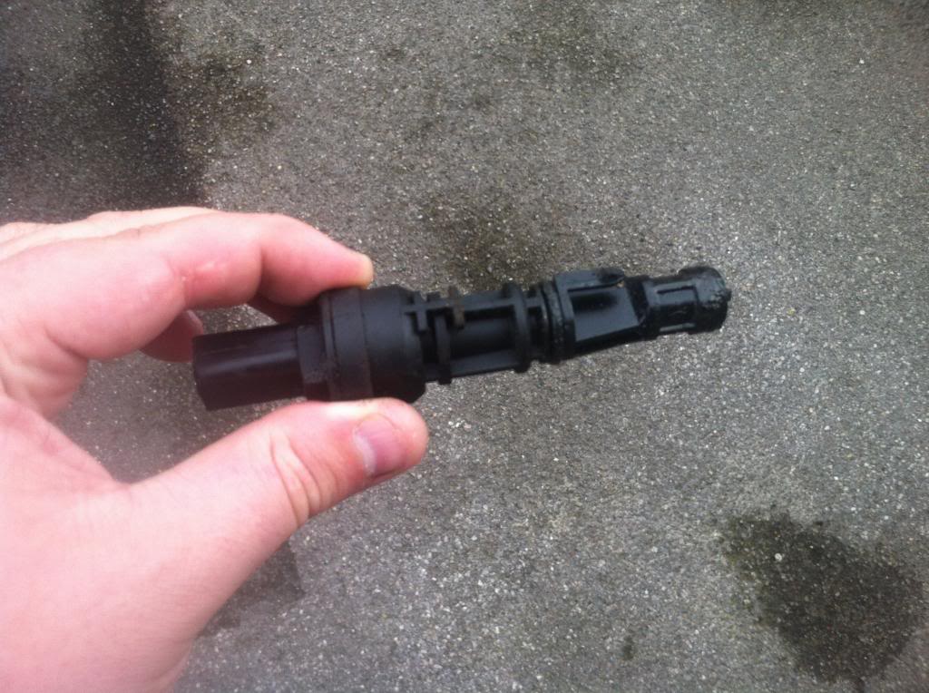

This is what a speedo sensor looks like when out. Bottom pointy bit goes in the gearbox, will have oil on it. Clean the oil off;

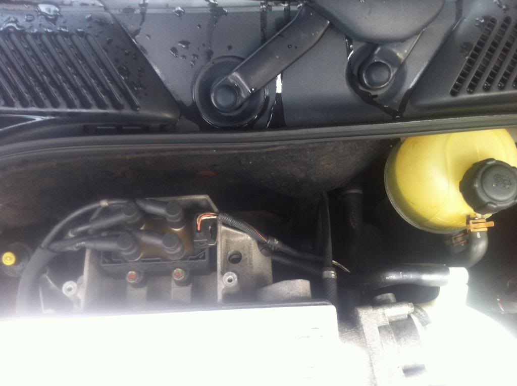

Look down the engine to the right of the coil pack;

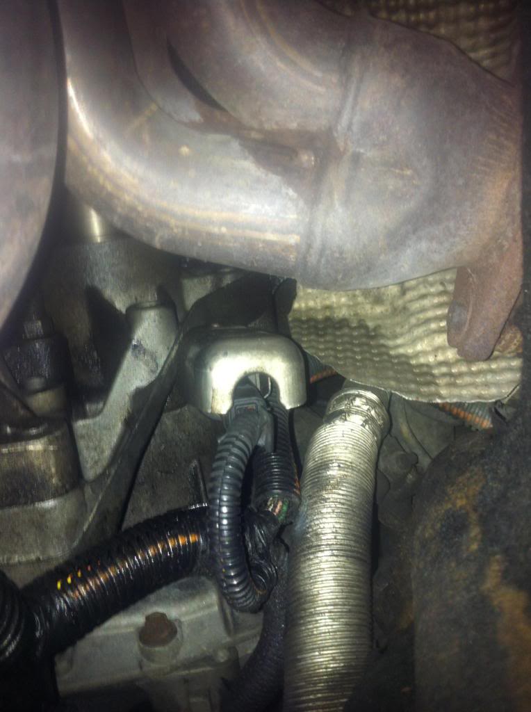

And you will see this. Speedo sensor is in the metal heat shield / bracket with the 'c' shaped cutout for the cable in the middle of this photo.
5 min job to change, and if you need a new one, they are circa £15 iirc....
