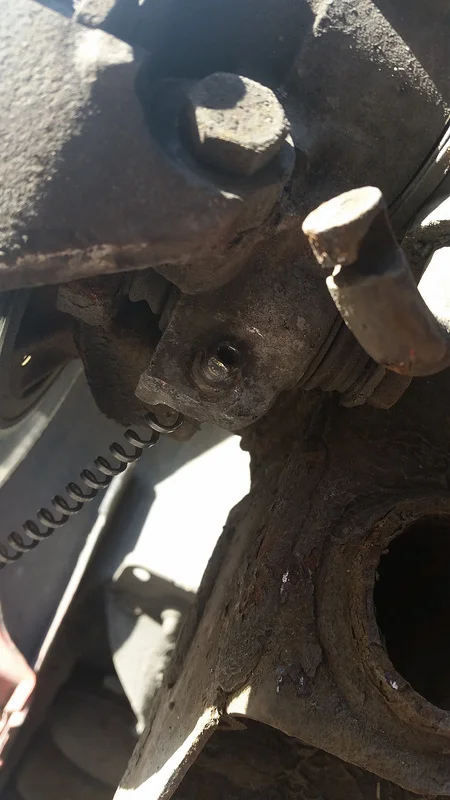

Handbrake cable snapped last week, got myself a new cable and set about replacing it today.
I unhooked it from mechanism near the catalyst, pulled it all back to the rear wheel but struggling to see how this metal part is removed from the rear caliper?

If it's a bit seized you will flatten it and it will never come out.
Soak it in some UB40 over night and have another go in the morning.

in your pic it seems there is nothing to remove? from what you said I thought you might be having difficulty getting the snapped end of the cable out, like if it was seised in to the arm. but the arm looks like is ready to just have the new cable put in from that pic. no? Am I missing something?
*edit* - Ah, I see! The remains of the sheath is still in the fixed part of the caliper...punch or drill it out.

The outer bit of the cable is rusted into the caliper.
Soke it in wd and hit it out with a punch.
I was looking in the wrong place, its what you said daniel, it just needs a polite tap with something heavy.
Which way are you hitting it??
Remember it has to pull one way so will only come out the other way.
