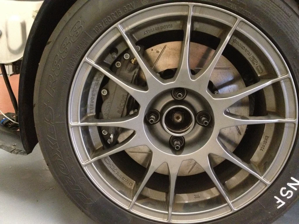

The PMS kit is designed to be be used as you say with upto 12mm spacers so if you mean you are going to go straight through the spacers you have got into the hub then this wouldn't be ideal. (I'm not sure this is recommended with a bolt to hub spacer though) The reason the PMS 75mm kit only allows for 12mm spacers is because of the bullet tips on the studs which I would estimate takes up nearly 10mm off the useable stud length. I would suggest you bolt the spacer to the hub and then just add a stud kit to that :) The picture below is the PMS kit on my car and shows the amount of thread left with no spacers fitted.

Thanks mate, I was going to bolt the spacer to the hub first of all with the FK Bolts that came with them and then add the stud to the spacer afterwards securing the wheel to the spacer like you said above. Do you think the pure motorsport kit would be sufficent for that ? or alternatively would you know of another stud kit i could go for ? Cheers btw
Yes mate if you are bolting the spacer to the hub first and then fitting the stud kit to the spacer then they will be perfect as it is just as though you are fitting them to the hub :) You would have roughly the same amount of thread left as my picture! I would recommend the PMS kit all day long it really is a quality bit of kit and if you are taking the wheels on and off often they seem very strong and the bullet tip makes it very simple and quick to fit the nuts :)

Thanks so much thats really set my mind at rest. Hadnt looked at it that way but now you have said it does make sense. I will look to get some ordered, cheers mate
