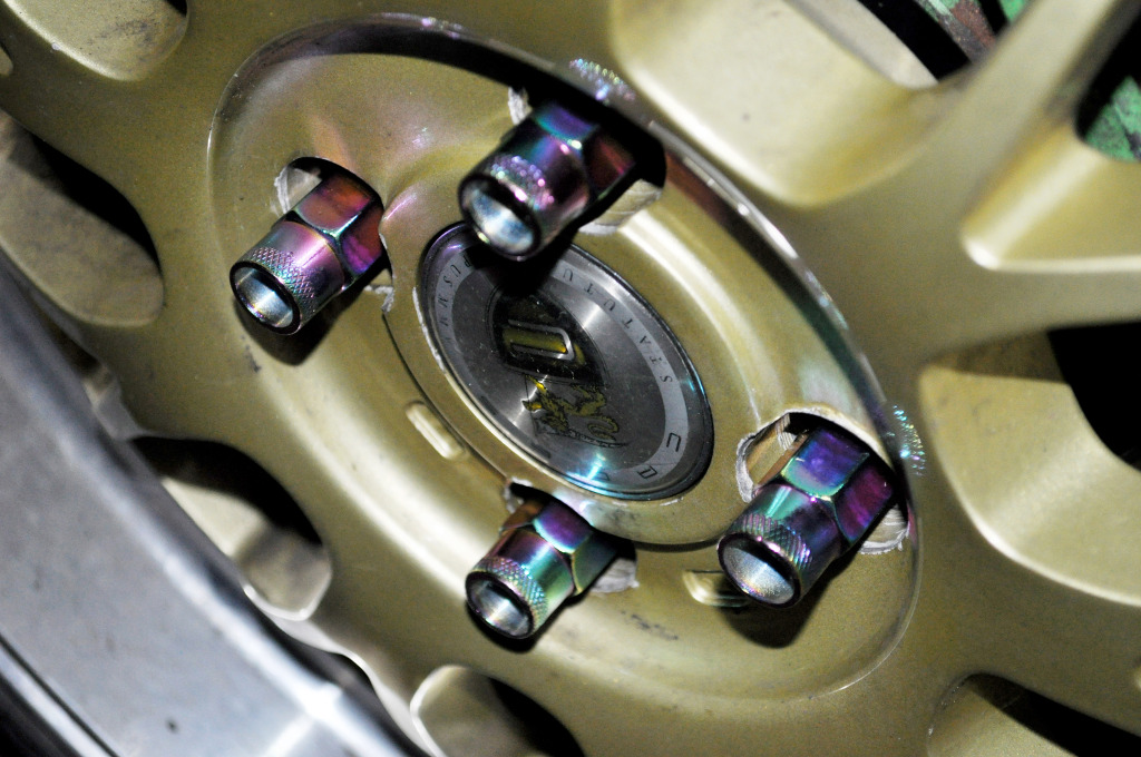

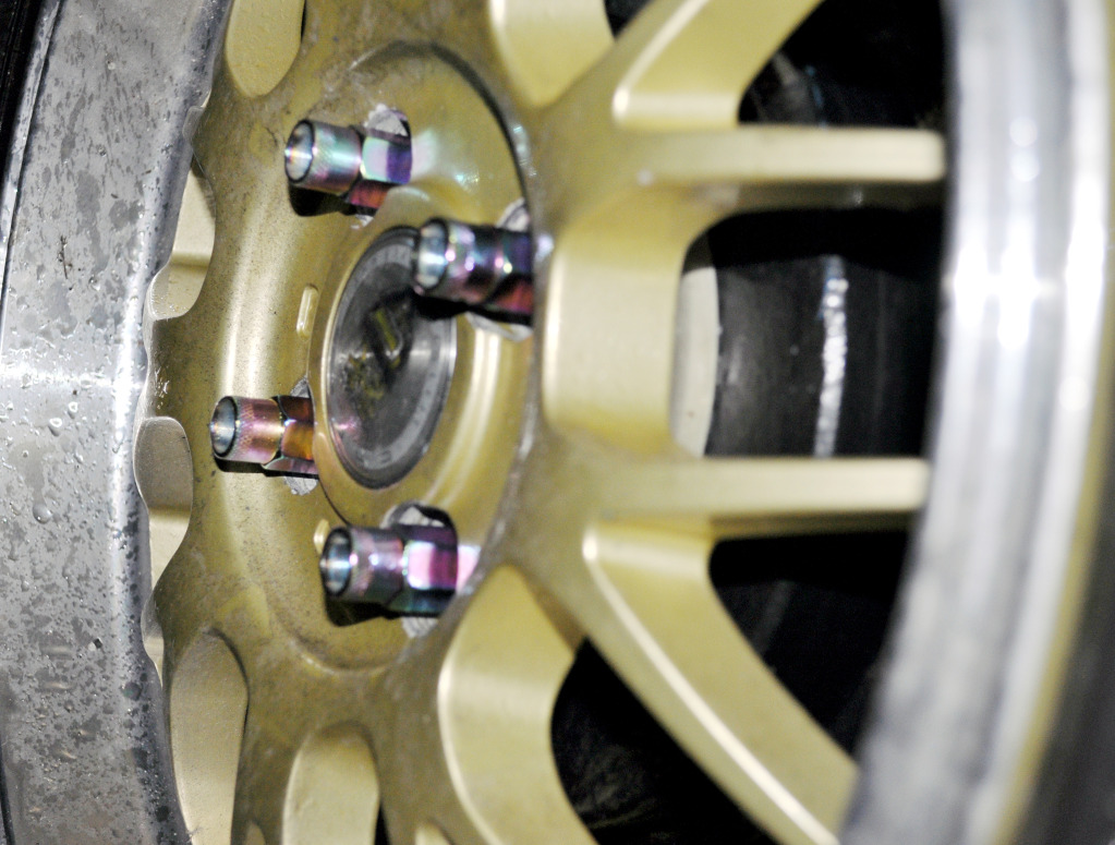

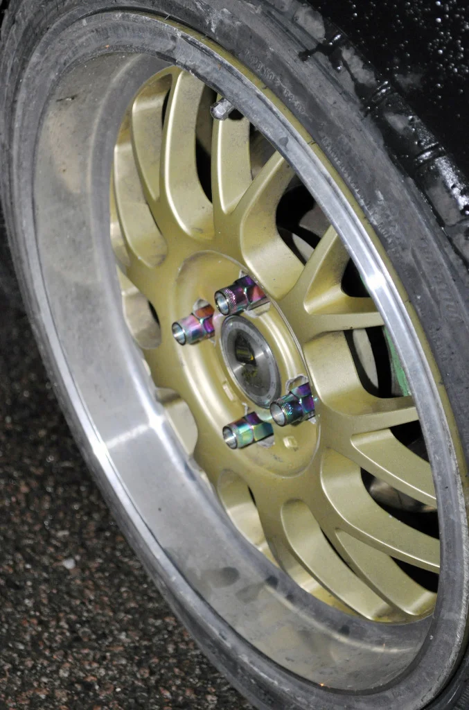

received and fitted :)
very impressed tbh
il just leave these pics here....
and my favourite pic:
*yes I know its dark but it was dark when I started fitting them lol
