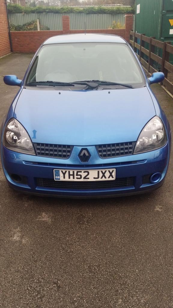

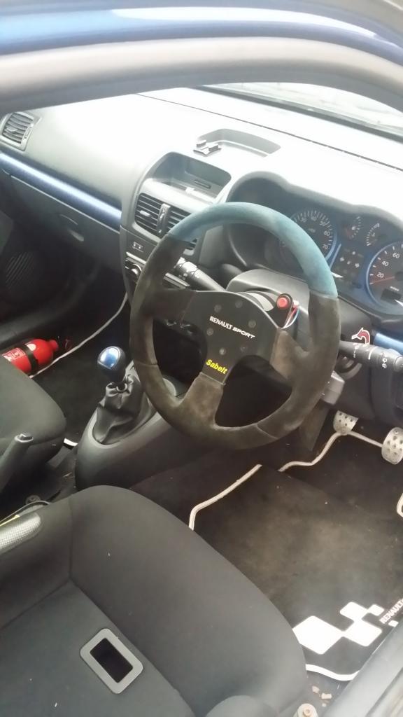

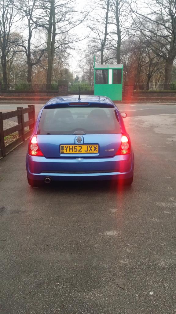

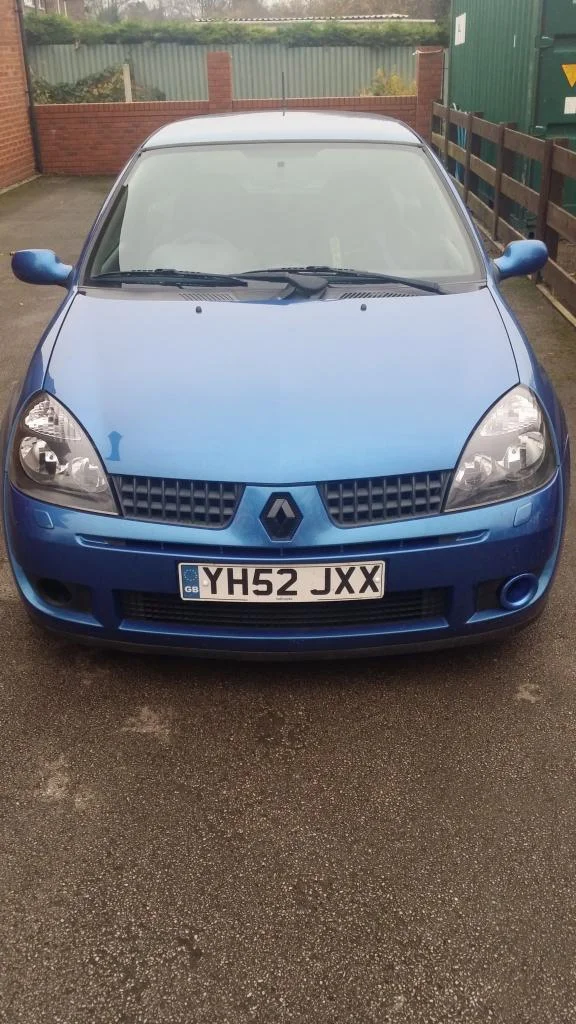

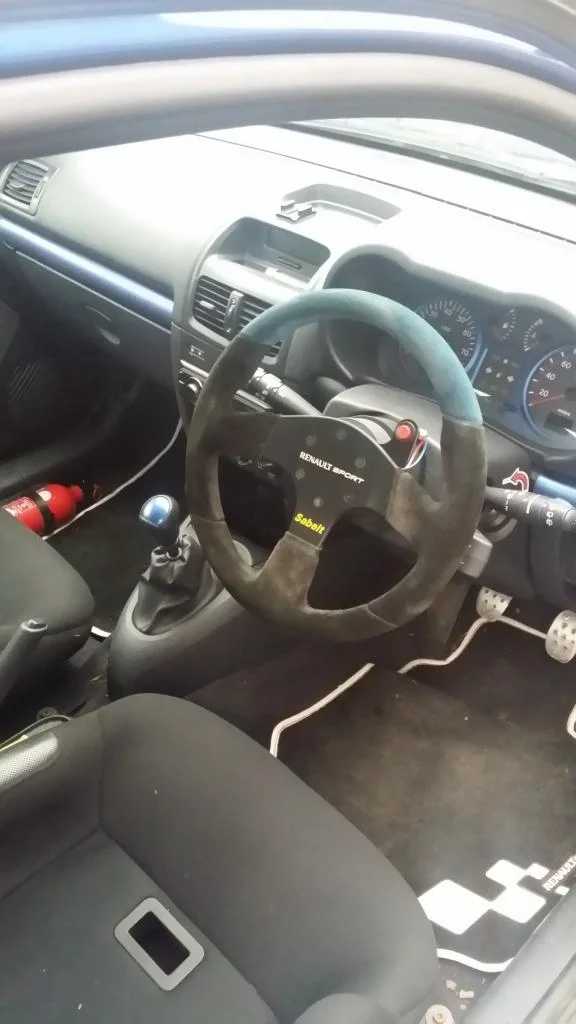

Well finally bought a 172 Cup to share with my Dad doing Track days and thought I would post some pictures up.. Took delivery from @Chi today and after biting the bullet and Insuring (£299 fully comp with Greenlight as a 2nd car) and throwing 6 months tax on (was going to do it monthly and just sorn and re-tax when I was doing a track day but lost patience with the DVLA website and just did 6 months). Took it out for a spin and its a nippy little bugger lol (wish it was as quick as the 300hp turbo Chi took me out in lol that was a BEAST). First things will just be a good clean and tidy and if we get a nice day maybe get my dad to throw the rotary over it and polish it up a little and maybe get some of those nice shiny stainless towing eyes as I don't have any to put on when I go on track and thinking about stripping the interior out the back might do a couple of days first see how it goes as I've heard it doesn't weigh that much and I don't have a cage yet.

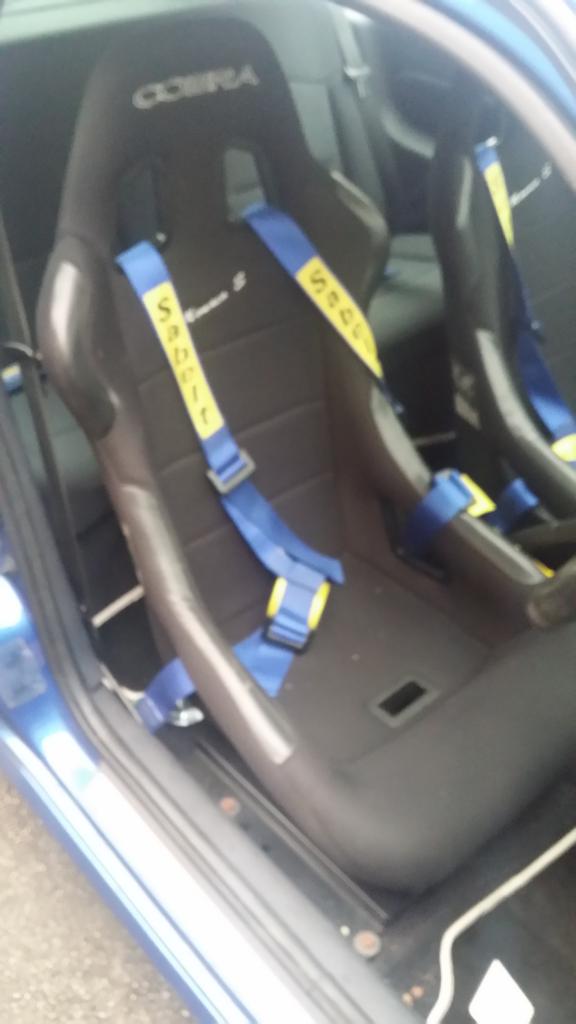

Spec : BC Coilovers, Quaife Slip diff, 2 x Cobra Monaco Bucket seats with harnesses, Renault Sport Sabelt Steering wheel, Powerflow cat back exhaust, ITG Maxogen Carbon Induction Kit, Anti Roll bar, Powerflex Bushes (not sure which unless Chi can remember for me) and also a spare set of Speedline 2118's could do with a refurb but debating this as they will be track wheels.

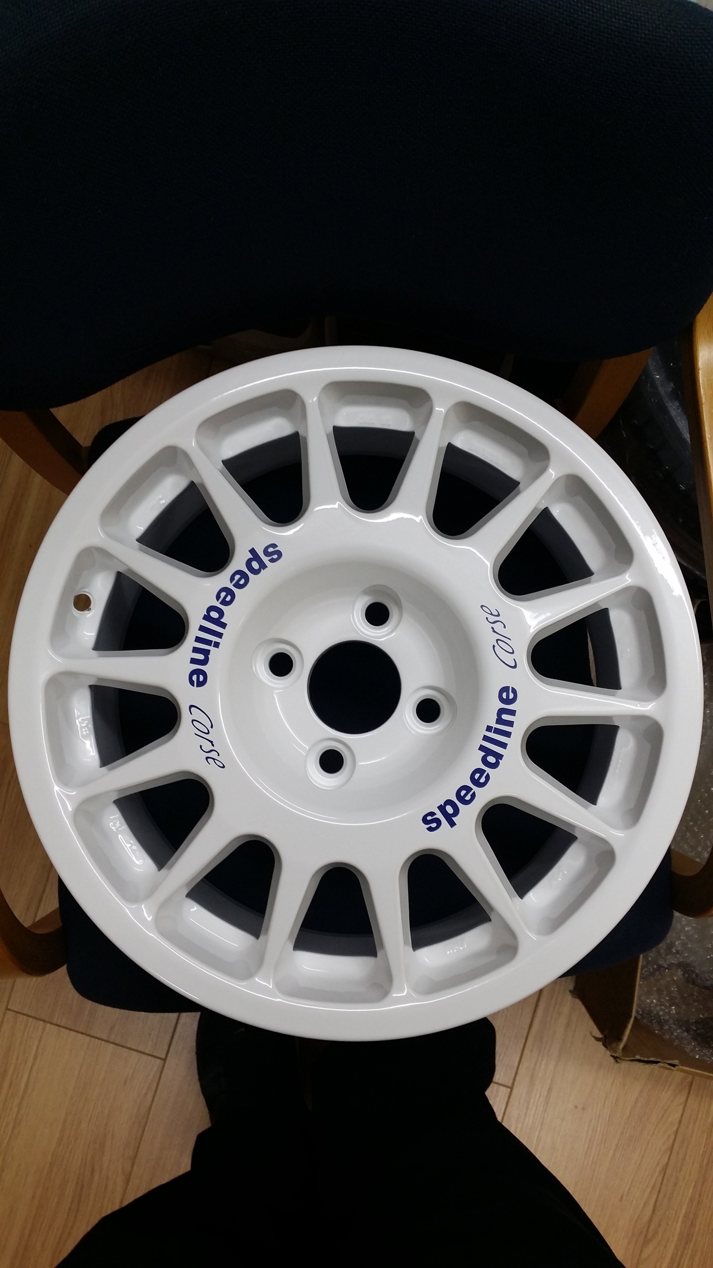

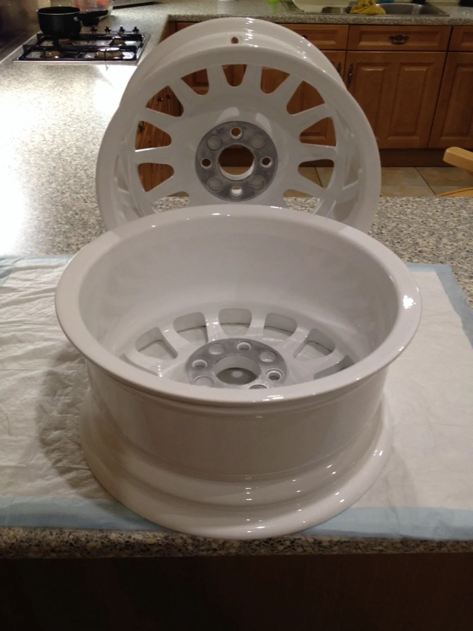

Dropped my 2118s off to be refurbished white on Thursdays hoping they come back good. And want to get it stripped out and all the wires/cables tidied up ready to work on my shopping list.

@JoeMarano Yeah they're sliders luckily as I'm 6'1 and couldn't be doing with fixed runners plus I share the car with my dad. They're pretty comfy too once your in them just feels weird as I can just about see the end of the bonnet with them being pretty low down.

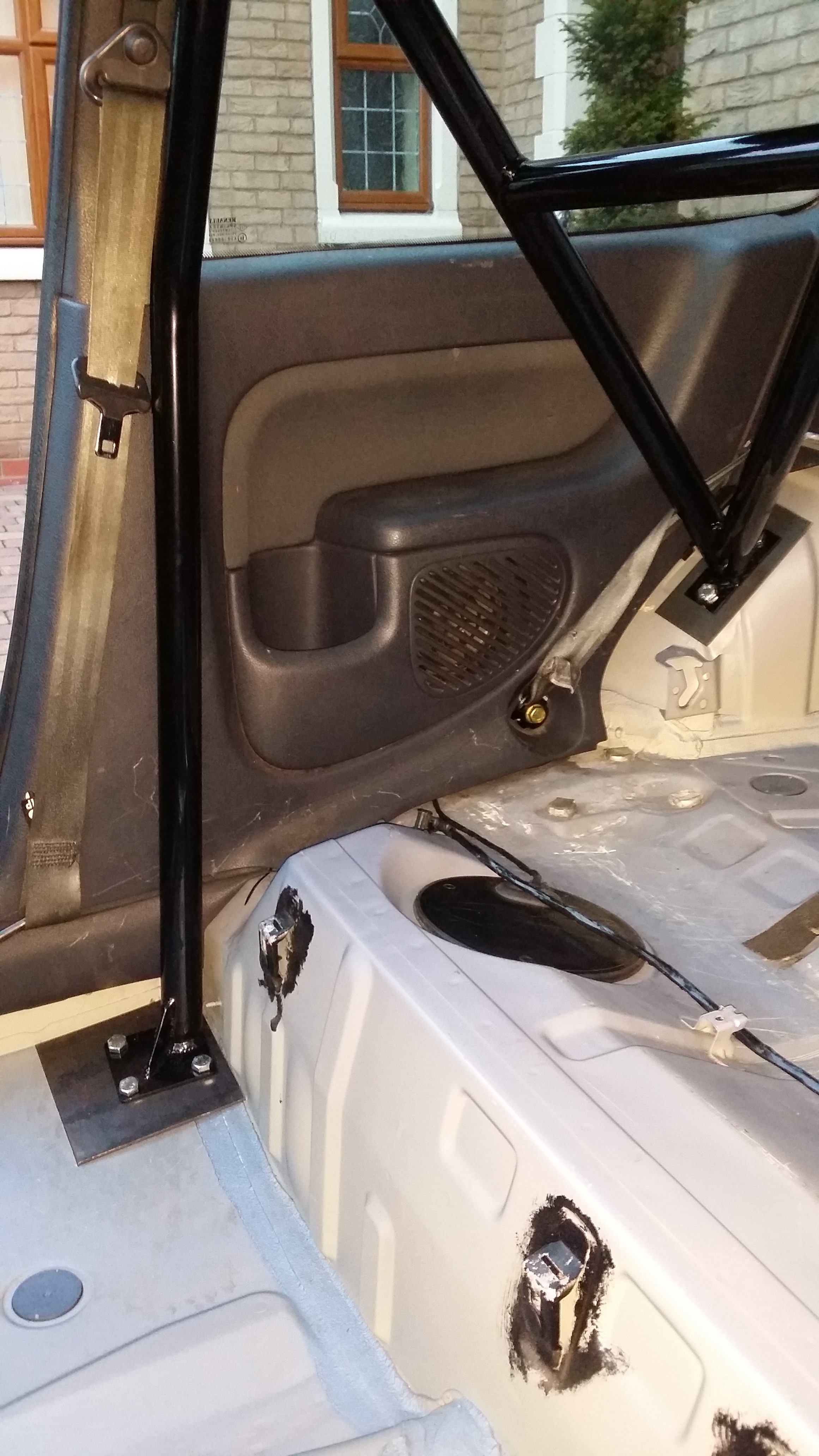

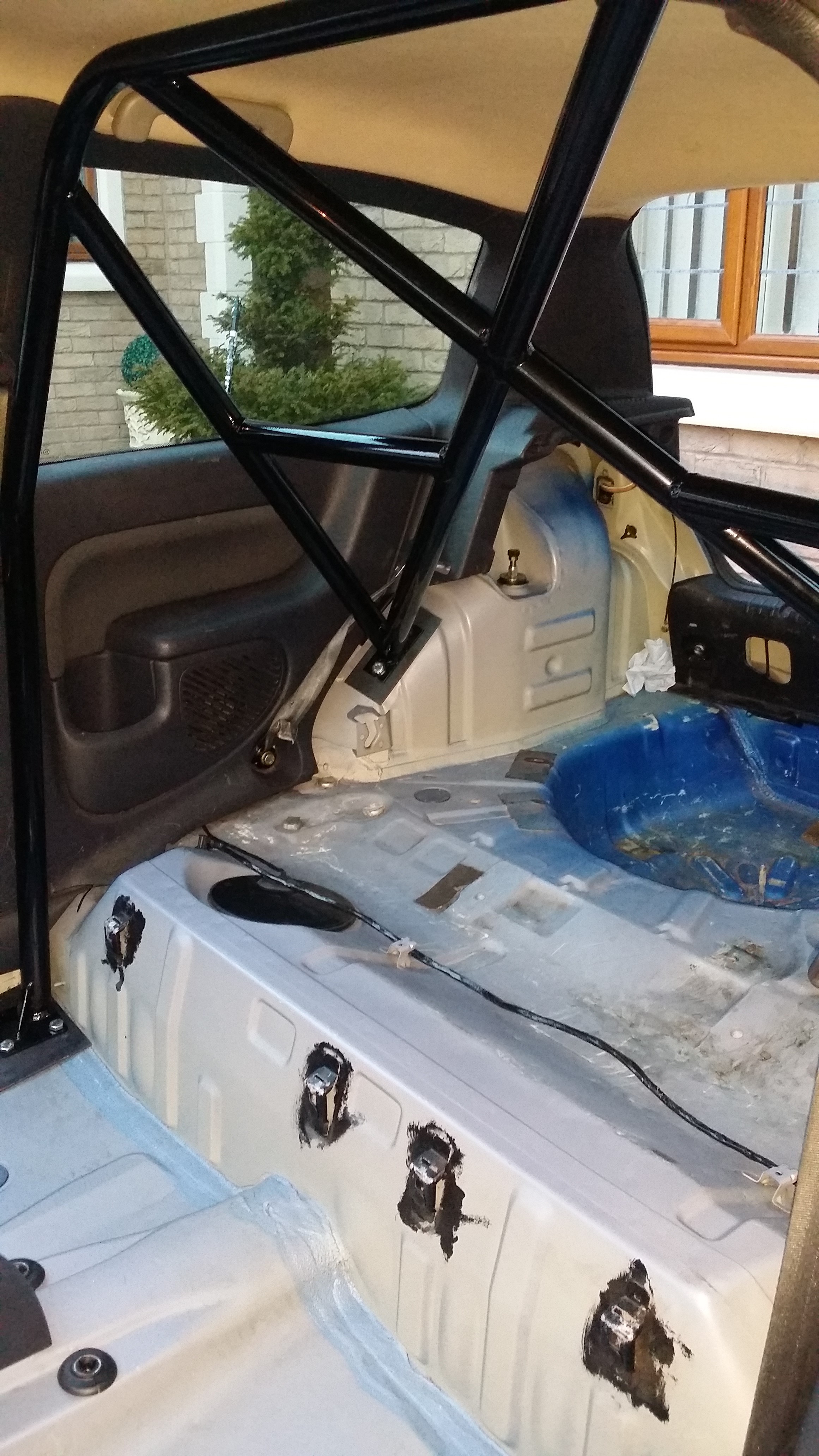

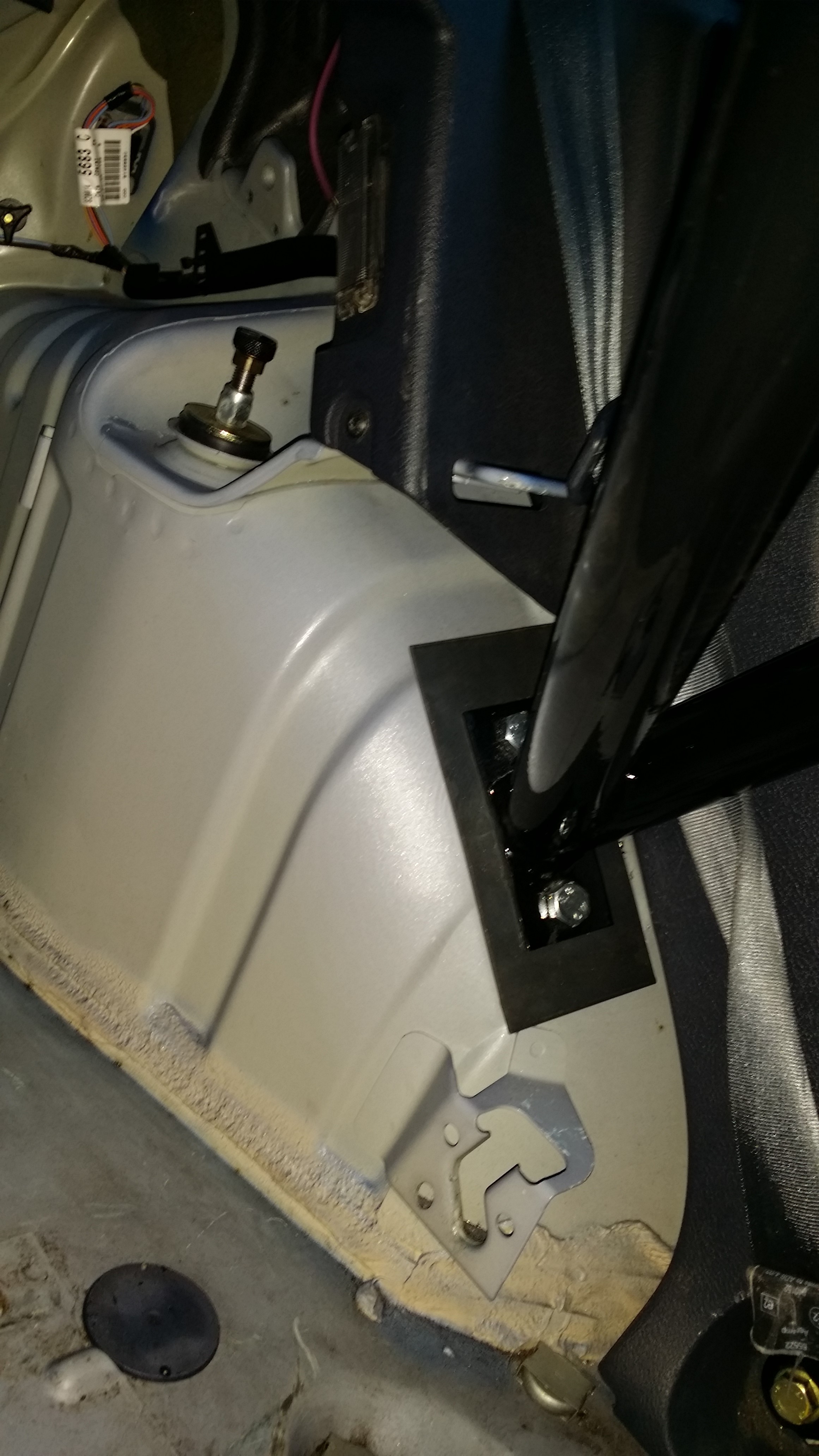

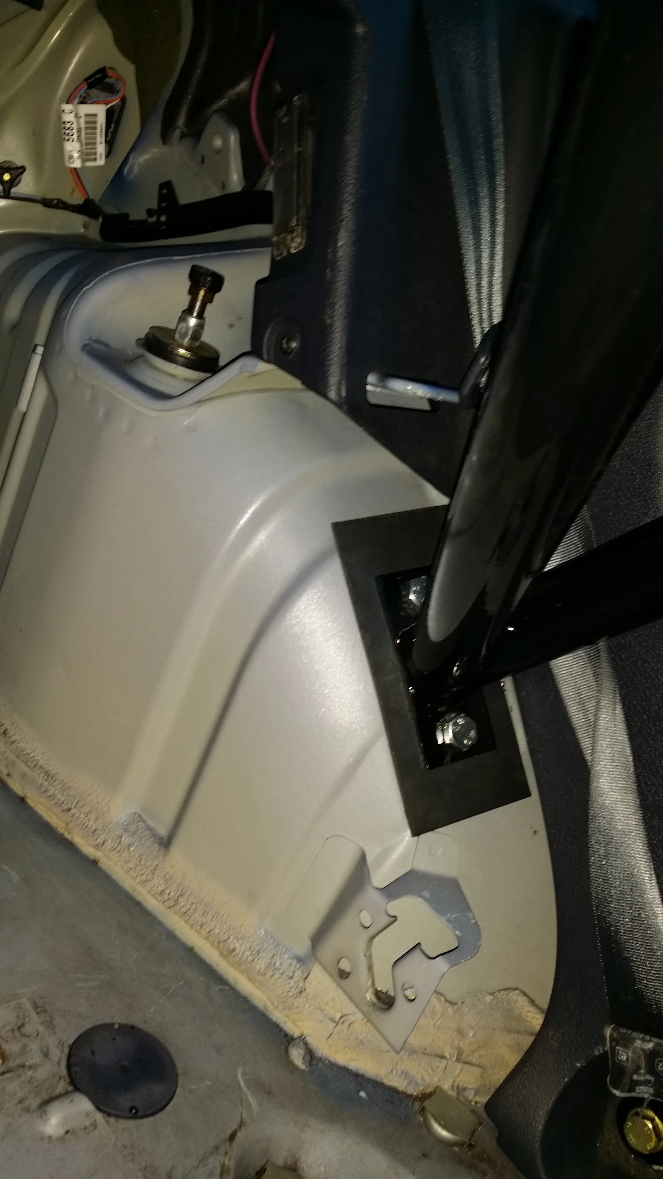

Well managed to get some stuff done lately... Took me all day (about 5 hours) to fit my rear cage. The spreader plates are 4mm thick and 7"x7" on the inside of the car floor and 4"x4" 6mm on the underside just incase, the rear arches have 3"x8" 4mm thick on either side of the arch all held in with M10 bolts and nyloc nuts. Just need chance to get my mate to TIG weld them down hopefully tomorrow before I go Oulton on Tuesday.

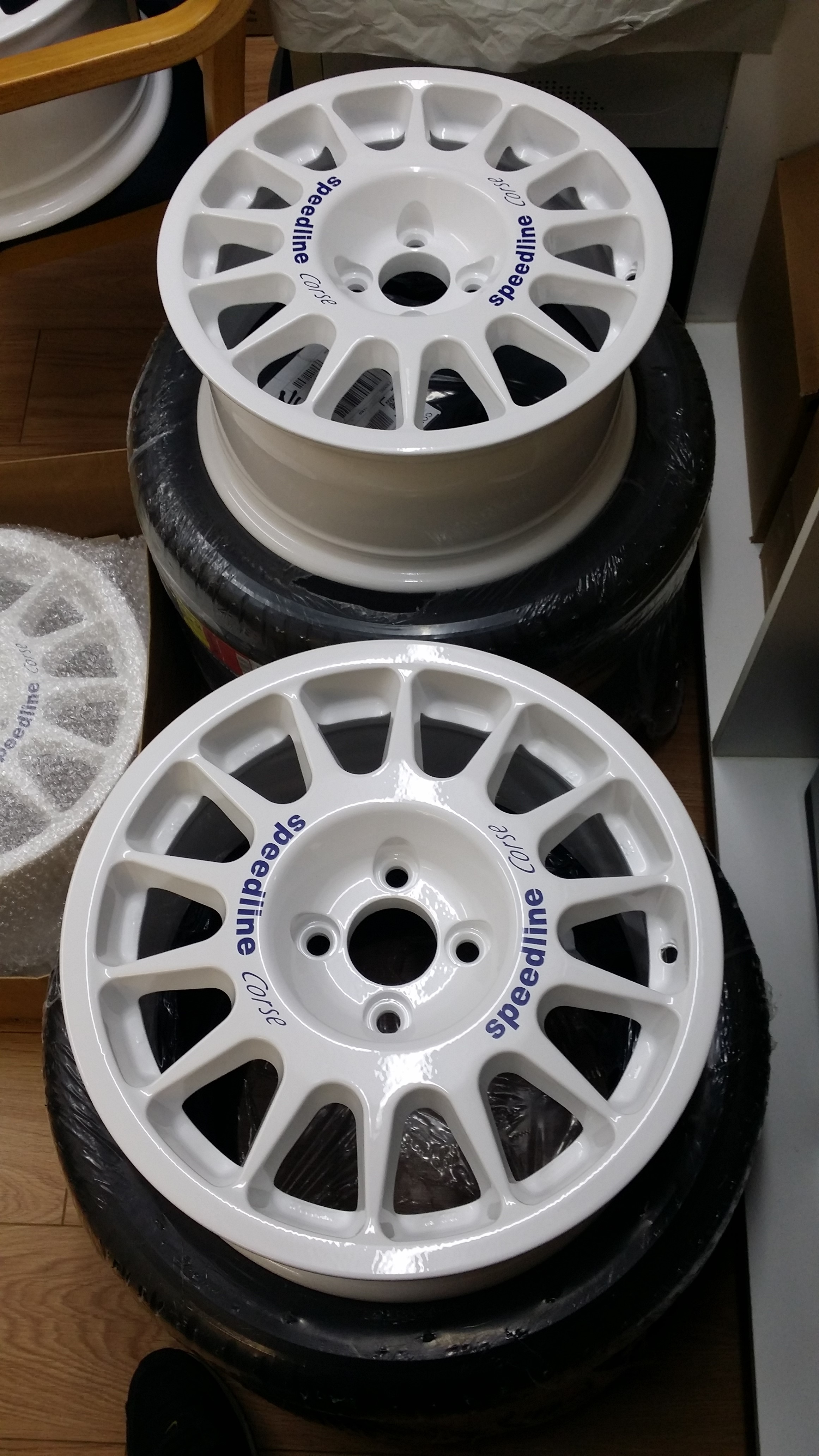

And fitted my 2118 Speedlines, they have brand new 195/50/15 Michelin pilot sport 3 on them as I was undecided what to use on track so thought incase the weather is bad I'll use some decent road tyres and use the spare set of wheels for some more dry orientated tyres, Also found I have Goodridge braided hoses already on there too. Cleaned it all out and cleaned whats left of the carpets and seats and cleaned the bare metal.
It was very dark when we finished about half hour ago lol so will try and get some more pics tomorrow of the inside with everything fitted back in and all nice and clean. @Chi what you think now, coming along nicely.

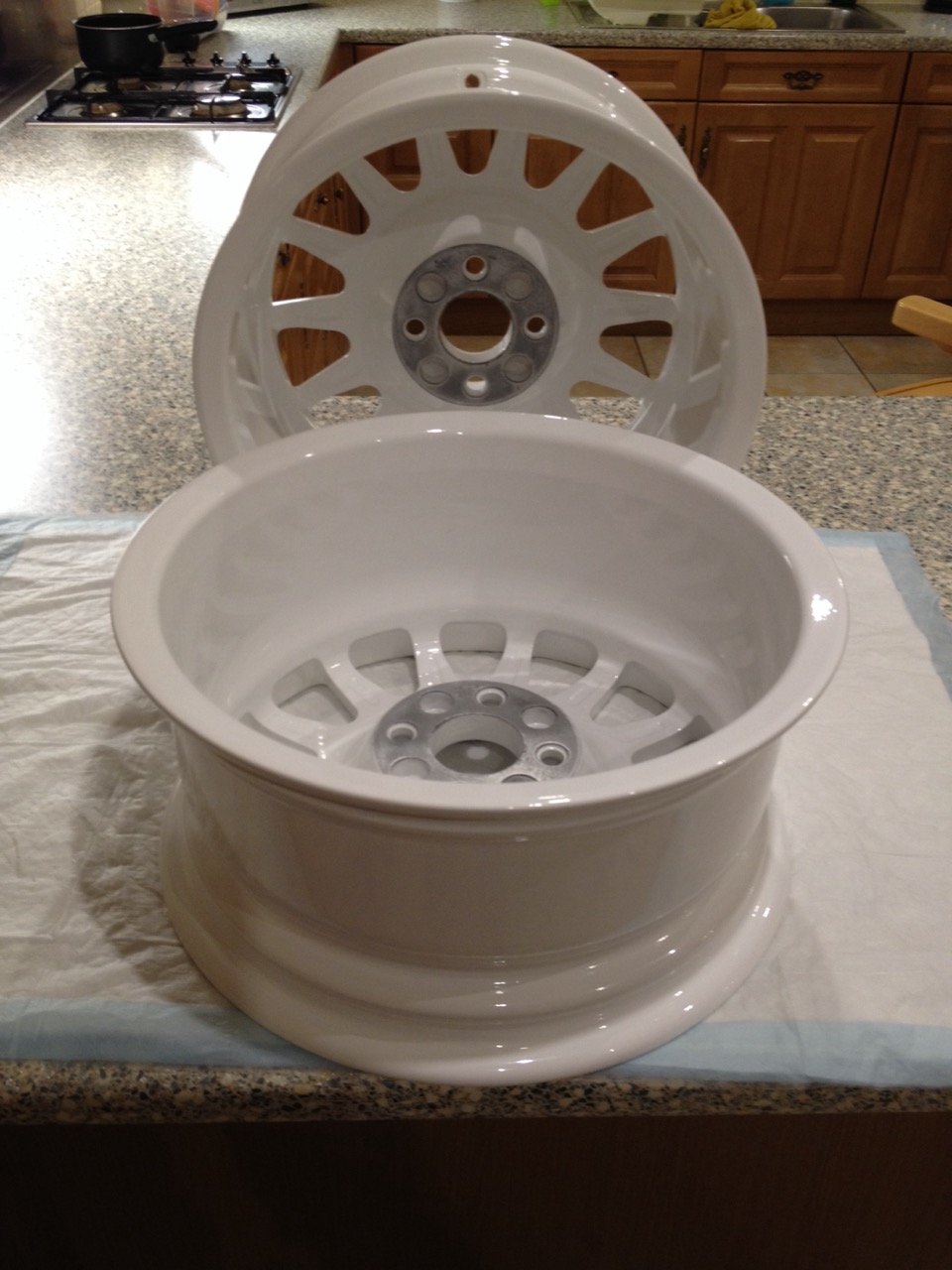

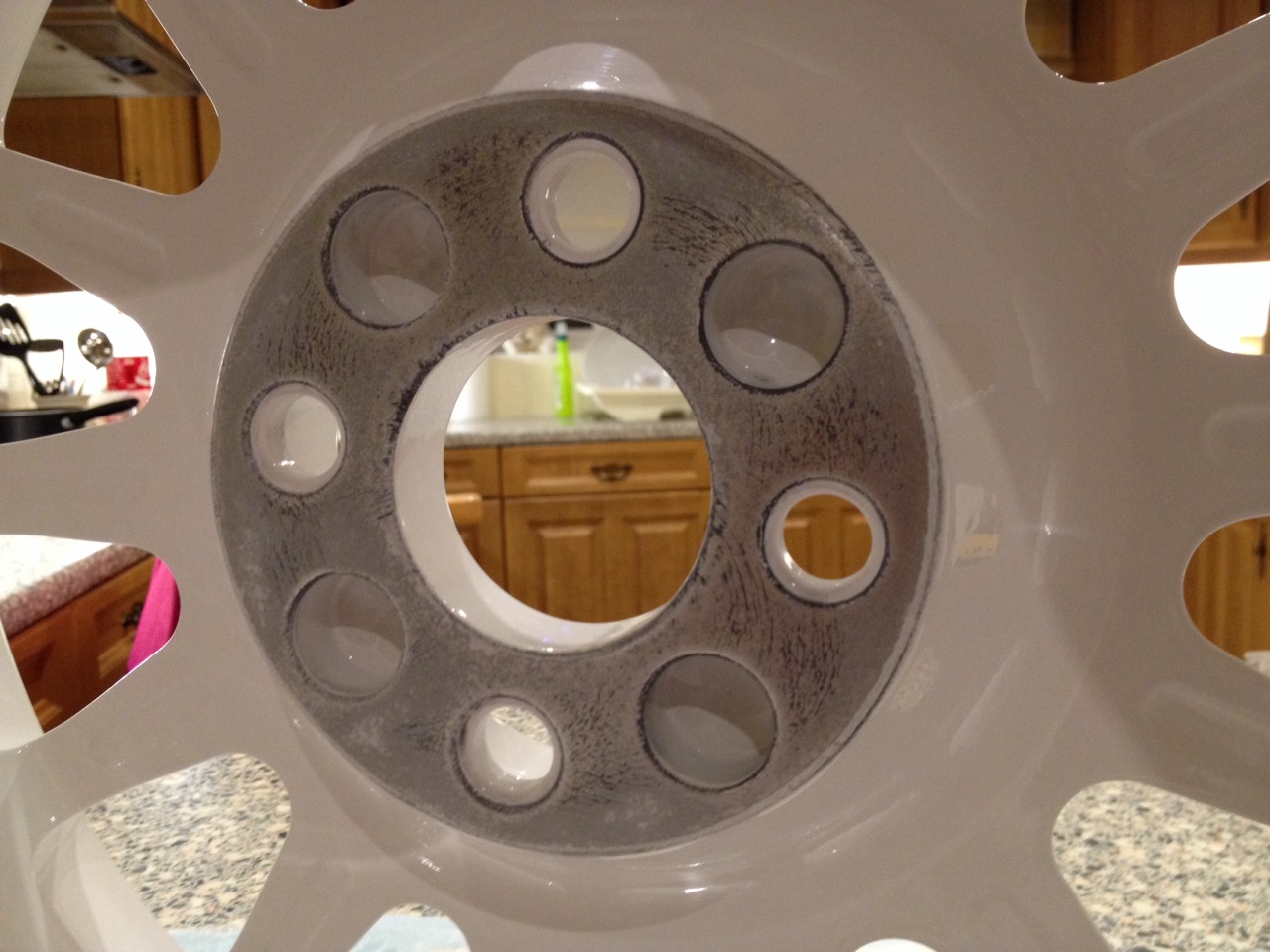

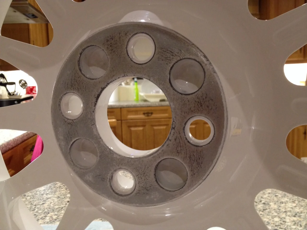

Already done it @JamesBryan the wheels on their own is a slightly older pic lol had to do the hub faces too, just wish I knew then what I know now and that I should have told the powder coater to mask them up.

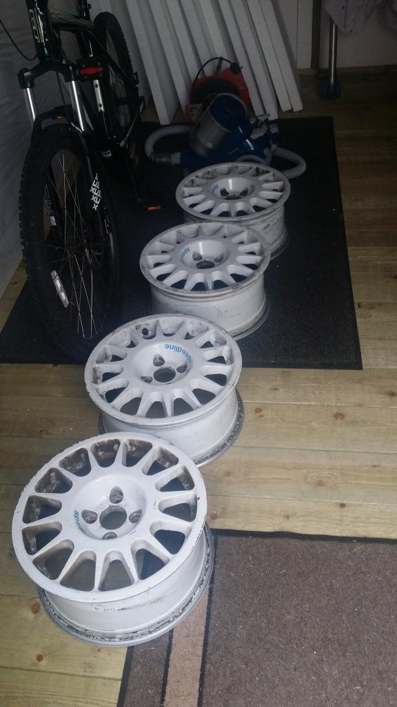

Stu are you selling the 15's that came off? If so have you got a pic please. Oh and the car looks spot on, love the wheels
Was debating on selling the wheels and part worn AD08r that are on them to fund a spare set of Team Dynamic 1.2 or something along those lines or just keep them and use them myself lol (after the hassle I just had with the refurb on the 2118's im in two minds lol). I will let you know though what I decide to do. They're in the van as a backup for Tuesday just in case.
