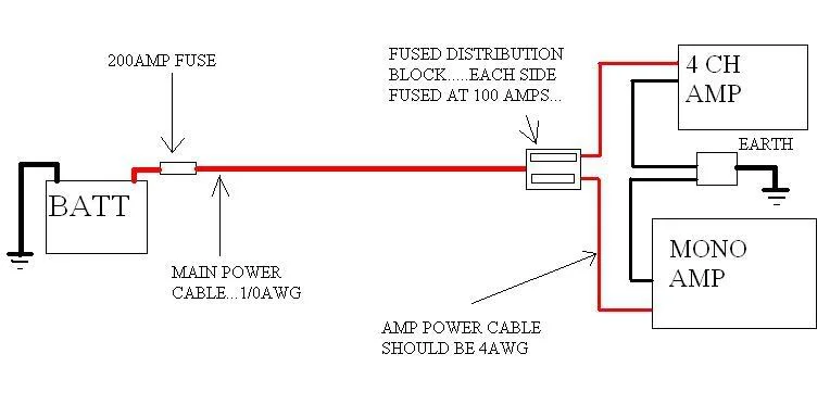

You may now need to upgrade your power supply...
Easiest way to work out what you require is;
1, Add up all onboard amplifier fusing....this will give approx max draw...
2, Fit correctly rated power cable....(Don't forget to ADD an extra battery to chassis earth to match your new power cable)....
3, Fuse new cable according to its own rating....
4, Fit fused distribution block in boot to split main power feed between each item, (again use correct grade of power cable to feed each item from the distribution block)....
A Quick sketch to show a twin amp setup;
You can ignore the quoted sizes/figures in the sketch, this sketch was done for a higher powered setup....
Yours will probably come out at;
Batt--to--boot = 4awg fused at 80amps
dist block--to--sony amp = 8awg fused at 30amps in block
dist block--to--sub amp = 8awg fused at 40amps in block

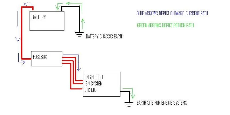

Would you, lets assume your reconnecting a cars battery, you've just sent a power surge through all the electrics and now need to replace a few expensive items, (esp if doing this on newer cars).....
Connect live first, then earth and surge is limited to earth terminal....

An electrical circuit is just that, a full circuit....
The battery +ve terminal is the source or start of the outward path, the current then travels through the circuit and back to the battery via the return path, (in the case of a car this is the chassis then finally the battery/chassis earth strap)....
If you complete the circuit at the source, (batt +ve terminal), the surge will follow the circuit right back into the battery +ve terminal....(full loop taking out all sensitive circuits on its way)....
If you complete the circuit at the earth terminal then the surge begins and ends at the -ve terminal....
So if you break the circuit anywhere, the power surge will follow the blue & green arrows till it completes the circuit...
hope you understand

With regards current being drawn, correct it is, your method current is drawn in the form of a power surge from the source, ( +ve terminal), right through all circuits and back to the battery, my method, (the correct method), its drawn from the earth strap/terminal into the battery....You do realise the battery acts as a draw or load when its part of a circuit....
