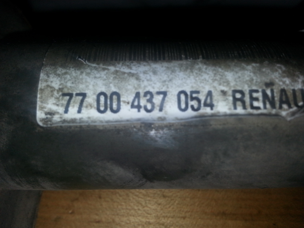

I have just bought a non sport steering rack (unsure of model)
I need to fit this in a 172 but do the clio range all share the same subframe?
At a quick glance the mounts look as if they could have diffrent spacings then what I require.
I will try to add pics this evening as im on my phone.

A non sport rack should fit but you will have to swap your track rods and ends over I would think, you will know when you lay them side by side. The 1.2 racks mount with 2 bolts and sports mount with 4 iirc
  Ph2 172
Would any one with Dialogys be able to tell me what model this part number relates too please.
