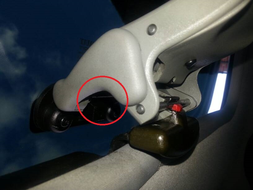

So where does the straw go? Here's my sunroof handle:
Thanks guys!
  Suzuki Ignis Sport
I've used some spray grease and it seems to have cured it. Was the passenger side front bit. Not on the clip, the actual bit that slides into the car. Thanks for help guys!
