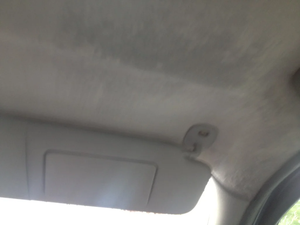

Woke up to this :(
GREAT

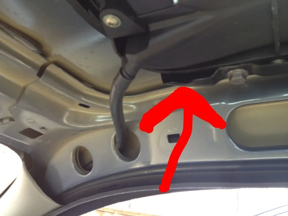

I taken head lining down a bit and it seemed to be really wet here ImageUploadedByTapatalk1342192703.749552.webp
Yeh seems like a seal to me,
What sun roof is that? Does it wind into the roof or do you pull a handle and it pops up a bit to let some air in? If that makes any sense at all!
Yeah it does mate, the handle u lift and it let's a little bit of air in.
