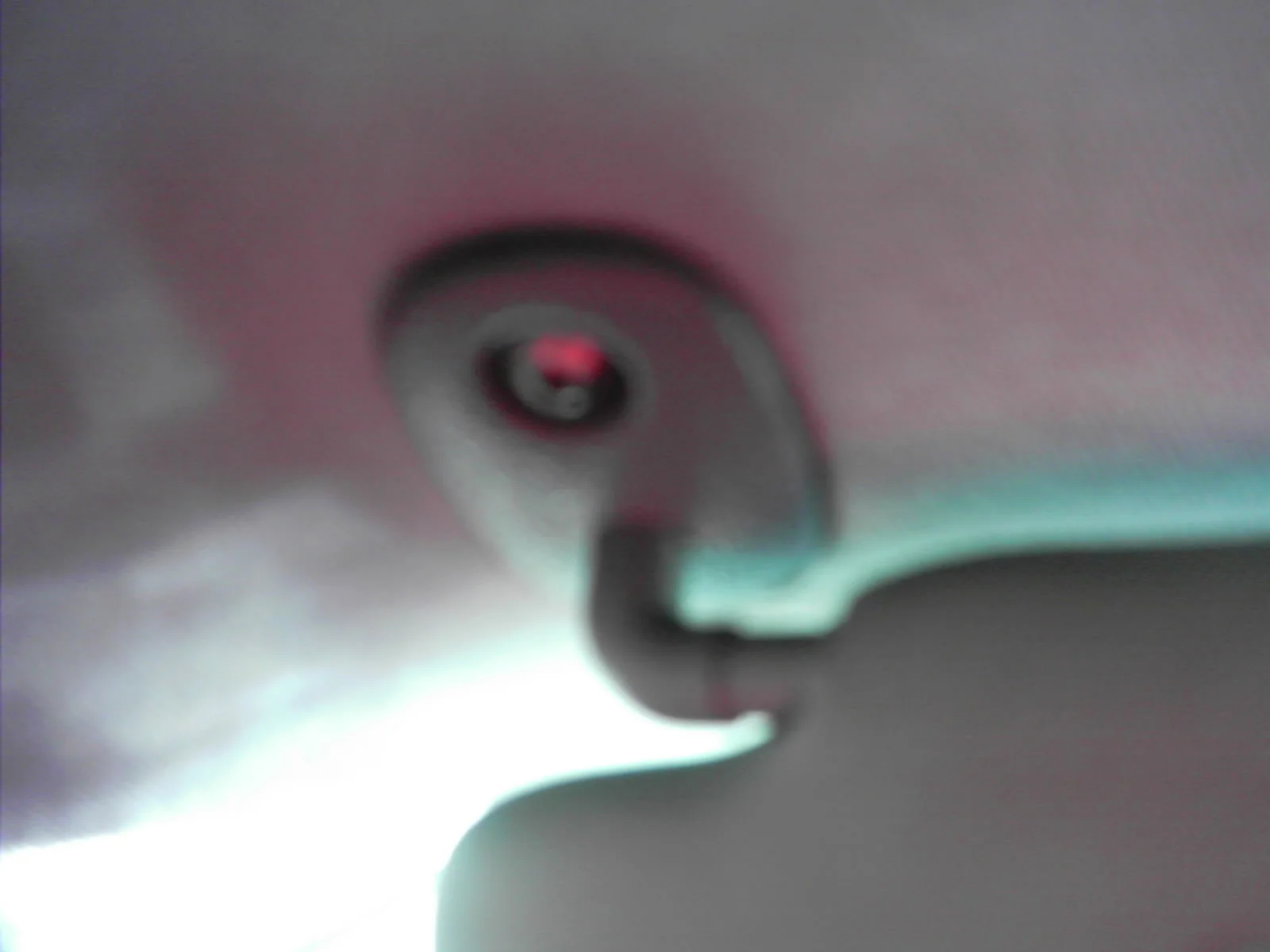

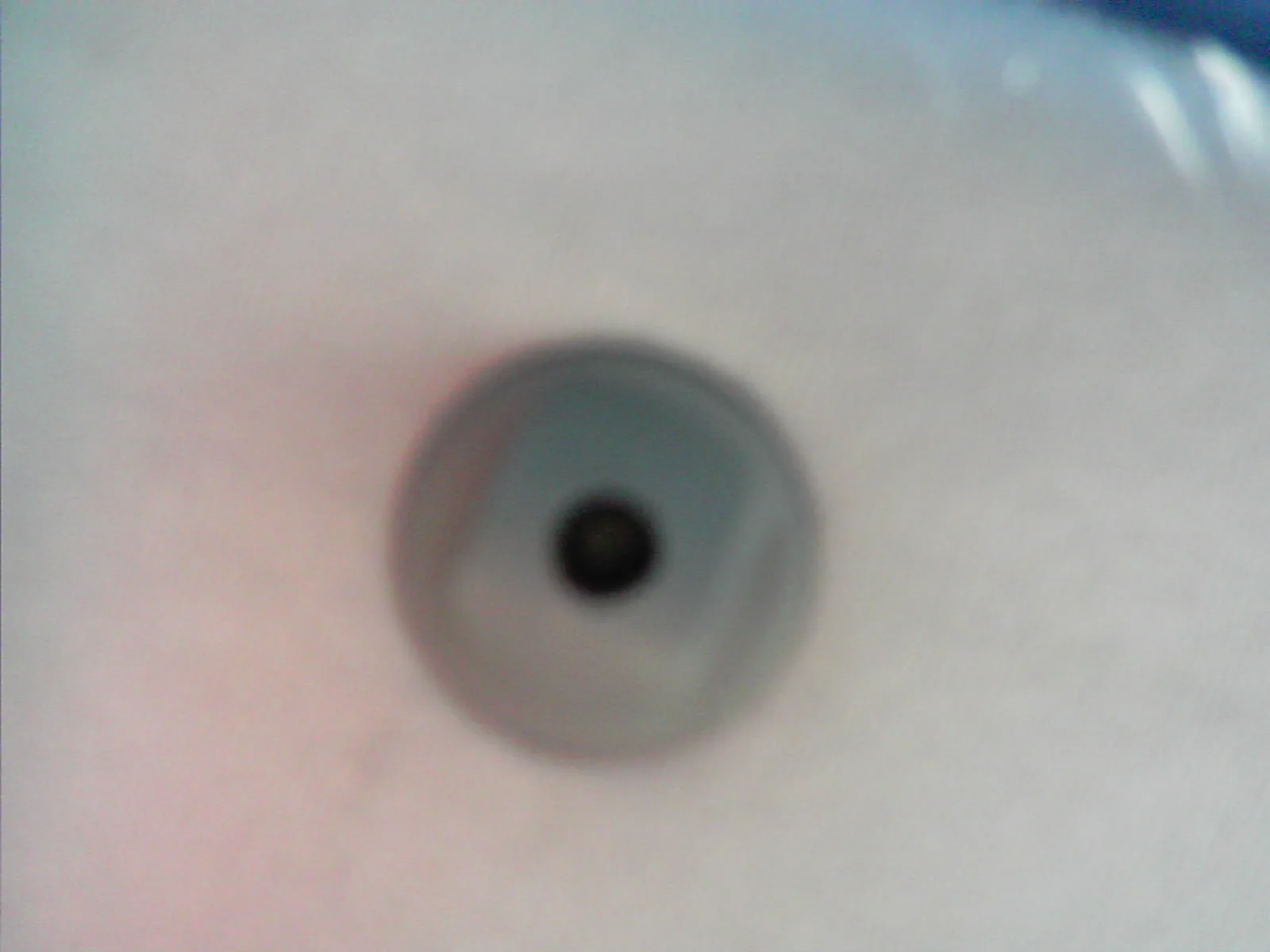

There's one screw in the things that are attached to the roof. Unsrew them and pull the part closest to the rear of the car down, so it levers. They're really easy to take out as I've done it a few times
Once you unclip the sunvisor from the holder, you'll be able to see the screw easier. They're torx screws though, so a normal screwdriver won't fit.
Took some pics to show where the screws are
