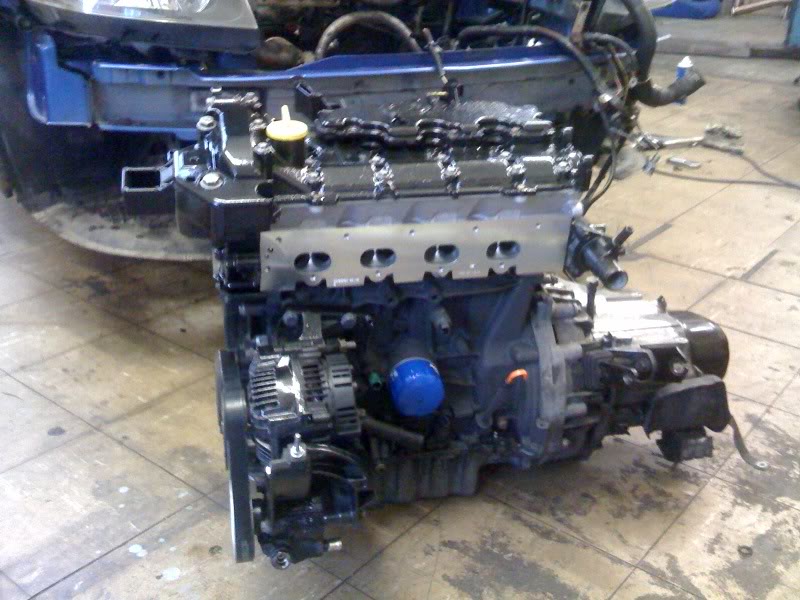

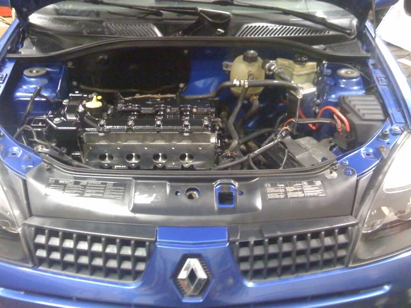

Lump is going back in tomorrow, here it is built up with box on etc.:
Should be in by early afternoon giving me sufficent time to fab my new exhaust up.
Cheers
M

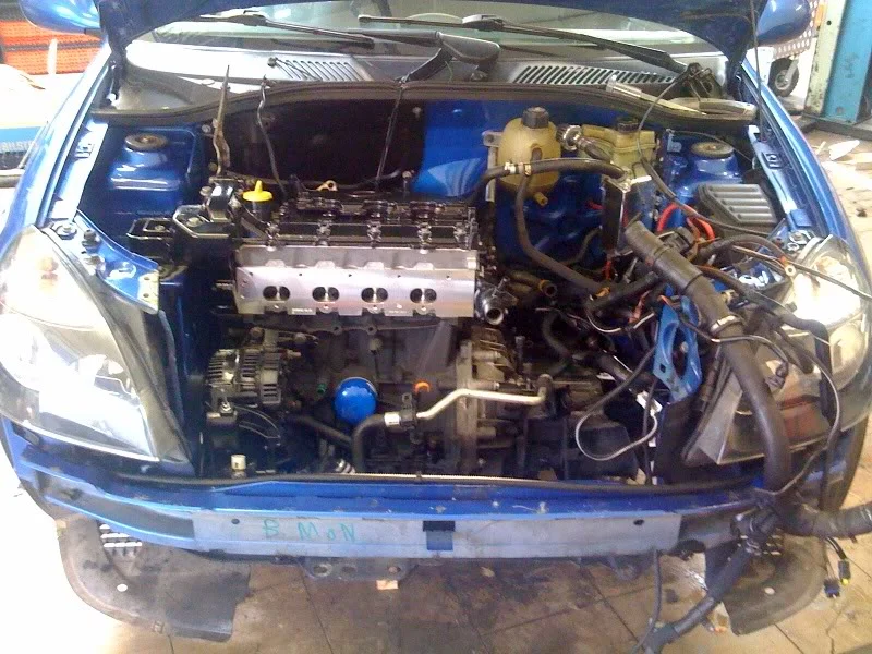

Progress from today:

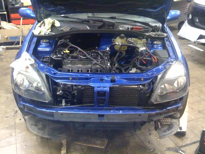

Engine in and on the mounts:
Mostly back together:
Nose back on:

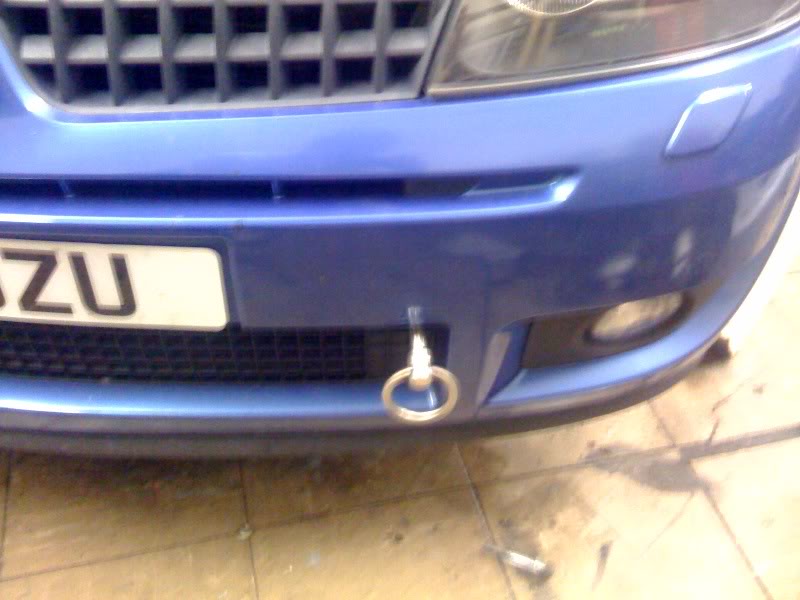

Whilst it was apart took the opportunity to weld some mounts in for a proper towing eye as well:
Need to replace TRE's and ball joints and then she's about done. Fred (the absolute superstar!!!) is sorting my wheels so it should look minty fresh by the weekend!

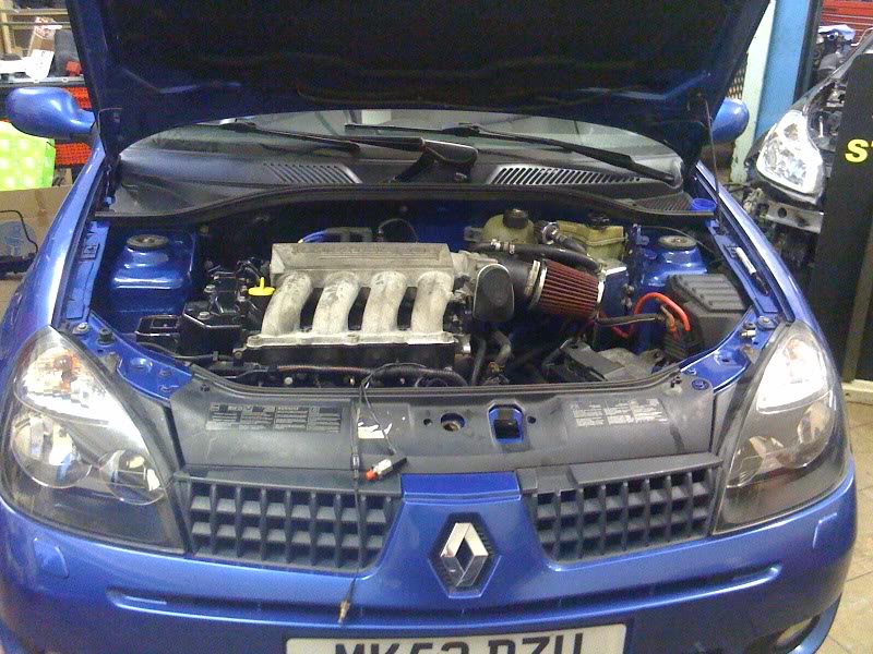

Looking at the pictures, can I conclude the inlet your working on needs a oil-catch tank / or breather set up. So no more greased up throttle body?
It doesn't need one and fully supports the standard breather setup but you can run one if you wish. I do as I dont need to meet euro emissions compliance and it avoids filling the inle manifold and throttle body full of oil mist ;-)

Currently has a standard inlet manifold on it to get a base line from. Testing will commence shortly and the next post on the subject should include all the details you've been waiting from regarding Super 2000 type manifolds, power and costs :)

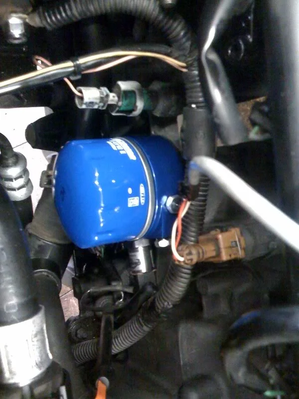

Few more pics:
Engine in and done.

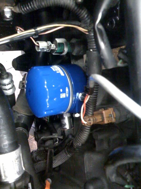

Take off plate for oil pressure/temp.

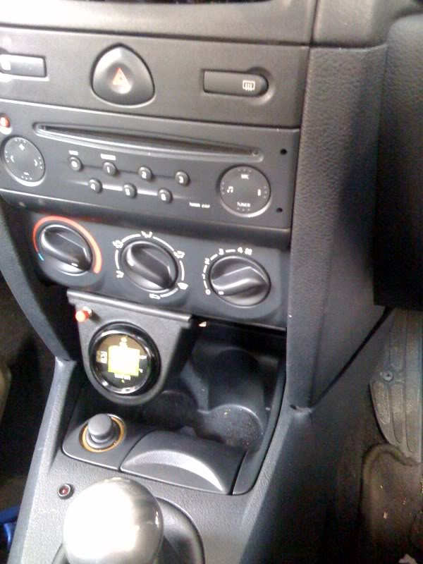

SPA Dual Gauge.
Cheers
