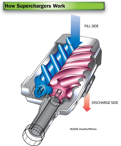

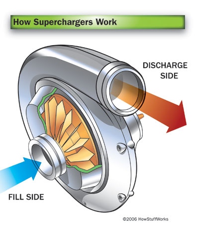

4. The Rotrex supercharger (centrifugal) is basically a turbo without the hot side, instead having a pulley. Then the cold side is basically the same as a turbo. The Eaton (Twin Screw) pulls air in from the side and twists it through two parts to compress the air and pushes it out through the bottom
