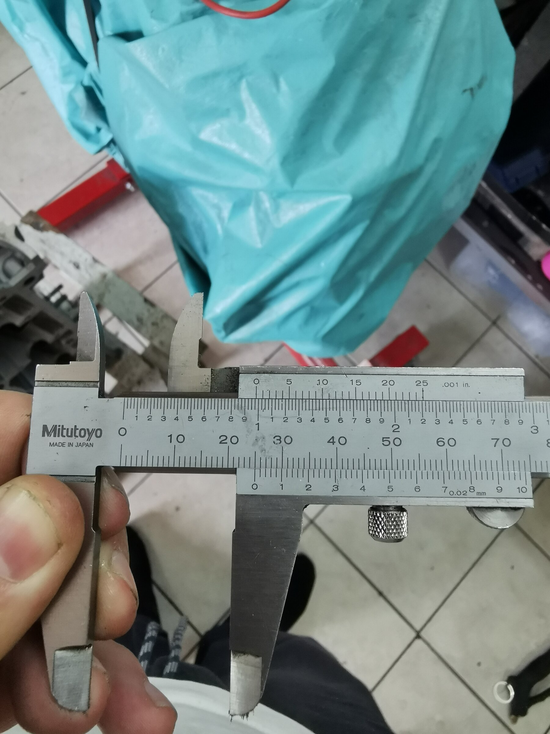

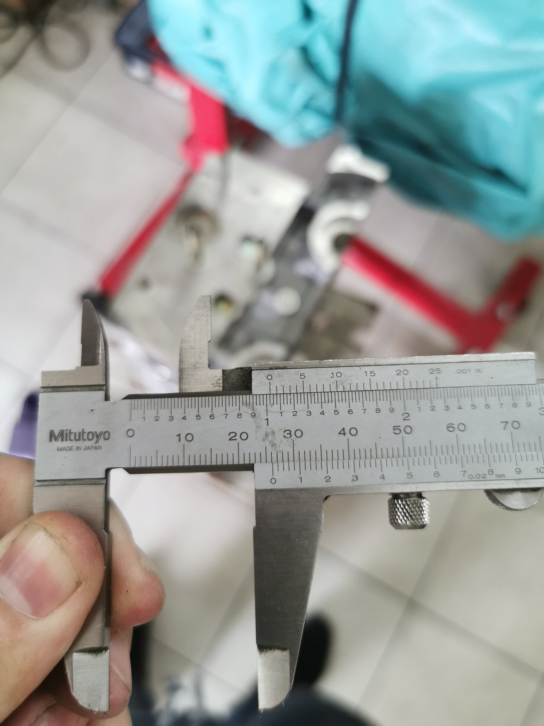

Bot the most accurate measurements, but you can have an idea.
In the first picture I measure the distance from valve guide to valve collet with supertech valve fitted in and in the other with standard valve.
There is almost 1.2mm difference between them.
I am not sure if valves were designed like this or not all f4rs engine share the same spec valves.

I did not assemble the engine, but I think I will use 1.2mm shims
