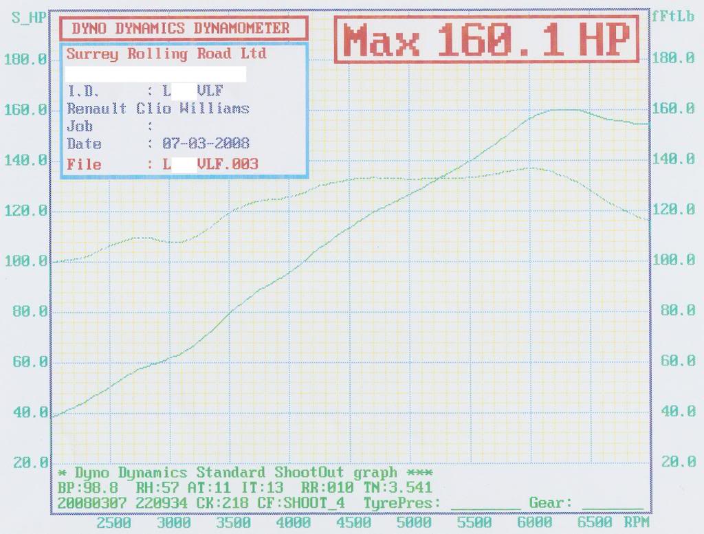

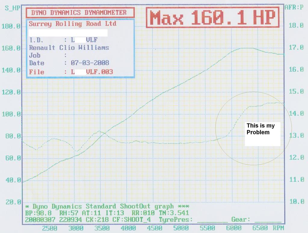

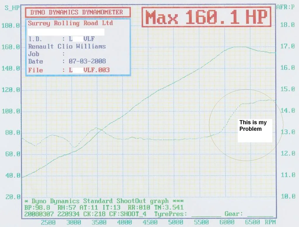

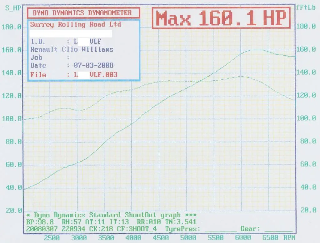

well i would say it was nice to meet everyone but i turned up at 12:30 and everyone had gone lol. Anyway car went straight on the rollers for some runs:D Not too Happy really, my age old problem of the car running lean is back to haunt me:mad: the fella done the 3 runs then said its not very well:( its running badly lean from 5500rpm untill 7.3k and as a result power is hitting a brick wall at 6k. It made 160.1 bhp @ 6.1k 138lb/ft torque. He said it was well on its way to making 175-180bhp as it was pulling very stong then just stopped at 6k. ive had this problem a few times before and have always blammed the map on the car, i now think something must be fucked lol, anyway only got 2 pics as i was pissed about what i saw on the screen:mad: oh and nice to meet dunc and debz ( wish i left as happy as dunc :) )
well i would say it was nice to meet everyone but i turned up at 12:30 and everyone had gone lol. Anyway car went straight on the rollers for some runs:D Not too Happy really, my age old problem of the car running lean is back to haunt me:mad: the fella done the 3 runs then said its not very well:( its running badly lean from 5500rpm untill 7.3k and as a result power is hitting a brick wall at 6k. It made 160.1 bhp @ 6.1k 138lb/ft torque. He said it was well on its way to making 175-180bhp as it was pulling very stong then just stopped at 6k. ive had this problem a few times before and have always blammed the map on the car, i now think something must be f**ked lol, anyway only got 2 pics as i was pissed about what i saw on the screen:mad: oh and nice to meet dunc and debz ( wish i left as happy as dunc :) )

thats a very odd AFR reading.....
fuel pipe restriction
injectors
blocked tank vent
(has it been mapped?)
map sensor broken
injectors
blocked tank vent
map sensor broken
yeah its very strange mate, ive had this problem for a while now ( must be nearly 2 years now lol ) Mods are, piper270, supersprint, mongoose,decat and hillpower stage 2 chip which is mapped to the car. it was last remapped a month ago at hillpower to sort the running lean problem which it did at the time but seems to have gone back to how it was before running lean topend. imo one of the above things you mentioned msut be fucked and the map keeps reverting back to how it was..... the fella at surry rr suggested i try get a fuel pressure gauge to see if its that causing it to run lean???

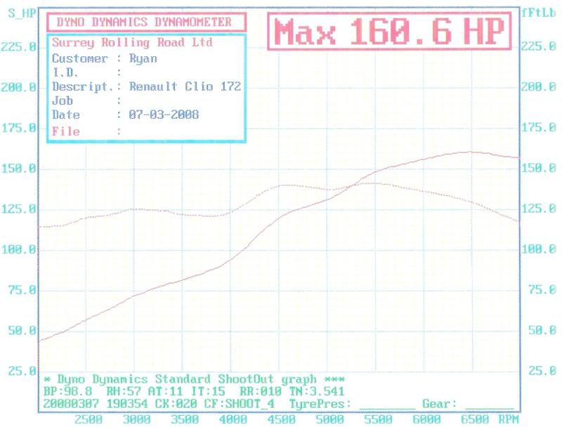

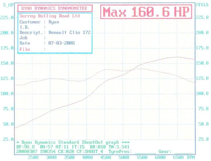

was a good day thanks saner...mine was 160.6 prospeed stealth and itg pannel filter...they were pissing about for ages with the sensor on mine and it ran from cold which i wasn't too happy with. still a pretty reasonable figure...

yup thats mine...he used it to compare a fair few against...happy with the graph..very smooth and nothing out of the ordinaray. i just think something wasn't right with the rollers when they done mine and maybe it should have been a little higher than 160....but then saying that, cookies was 162 i think and he's got an closed ik with cold air feed poping out the front grill so maybe 160 is about right..
Charlie will normally keep running the car untill he is satisfied that thats the best result he can get on that day. Mine was run 6 times just because it was cold to start with.
Closed IK with CAF and an exhaust
