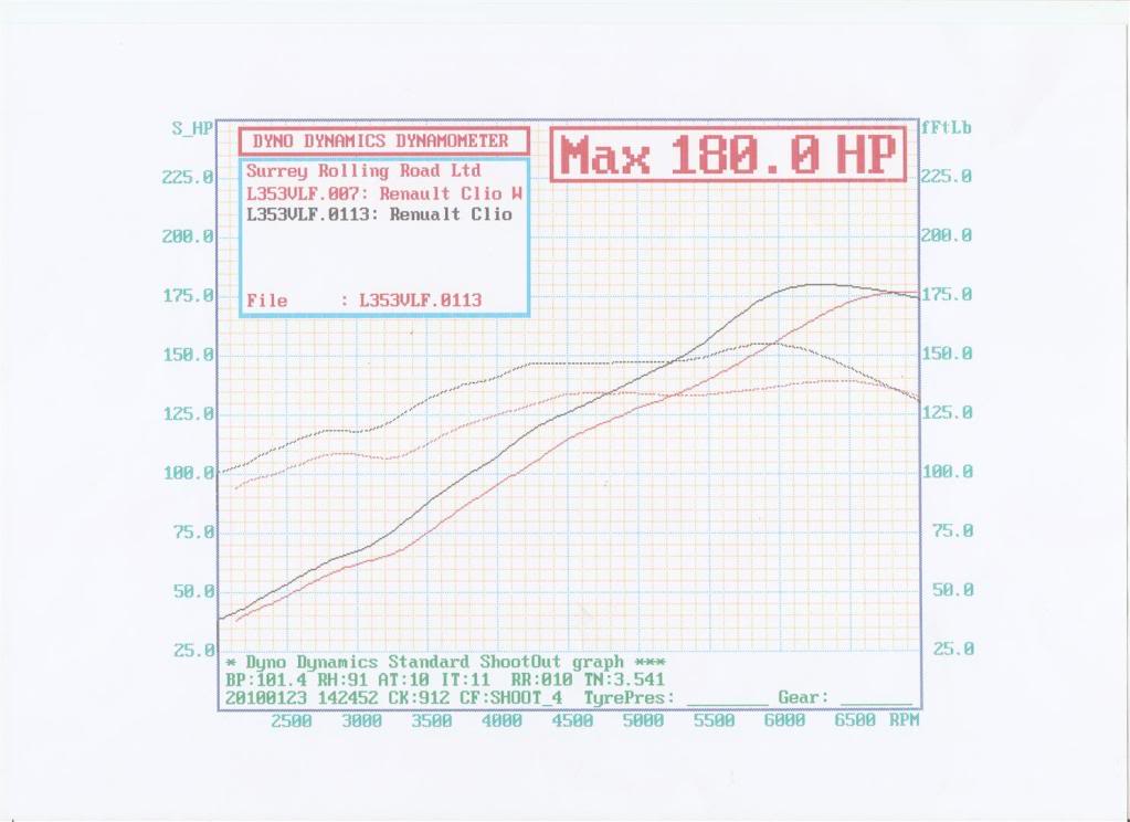

i'll start with mine although not much use to people on here being a mk1...
mods:
2.0ltr F7R
AP-Developments Headwork
Piper 285 cams
Piper vernier pulleys
Supersprint manifold
mongoose exh system with decat
std airbox with itg filter and caf
ptfe gaskets
RS Tuning live remap
180bhp 156lb/ft ( not bad for a bottom end on 145k+ and 17 years old;))

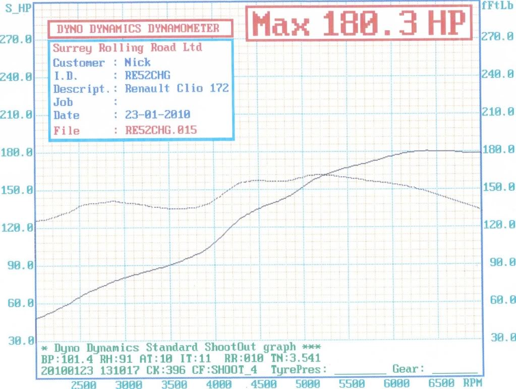

Here are mine.
Im running a k-tec stealth with a decat, matched inlets, remap and a pipercross panel filter.

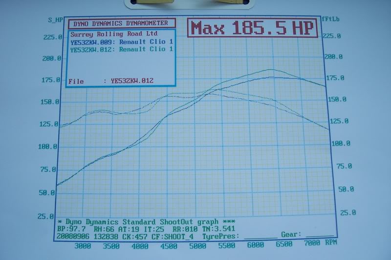

This is from a run I had done there on my 172 Cup last year, showing a before & after curve.
For the lower curve (177bhp peak) the mods were;
R-sport Group N ECU
ITG panel filter
K-tec Stealth exhaust
Yozzasport decat
Then I added a V6 airbox + ITG filter instead of the standard airbox, and took the power-steering off, giving the higher curve and a peak of 185.5 bhp.

Here's Mine,
182 with 32000 on the clock.
Current Modifications,
JMS Stage 1 - Re-map, Panel Filter, Acoustic Valve Removed.
JMS Stage 2 - Matched Inlets.
Janspeed Exhaust 2.25
K-Tech Decat

What bhp/tonne you got now then Jay?
180bhp/900kg = 203.21bhp per ton
thing is this only tells a small part of the story as i was at 177bhp before and same weight giving 199.82bhp per ton but since the headwork and new cams have been fitted ive gained alot of torque/bhp throughout the rev range, it just makes its peak 1k rpm earlier and carries through till the end. i could get the cam timing adjusted to make some impressive pub talk figures up top but would suffer down below and start to become peaky, not what i want :)

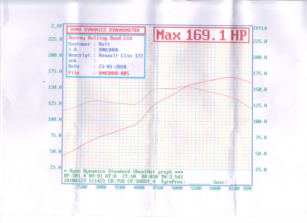

Heres mine. Ph1 172 on 72,000 standard except,
Ashely cat back exhaust (came with it, don't judge heh)
Pipercross panel filter element
95 Octane (forgot to put super in it last time I filled up)
160bhp@6500
141lf/ft@5500
Thought that was ok considering the relative standardness of it, certainly drives well.

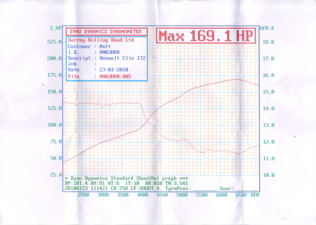

Admittedly it's not seen a dyno for re-mapping since changing the entire exhaust system. I REALLY need to finish making the 172 manifold fit that i started over a year ago.
Spider engine (F7R)
Catcam 213s and vernier pulleys
Omex 600
Williams exhaust manifold, de-cat and Janspeed mild steel cat-back
169.3bhp
137 lb/ft

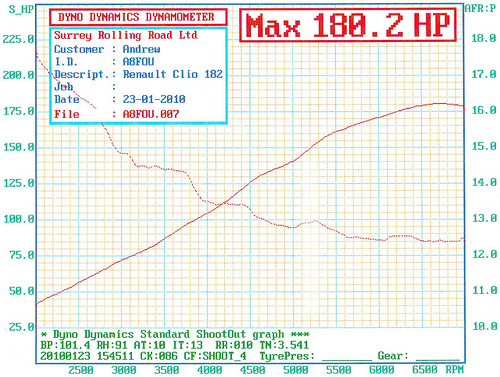

Our 182:
JMS & Fastchip Calibration
JMS Induction Setup (race filter)
JMS & APD Matched inlet manifold
Straight through silenced de-cat
A freakishly fast 182, I don't doubt that figure for a minute, I think you should let us try some bits on it see what she can really do ;)
