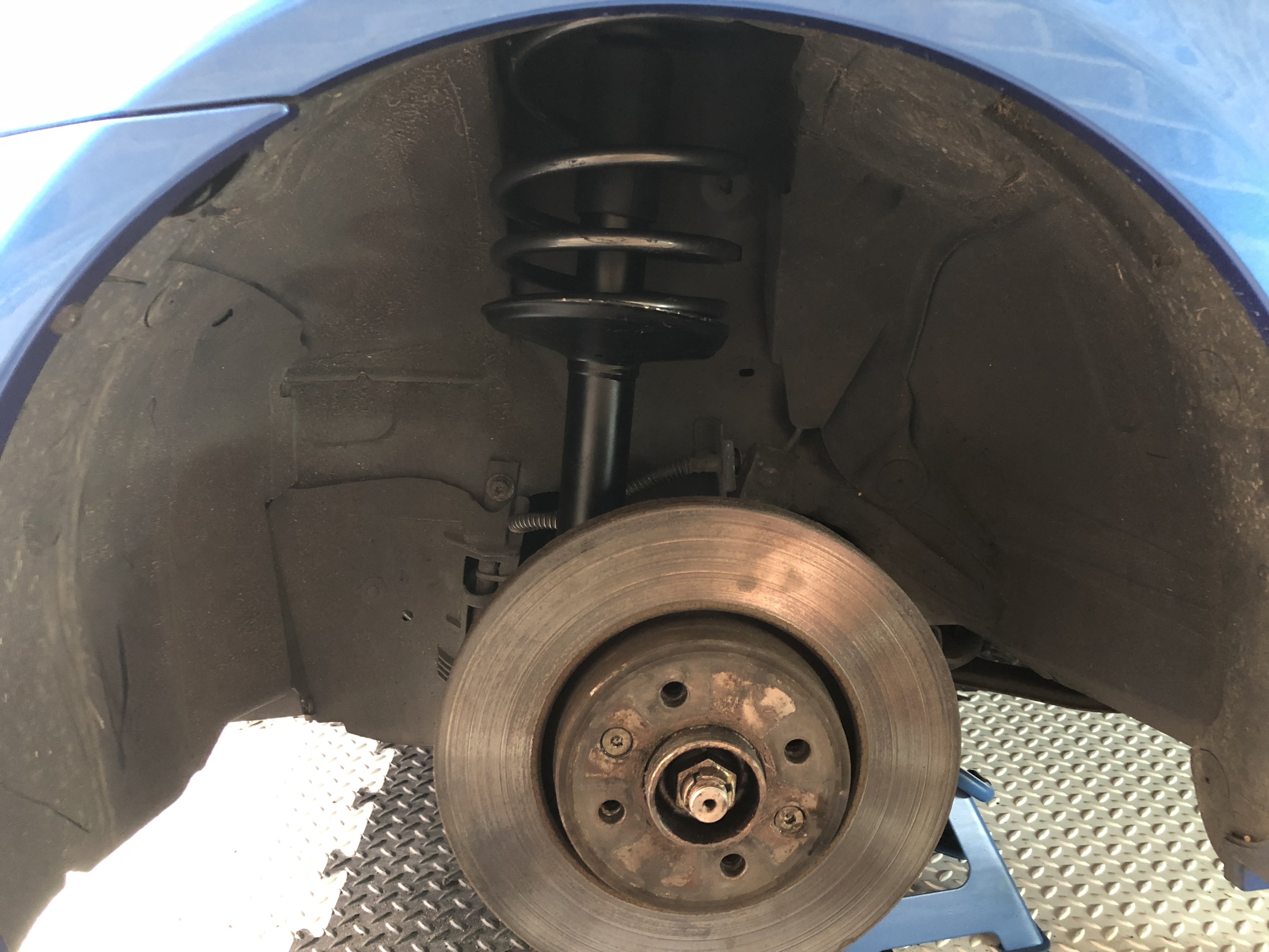

As some of you may have seen I have been getting my 172 Cup back to standard(ish) mint condition. Part of this was changing the coilovers back to 172 Cup shocks with cooksport springs.

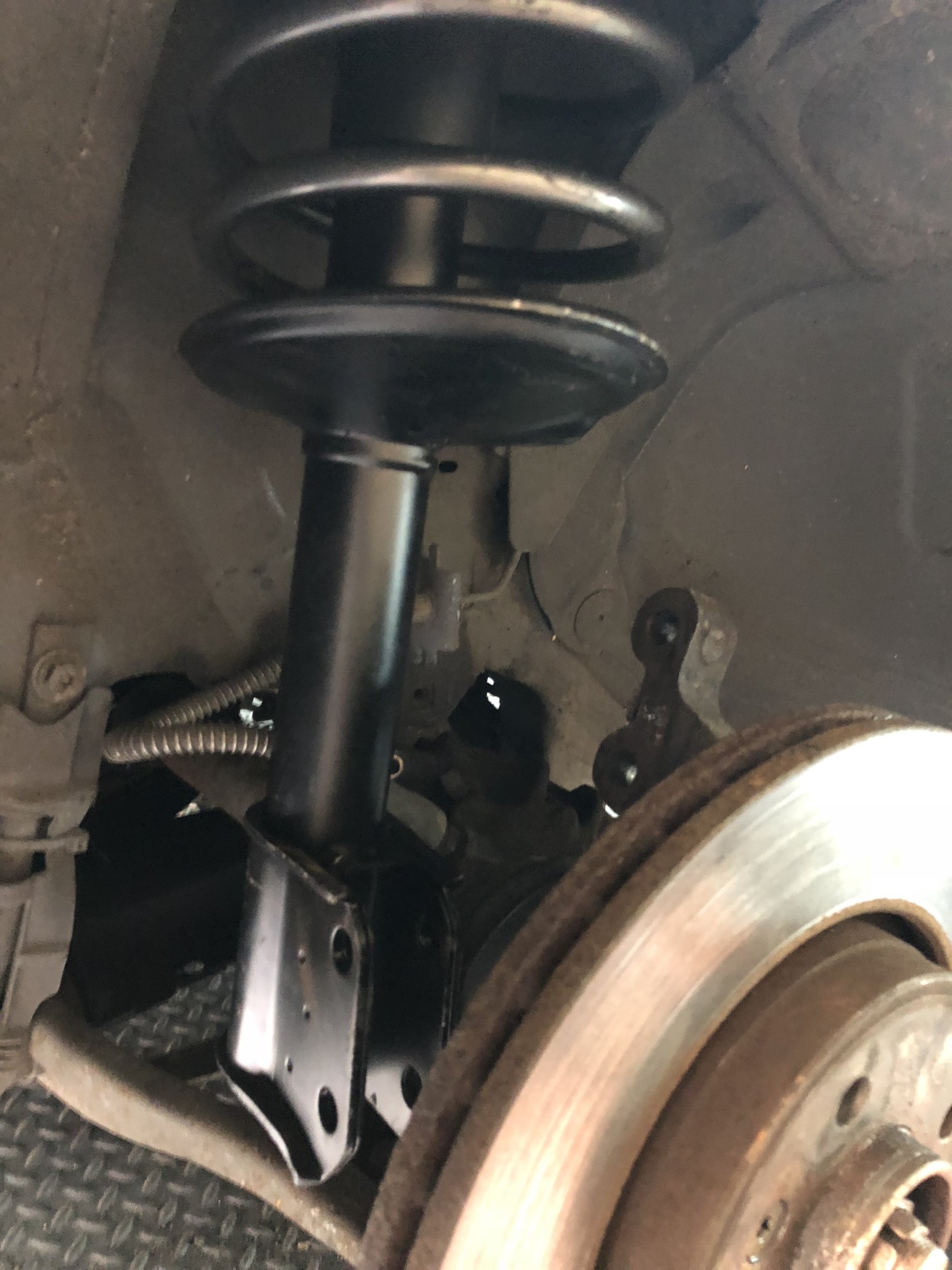

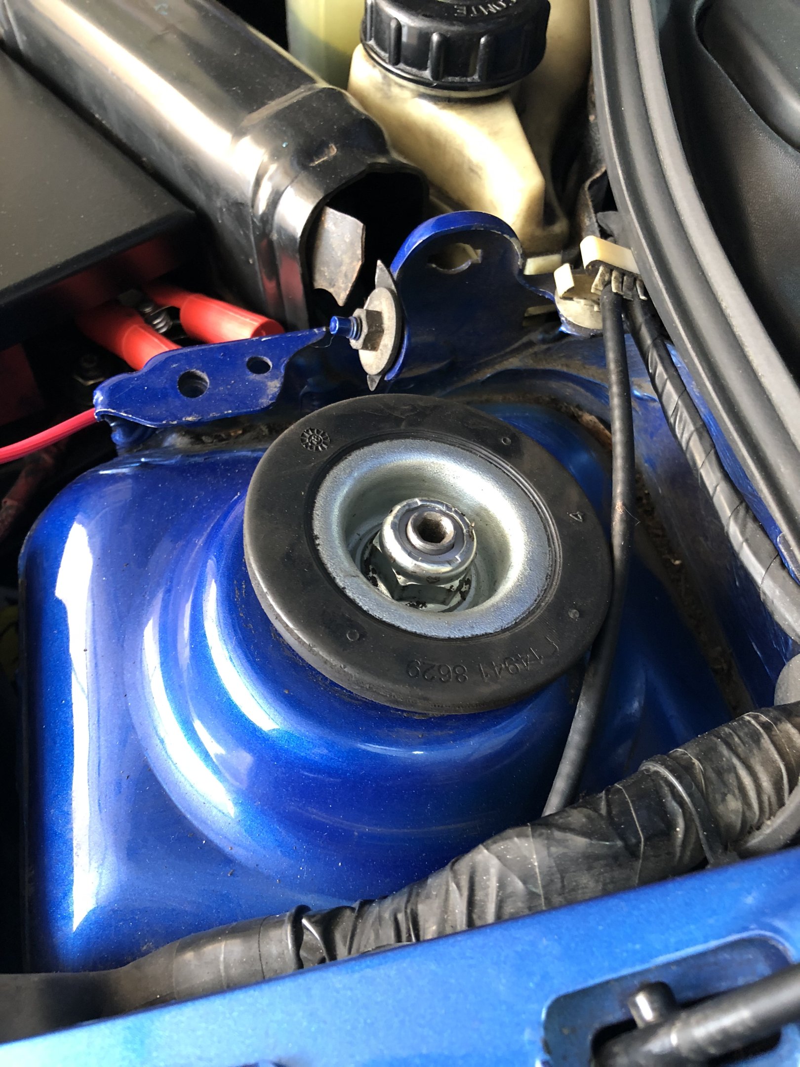

Have the car on axel stands and removed the coilovers. Have built the new suspension and the top nut is wound all the way down to where it needs to be. However it’s so much longer than the mounting points?
Am I being stupid or do I have to somehow use compressors to put it back in and if so how would I get them off after. I have watched several videos online and nobody seems to use compressors to put back in but it’s so far from the mounts.
Any help would be greatly appreciated.

Notmal, lever the track control arm down with a bar. Might be worth slackening wishbone to subframe bolts, get wheels on and drop on the floor/retorque the bolts.
DrR
  VW Golf GTD
Granted it's been a good few years since i've done it, but it's far easier with both off the ground?
JamesBryan
Oh yeah definitely much hard with one wheel on the ground, but with both off the ground you still have to push down on the lower arm a bit.
Have on all the ones i've worked on anyway.

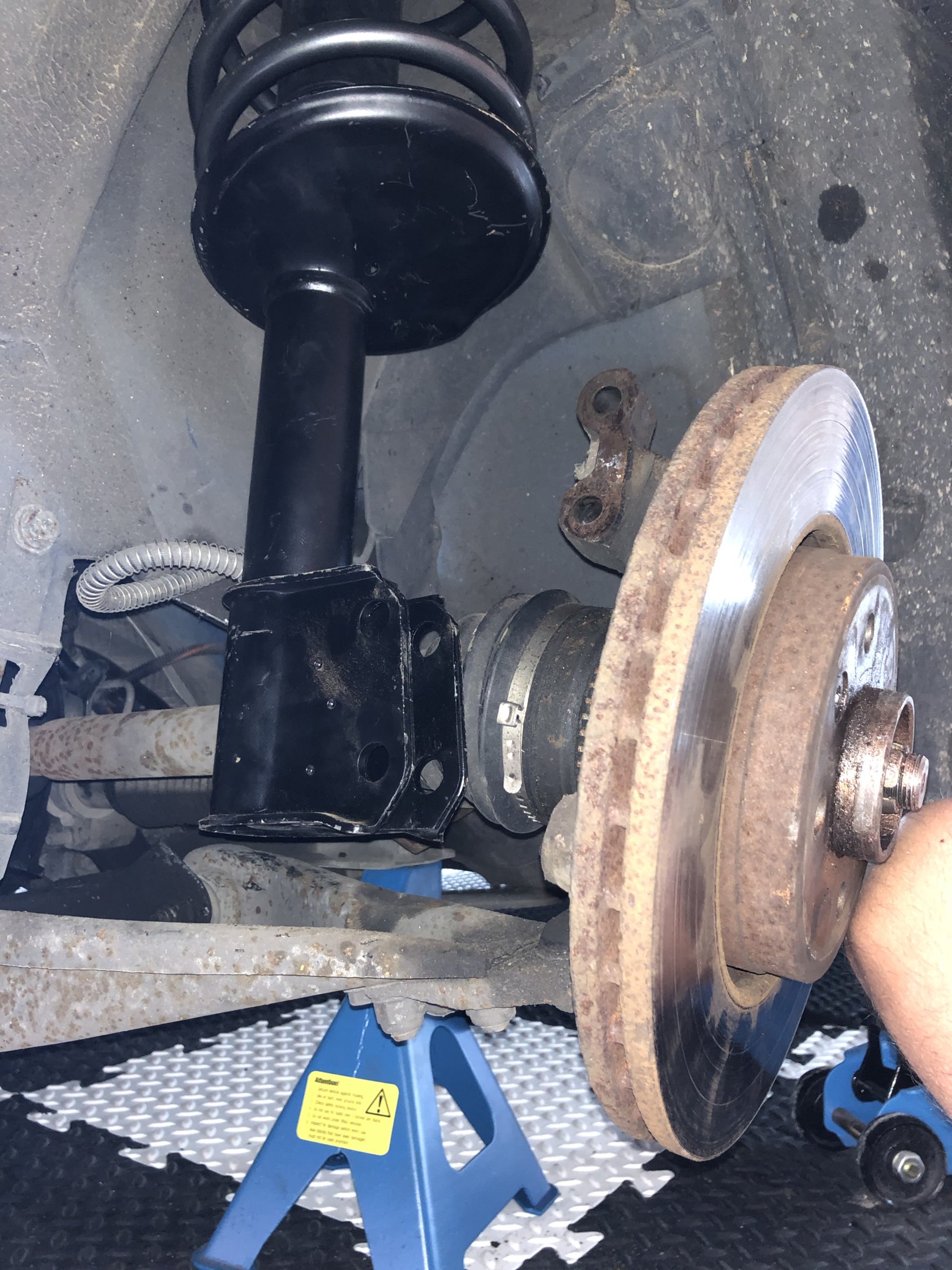

I struggled to get one of the strut bolts through because of this so managed to put a screwdriver through then got one of the bolts through
JamesBryan
Oh dear!!
Is that a simple fix for a mechanic? I will need to call someone as its wayyyyy beyond me lol.
Yeah, just needs popping back in and the gearbox oil topping up with 75w80 gear oil.
I should have warned you about it before when saying about standing on the hub to lever it down to get the bolts in.... ?
The plastic wing nut is on the front of the box, if you fancy topping it up yourself.

Got under and had a proper look and it had just literally popped out. No rips or tears etc so oil has been ordered and Alex is popping by next Saturday to reattach and fill the oil back up.
