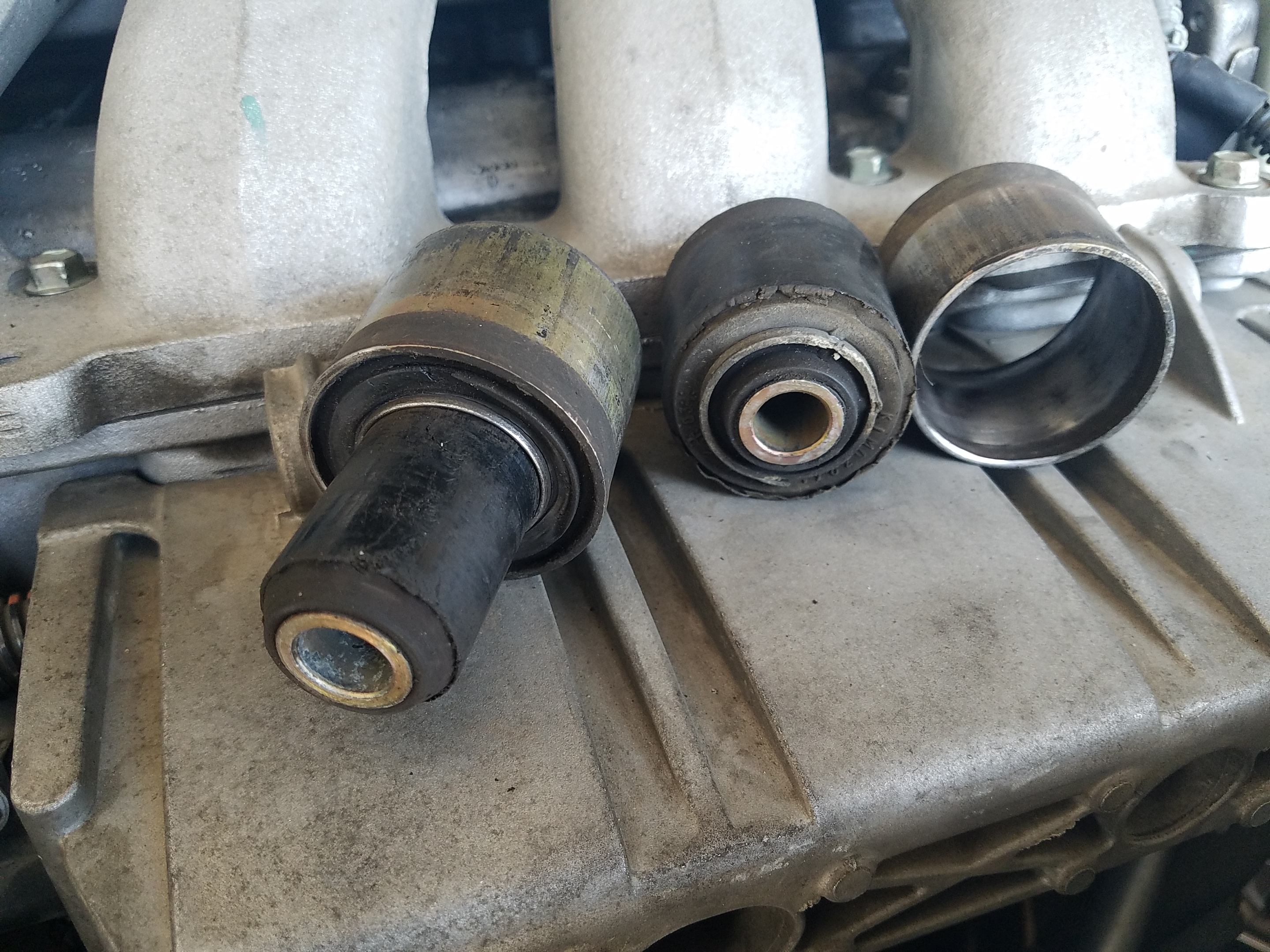

Mine was making those exact noises. I had changed the rollbar bushes a while ago, but made no difference.
It was coming from the wishbone bushes. The rubber had come unglued from the metal shell. The whole wishbone had moved forward slightly.
Came out pretty easy with a ball joint press and the right sized socket.
Replaced them with powerflex poly bushes.
View attachment 1596054Came out pretty easy with a ball joint press and the right sized socket.

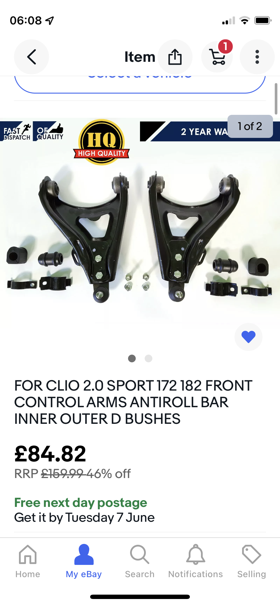

would a set of these be ok to replace or am I looking for the wrong thing? Thanks
