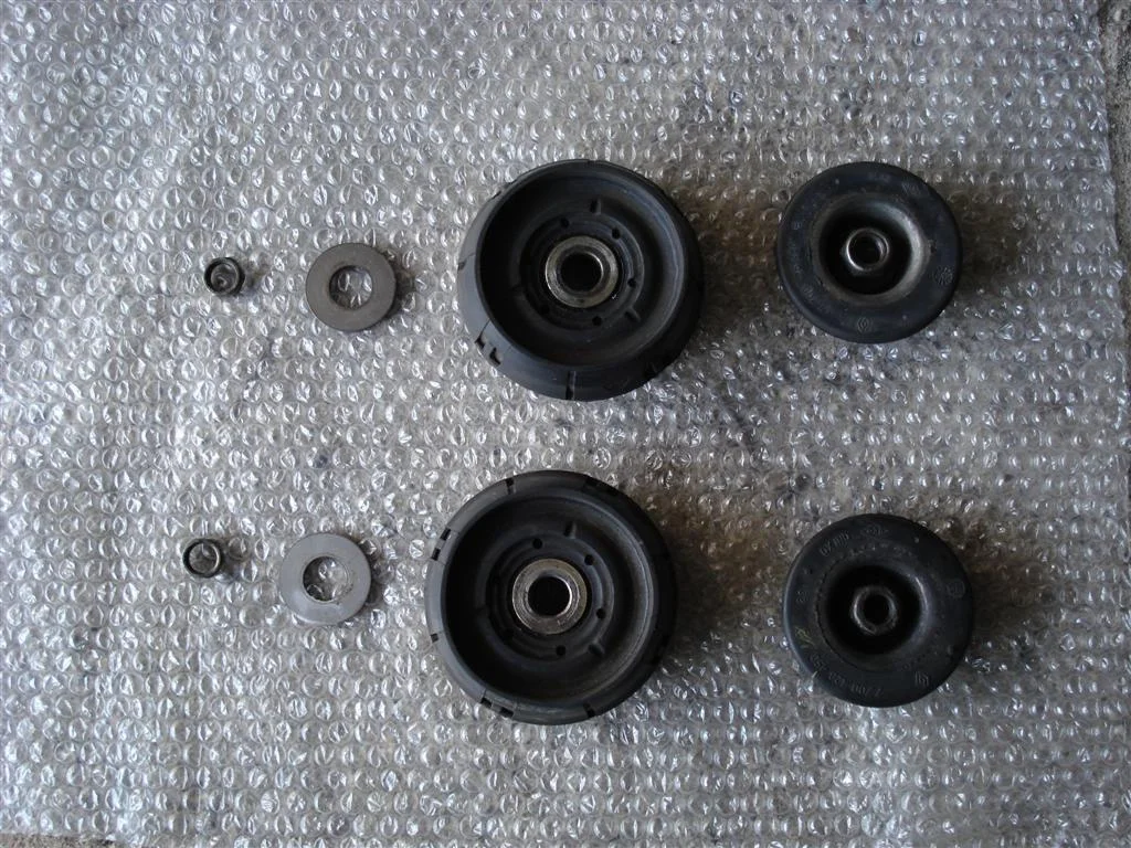

Quick way to check is to lift up your bonnet and look at the top nut in the engine bay, you know the thing that screws to the top of the shocker? When my spring popped out, that top nut was sitting lower than the other side.
Other than that, it's like you've said, jacking the car up to investigate it further.
You mean the top mounts? I know for sure it's more wobbly than it should be, didn't notice if it was sitting higher or lower though. It's funny because it's only yesterday I was telling a Renault hater that I've had no problems up to date. Looks like I've cursed myself.
I mean the nuts in the far right in the attached image. They sit right at the top of the strut inside the engine bay. When my spring popped out of the top hat, the nut in question had dropped about 10mm down and was sitting directly on the turret where as the one on the other side was sitting normally.
