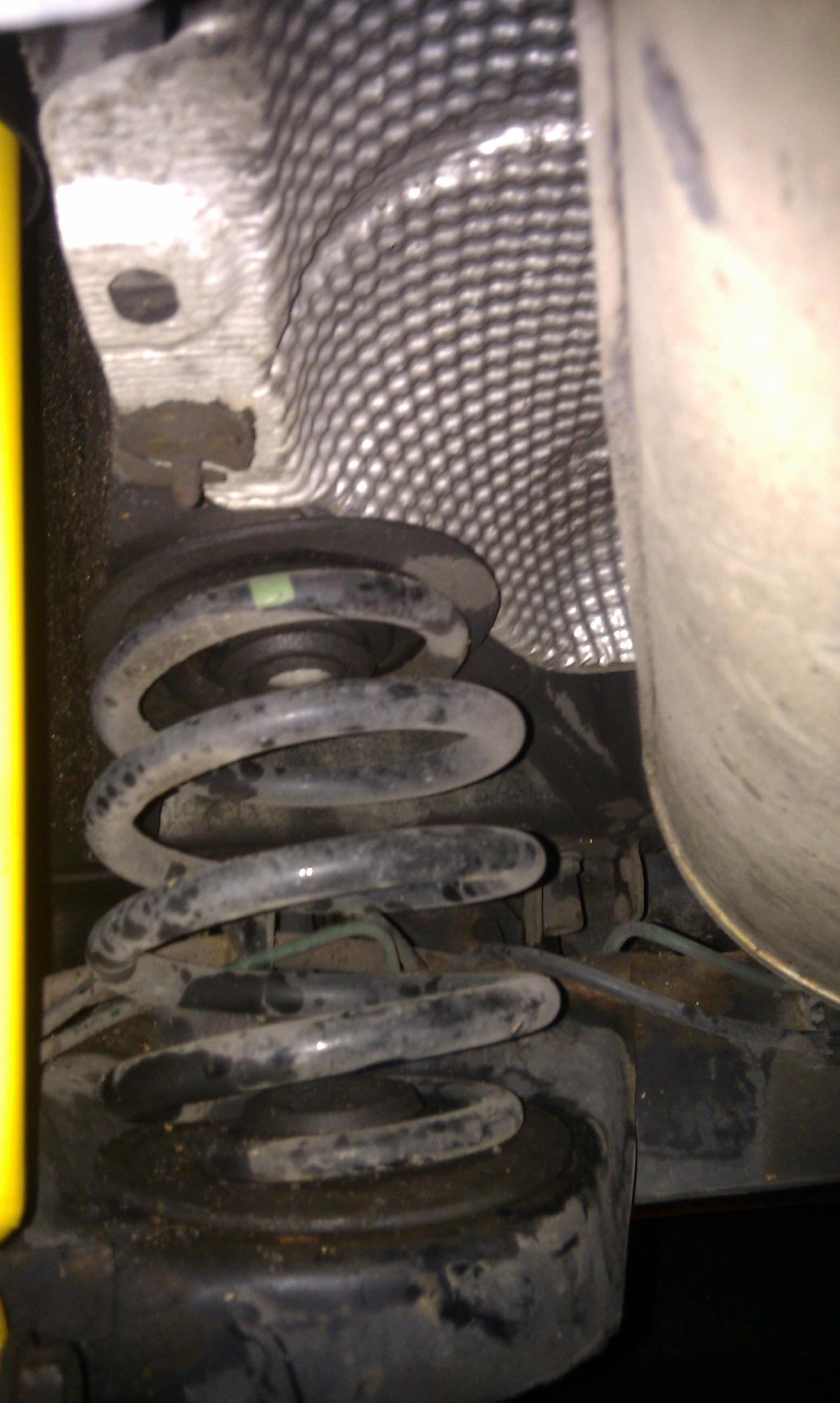

Got a 1.2 Dynamique and im fitting some vmaxx coilovers but i cant see how the rear spring comes off..can anyone help please?
Sorry for the s**tty phone pics...
yep two bolts, one either side on the inside of each wheel that holds the shock up, remove those then jack the car up and they do literally just fall out
Okay cheers ill give it a go tomorrow...think i did this but they were still pretty tight in there
