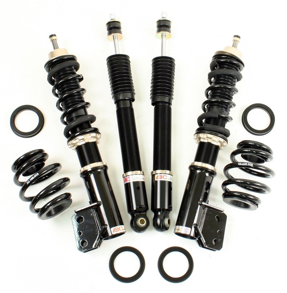

Just read this on the BC website with regards to ride height with the BC, Not sure if too low though and it'll just be the bumper/bodywork hitting the ground lol I know I don't want it silly low for track anyway.
'Because ride height is determined by an adjustable bottom mount rather than spring platform you retain full damper travel regardless of the ride height run'

If you look at your BC's, they have 2 collars under the spring. The lower one (once up against the upper one) will raise the car as the thread of the strut goes into the hub part. The upper collar with adjust the pre-load on the spring itself, then you just wind up the lower collar to lock it.
The adjusters that reach into the engine bay are damping adjusters.

Out of ignorance,I will ask what the third ring at the bottom of the front shocks is for?
If it`s to adjust the whole cartridge/spring assembly up or down for ride height adjustment then that`s neat,and I wish I had bought some of these.
  PH2 172
it's for ride height. top is for adjusting preload.
As a concept,that`s so much better than everything else out there.
Going back to OP `s problem,does the damper rod remain anchored,?allowing you to advance the threaded canister towards the bump stop?
